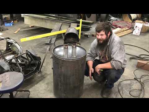

What kind of gasket do you have in the lid that can make it tight with so little pressure?
It still has the factory gasket in that lid, thats what im using on the toyota as well with a smear coat of grease it seals up pretty good and doesnt stick down to the hopper so it puffs easily when it needs to
