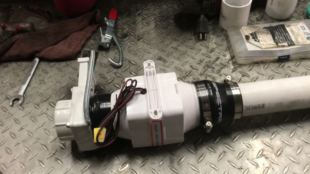

holy crapola getting those 2" pvc lines into the engine bay with the slingshot filters and mixing valves is a nightmare! I have been at it for close to 4 hours and haven’t built anything, just test fit no that wont work cant get to spark plugs. Tear apart rebuild, nope wont work way to close to the exhaust manifold tear it out rebuild, nope cant get to the break master cylinder, tear it out rebuild nope to close to the steering shaft tear it out rebuild nope cant get the drain cap off the slingshot. Man o man did I have it easy on the toyota with no inner fender wells in the way
Might want to put the slingshot further back/down.
