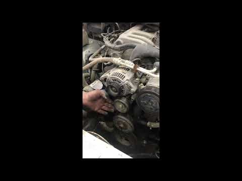

Had a interesting failure on the Dodge, something that I think would be very good information for anyone woodgassing a v10 in this video

Good information Marcus. I have a 2000 3/4 ton Dodge with a 360. a few years back the straps on the fuel tank rusted out and the tank dropped far enough to put pressure on the inlet of the fuel pump and cracked it. I tried to seal it with JB weld. No go. replaced the fuel pump and while I was at it replaced the injectors just because. Turned on the pump. 50 pounds at the fuel rail. Would not even burp. Check the fuel pump relay it was fine. That’s as far as my knowledge of those electronic wonders went. Never got it to run and since it was just a plow truck and I could live without it, it got parked and still sits. No idea what was wrong or how to find out how to fix it despite hours of reading forums on-line. I’ll see if it could have something to do with that cam sensor.
Marcus and Tom.
Dodges feed to the common voltage sensors groups; out from different regulated voltages pins from the PCM.
A short to ground anywhere on the common voltage feed line will down the function on all of the common voltage grouped sensors.
Lose cam sensor output . . . real common to go underneath and find a transmission sensor harness been installation in/out, pinched/crushed. Real common to find a transmission harness had not been properly hung back up, safe. Then droop slack, stick damaged. Or even drive line worn through.
Marcus someone in the past had shaved back the lead insulation to clip testing leads. Yeah. Gotta’ just love hackers without the decency to re-seal their “work”.
That’s a very knowledgeable speculation Steve, didn’t even cross my mind. When I was deep automotive and early days of the 6.0 power stroke with speed bump/pot hole killed ficm (fuel injection control module) I would all the time find wire probe pierced then corroded to faulty connection all across the ficm harness as that was ford’s Instruction for testing before big dollars replacements. Even I early on not knowing better would toby tape over my puncture holes, to then later liquid electrical tape. Now I avoid pokey-poke at all cost having spent countless hours repairing damaged wires. Paper clip in the back of a connector :+1:
