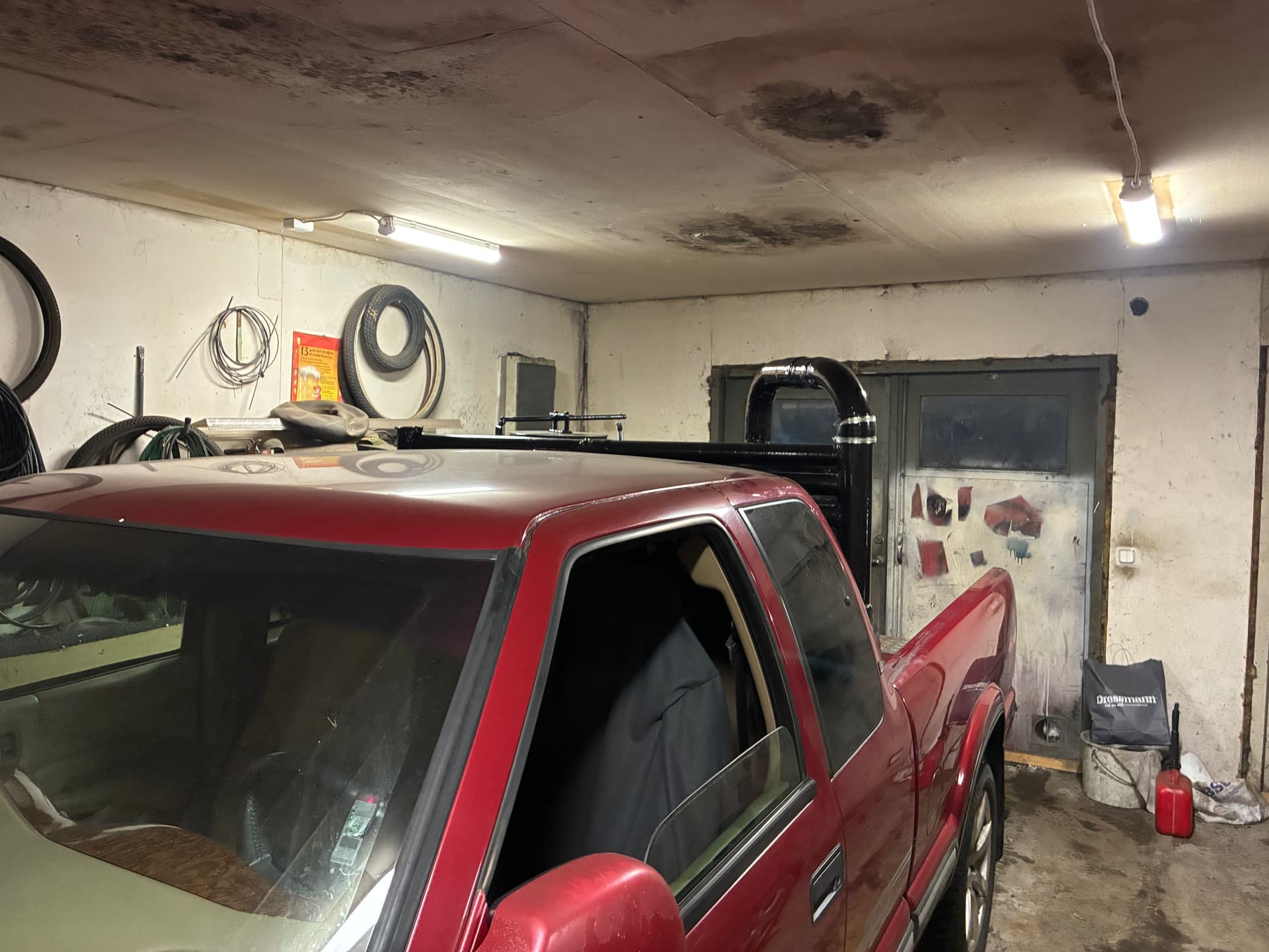

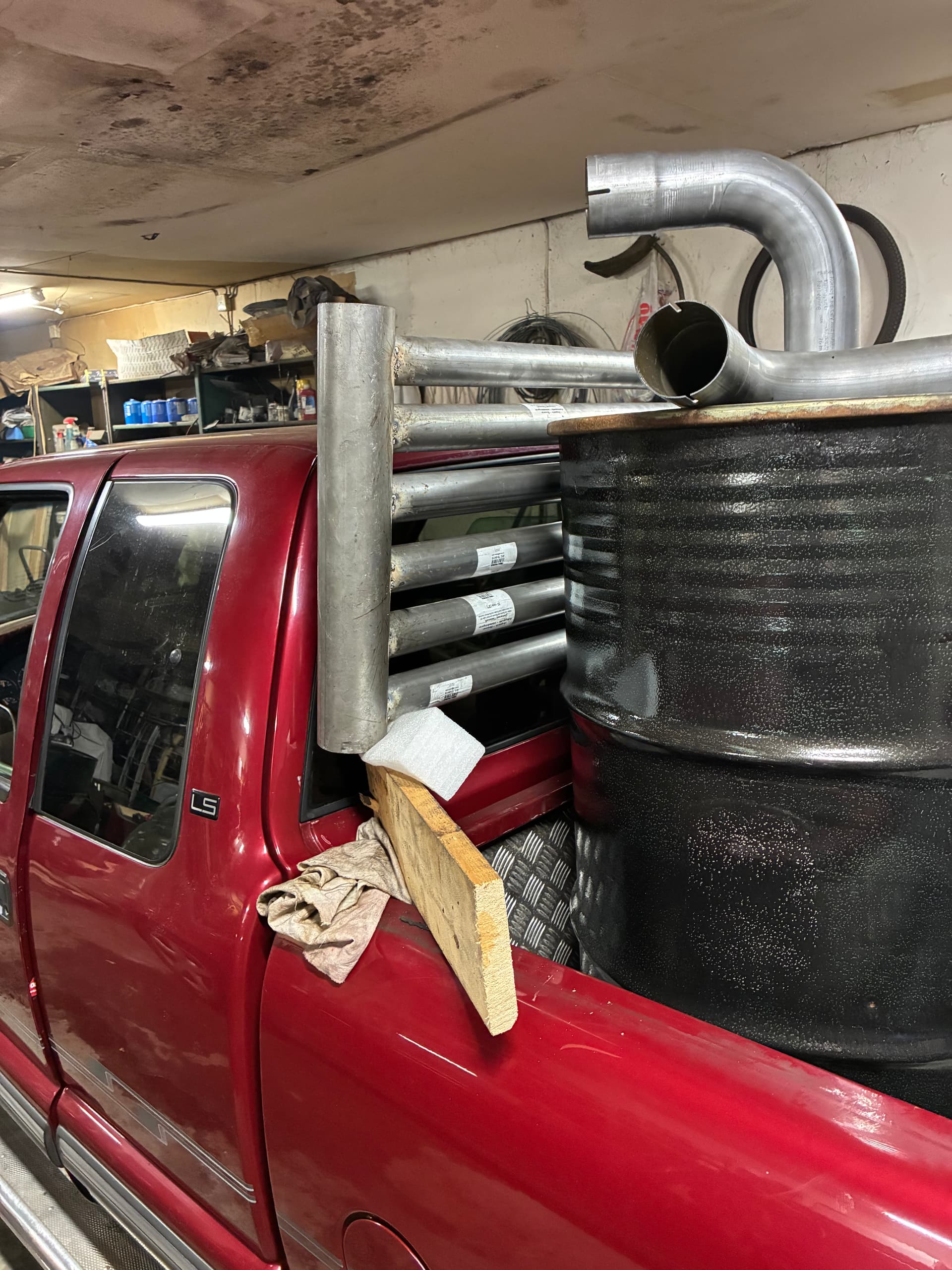

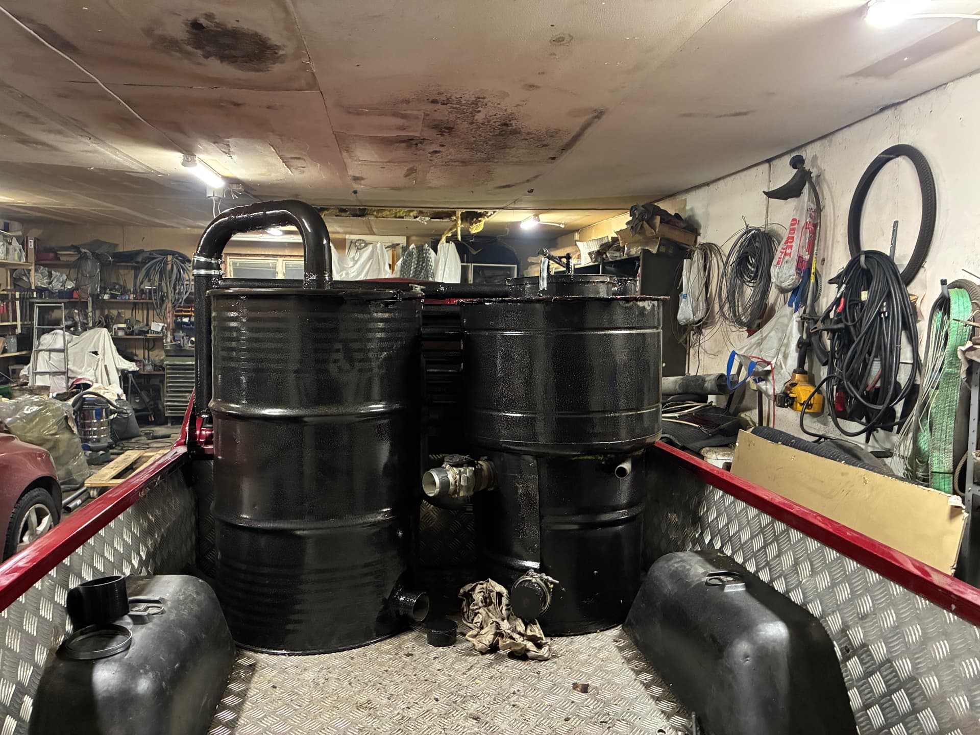

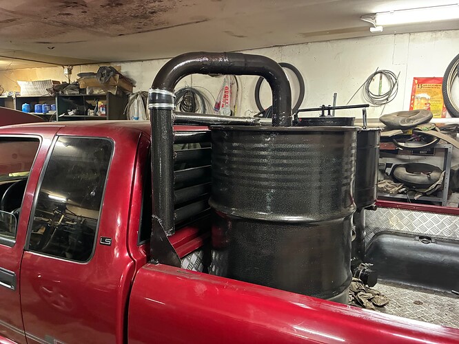

On this topic you picture up well how you have rust you must deal with. And what you’ve done.
On others of your topics you showed accumulated intake soot deposits.
Considered normal for WK builders/users. You however decided to go like other European fellows have with a hot fine screened pleated filter. A choice.
And on at least two of your topics you picture up show your in-use upper hopper conditions.
Black gooey and dripping is normal for a raw wood gasifer.
But I’ve tried to help neat-freaks with woodgasifiaction and they could never accept, black and gooey in the upper end as normal. Actually desirable; showing heat refining out of for removal of the long chain creosotes. The surface build ups then actually acting as a steel metal preserver from the acid conditions.
Ha! neat-freaks I’ve known could never accept the “baby diapers” mess of a working woodgasifer. Expecting the clean, clean conditions of using refined, filtered and dewatered natural gas or liquid petroleum gas. I’ve wondered?? Do they have children? Or just have the woman handle that end of keeping a baby clean and smelling nice?
And your systems show it does not have to be all pretty shiny SS to have a useable working gasifier.
