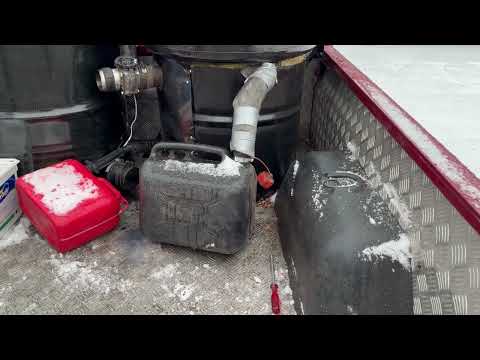

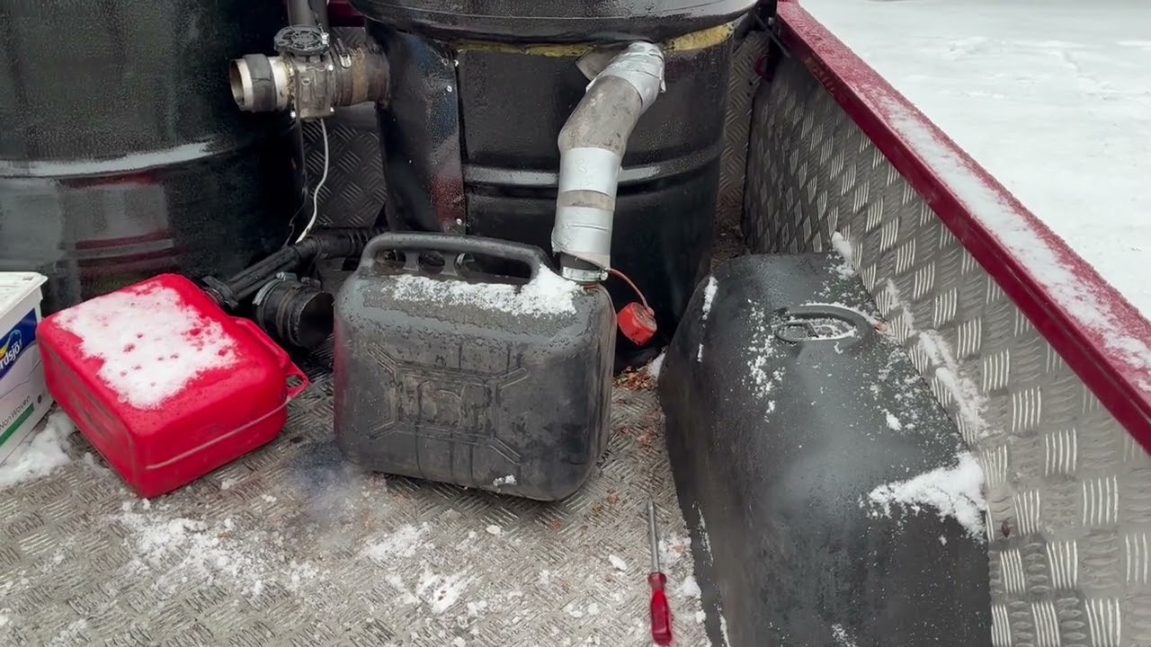

I was thinking of putting a joint on the elbow into the radiator, and I should be able to access it to flush it out if necessary, but usually nothing happens in the radiators if the filter is working, but otherwise I should be able to drill holes in the standing pipe and insert those plugs.
Yes, of course. I keep forgetting you filter before cooling :exploding_head:
What do you think, should I try to get the pipe from the filter to the radiator down or leave it as is?
It will be a bit strange with the bend at the radiator if I cut it more, and I want the joint there to do cleaning if necessary.
If your wife is going to drive this, I suspect you need to drop the pipe down for better aerodynamics. I suppose you could put a teardrop shape on the pipe for more aerodynamics as well.
Otherwise, I don’t think you can get it below the cab height without knocking several inches off the top of the barrel without making it so the air comes out the side of the barrel. (which you aren’t going to do.)
At best you might be able to get 4" from just shortening the pipe.
The only real concern I would have is Branches catching on the pipe and yanking it off.
You could also add fins on it, since it would help cooling with all the airflow.
Leave as is JanA.
If you tape lengths of yarn all over the gasifer, cooling rack and bed edges you will see at any speed the low pressure created behind the cab and now the gasifer pulls the air flow forwards.
You asked about a flow shaping wing at the rear cab edge.
Yes. I think it will be beneficial.
But not to try and force the air flow down; that will always be wanting to flow up.
But a raised gapped wing to actually increase the rear of cab flow upwards and then underside of wing smooth it towards a backwards flow.
This will increase the air flow past your tight in cooling rack.
Always verify this with the yarn strings. You following beside in another vehicle looking.

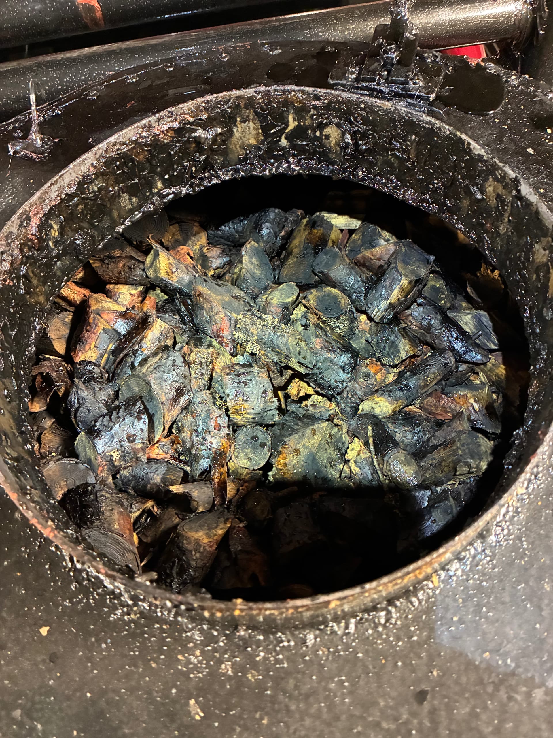

ok, I tested it again this afternoon, worked for about 10km then stopped working.
I’ll take it out tomorrow if I have time, I’m not getting any water from the hopper, so I’m wondering if it’s the water that’s turning off the unit.
Jan, I would like to help you with some “smart” advice, but I don’t have any. JO, he said it well, …

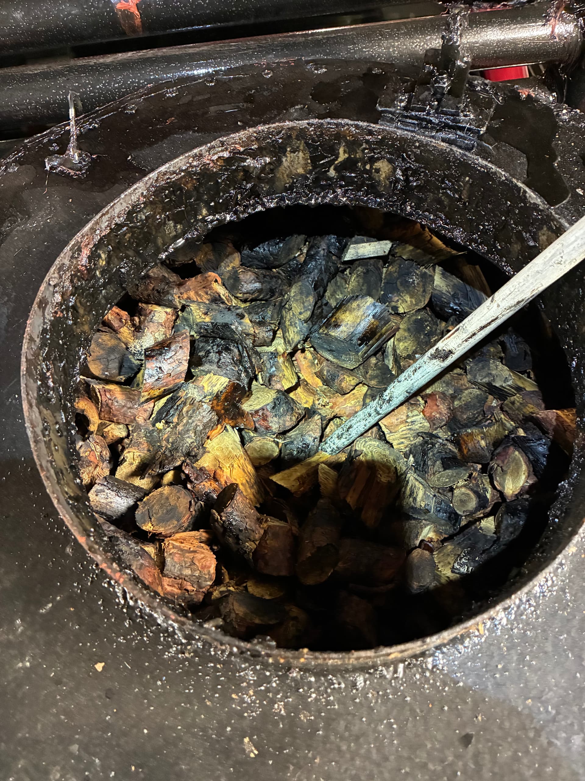

I’ll think out loud, let’s say you have a hot zone full of charcoal, which is activated when the engine starts sucking gas, and fresh air supplies oxygen and burns the charcoal, the gas flow is downwards and a little heat radiates upwards and so not enough charcoal is produced. After a while of such operation, the charcoal is used up, and the wood creates a bridge.
Try to “feel” with a stick what the condition is below, when I check it with my gasifier, I can feel a softer area below, …
Jan, I have had what you are talking about happen when driving on wood except it is my dropbox and cooling rails get hot. I filter after my gases are cooled down. Everthing will be running really great, then a loss of power. I will see my hopper temperature is normal temperature, but I will notice my grate temperature is a little higher then it was, the drop box too. I will pull over and check my wood in the hopper, looks good. I poke the wood and then it happens, it claps, the old bridging of the wood got me again. Some times by the time I get pulled over it will claps. Not good wood gases being produced now, so when this happens I will have already switched over to gasoline when I am going to check my hopper to cool things down a little. But I leave my woodgas valves open so the new wood in the fire tube that fell will cook down to charcoal. I will drive this way for a few miles and then try to switch back to driving on wood. If I am close to home I will just driving on gasoline all the way back home. I am not a purist when it comes to DOW.
I have been thinking of moving my grate shaker up to my hopper barrel to give it some good good vibration once in a while when driving. I no longer need to use my grate shaker anymore, now that I have my T handle grate shaker or I just poke the charbed real good before I light it up if it needs it with my poke rod.

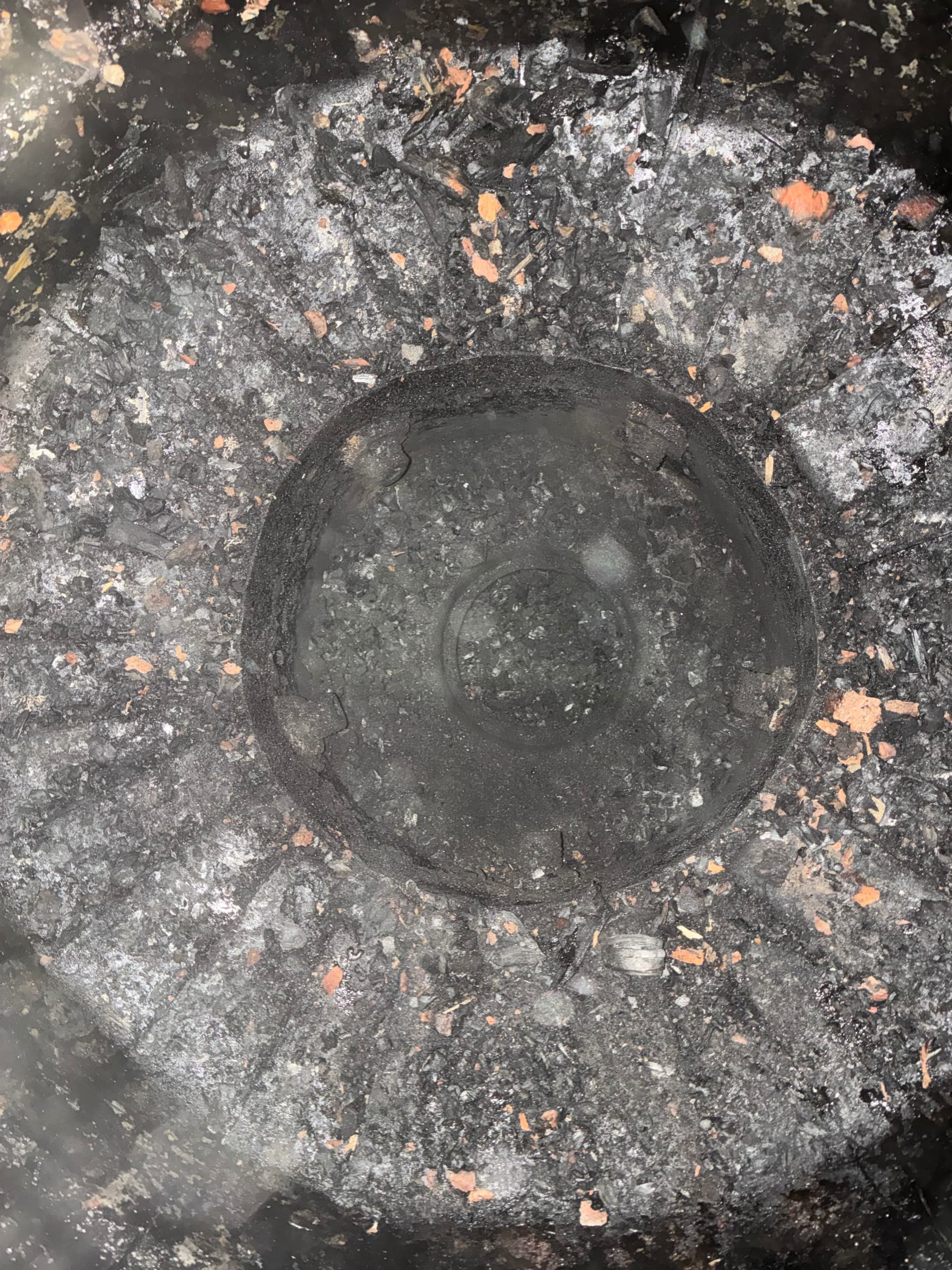

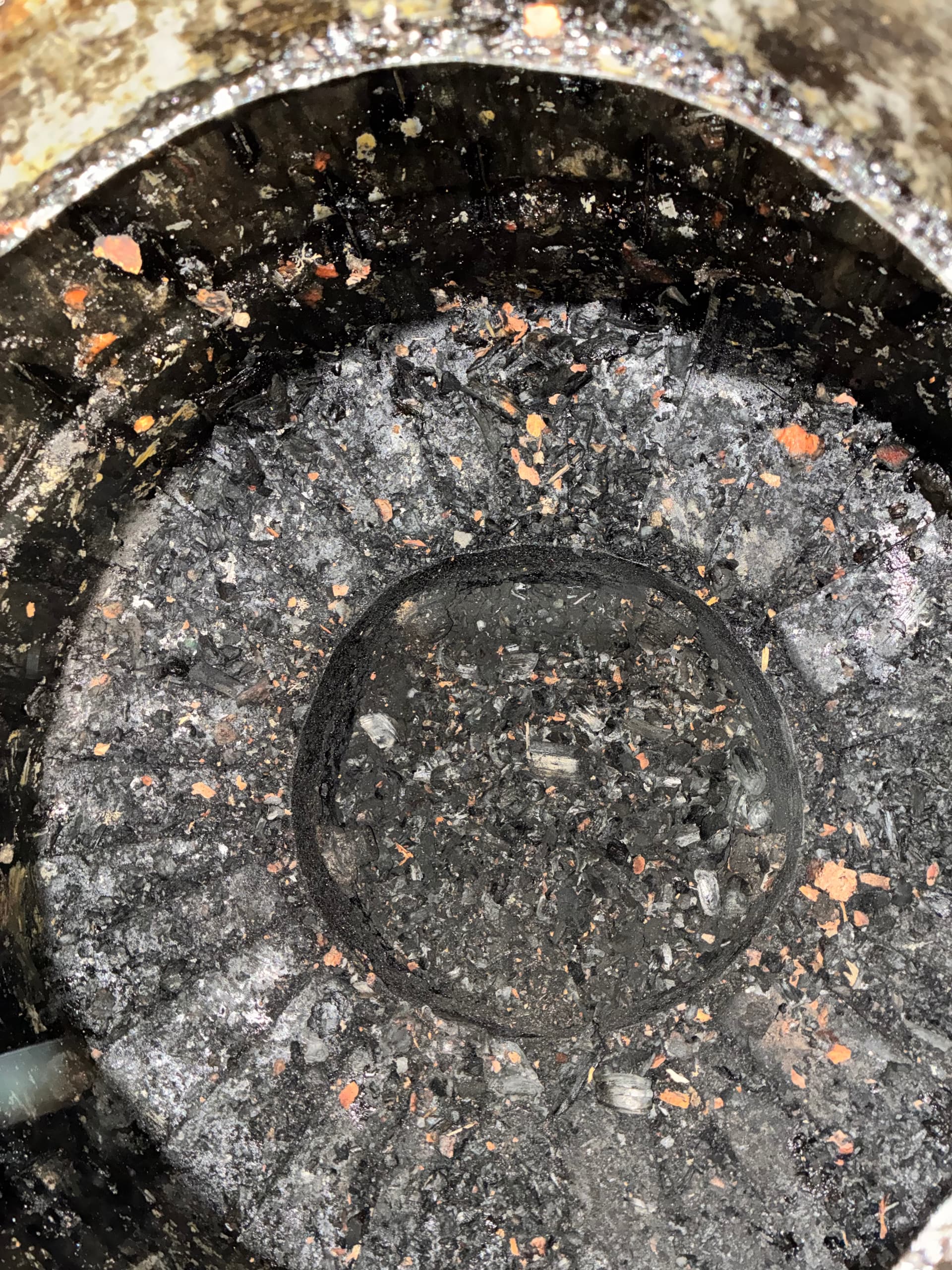

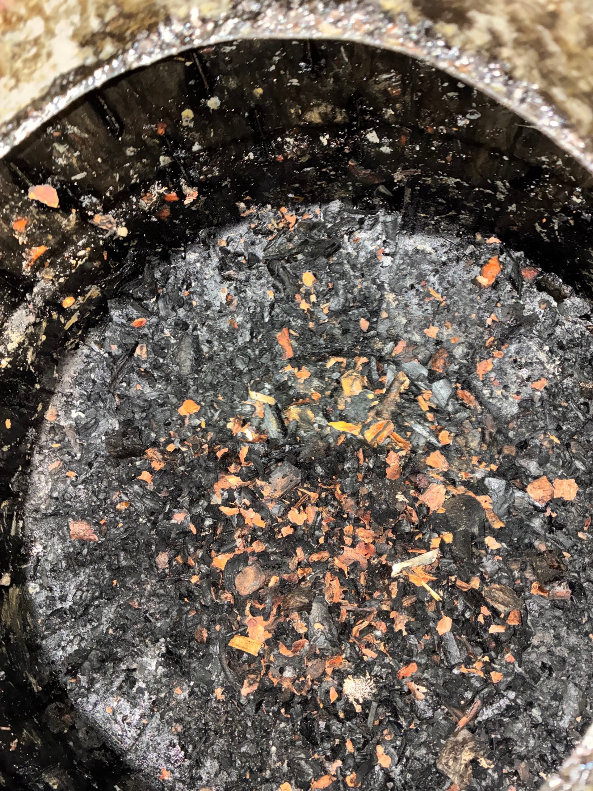

I checked the first time it happened, saw no signs of hanging, saw nothing now when I emptied it either.
But I think there was a lot of fine carbon above the grate, wondering if it was tight.
Could have to do with me running all the water through the hearth, the outlet from the hopper was set too high up from the bottom.
