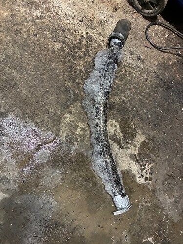

Wondering if the problem is the hopper, I can get very little water out of it, probably because it’s so small and hidden behind the cab and behind the radiators.
I know with the old one when the outlet gets clogged it runs poorly?

Do you get a lot of water out of a full hopper, JO?
It depends on what kind of driving. A full hopper of wood, 60-80 km, may produce 2 liters with a few condensing rest stops. Longer trips, when wood is consumed in one go and everything is warmed up, produce slightly less.
