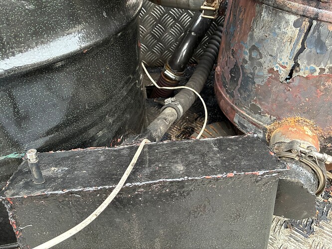

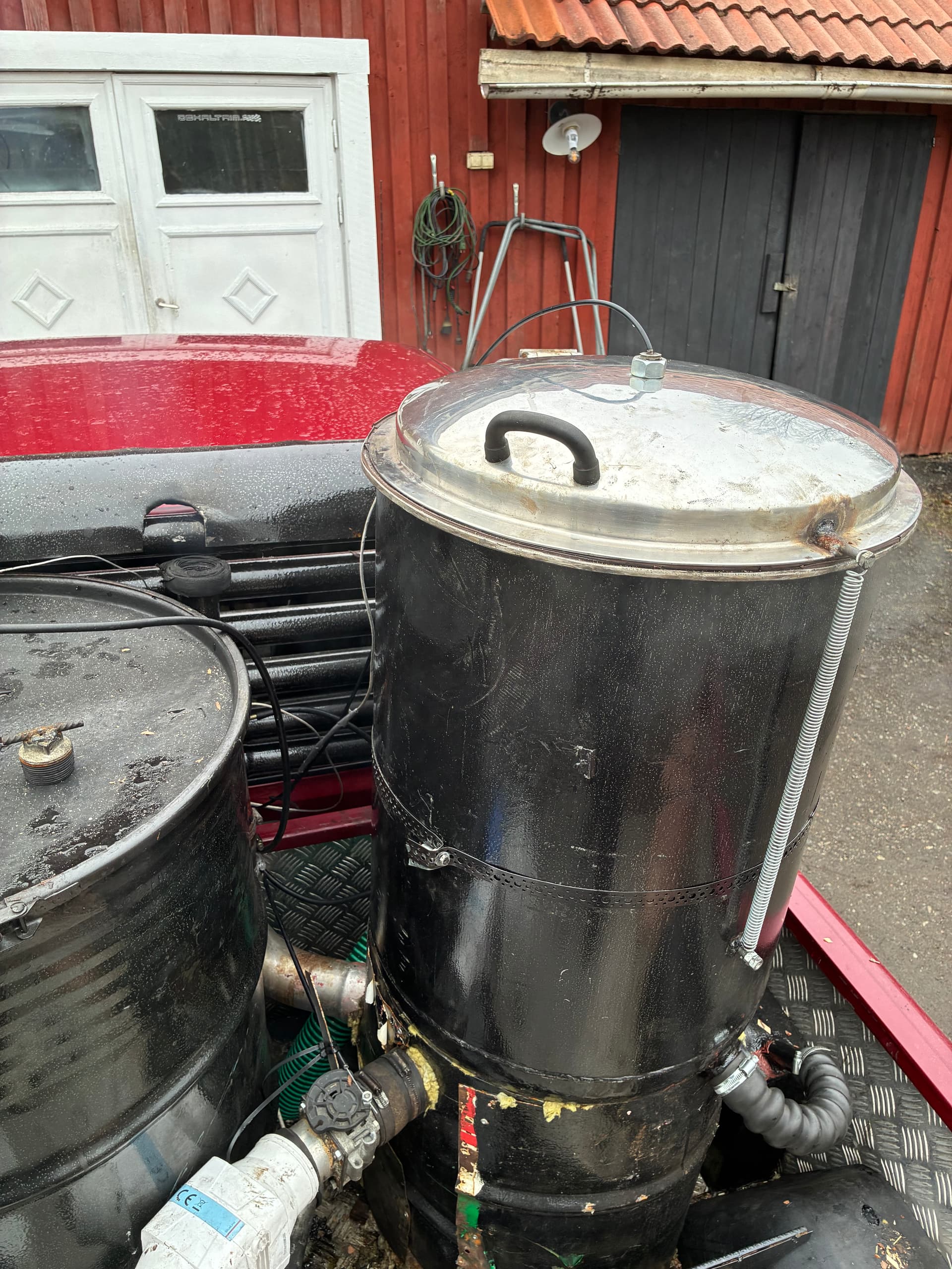

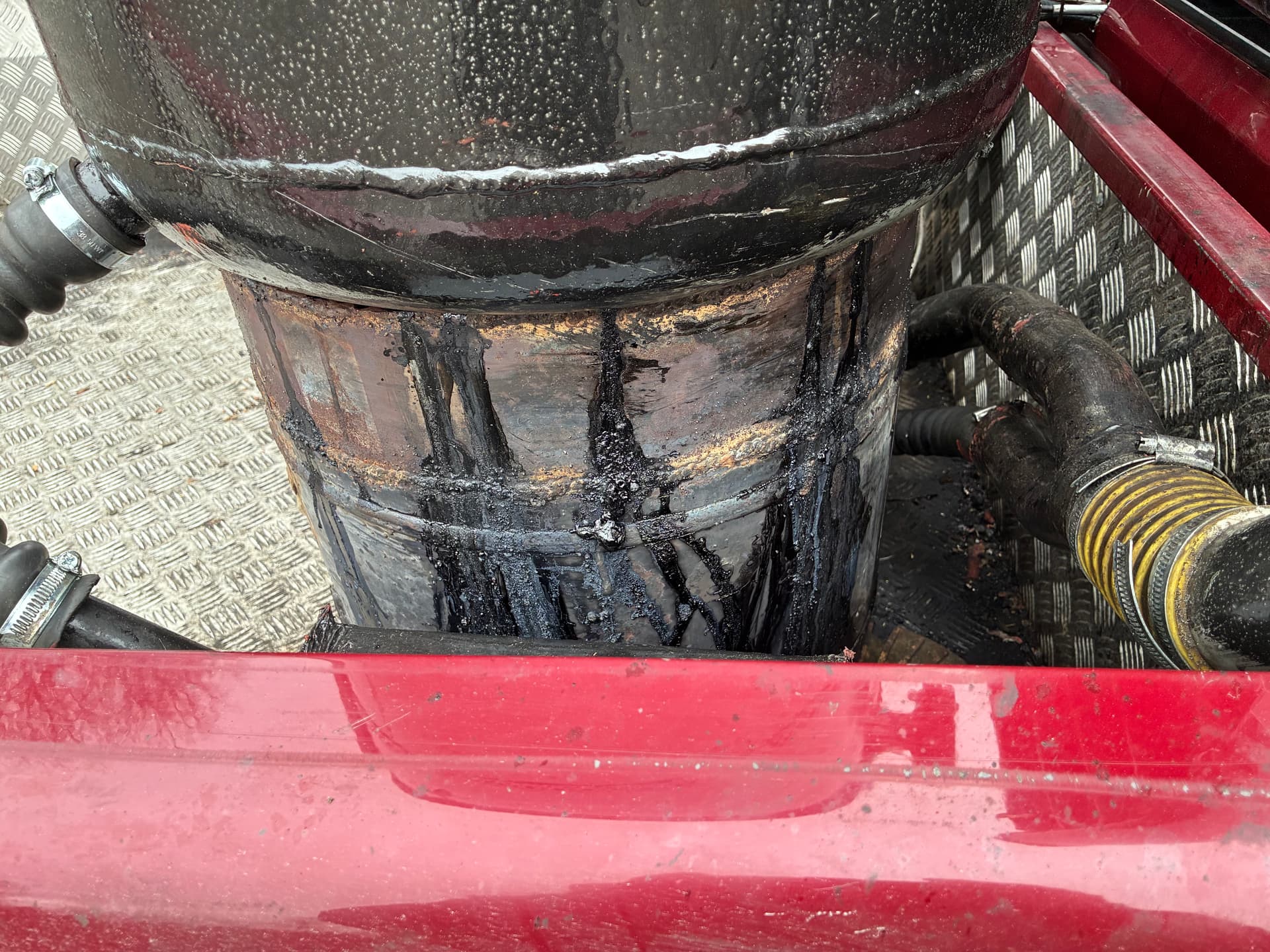

Today the car worked almost like the other one, however I saw that I have a leak between the hopper and the unit, I also think I have a leak on the unit itself, although I didn’t see anything during the pressure test, half a lemon anyway.
if you fix the one, you can hope you accidentally fixed the other, or it becomes a lot more apparent where it is at.

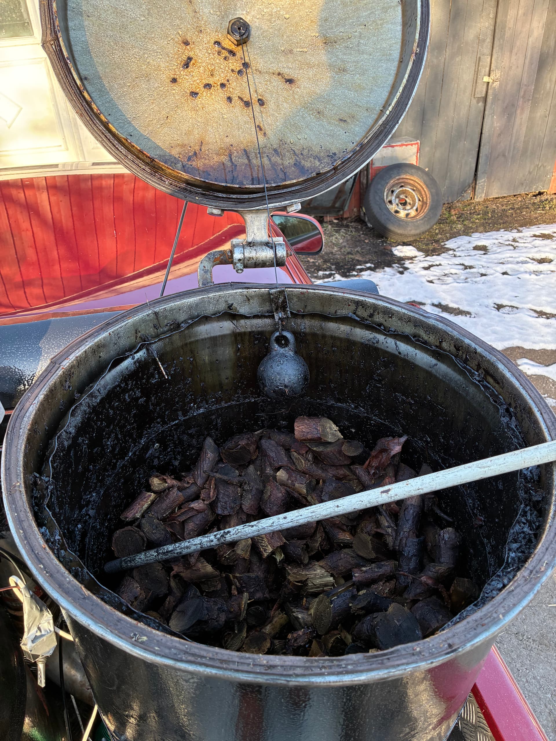

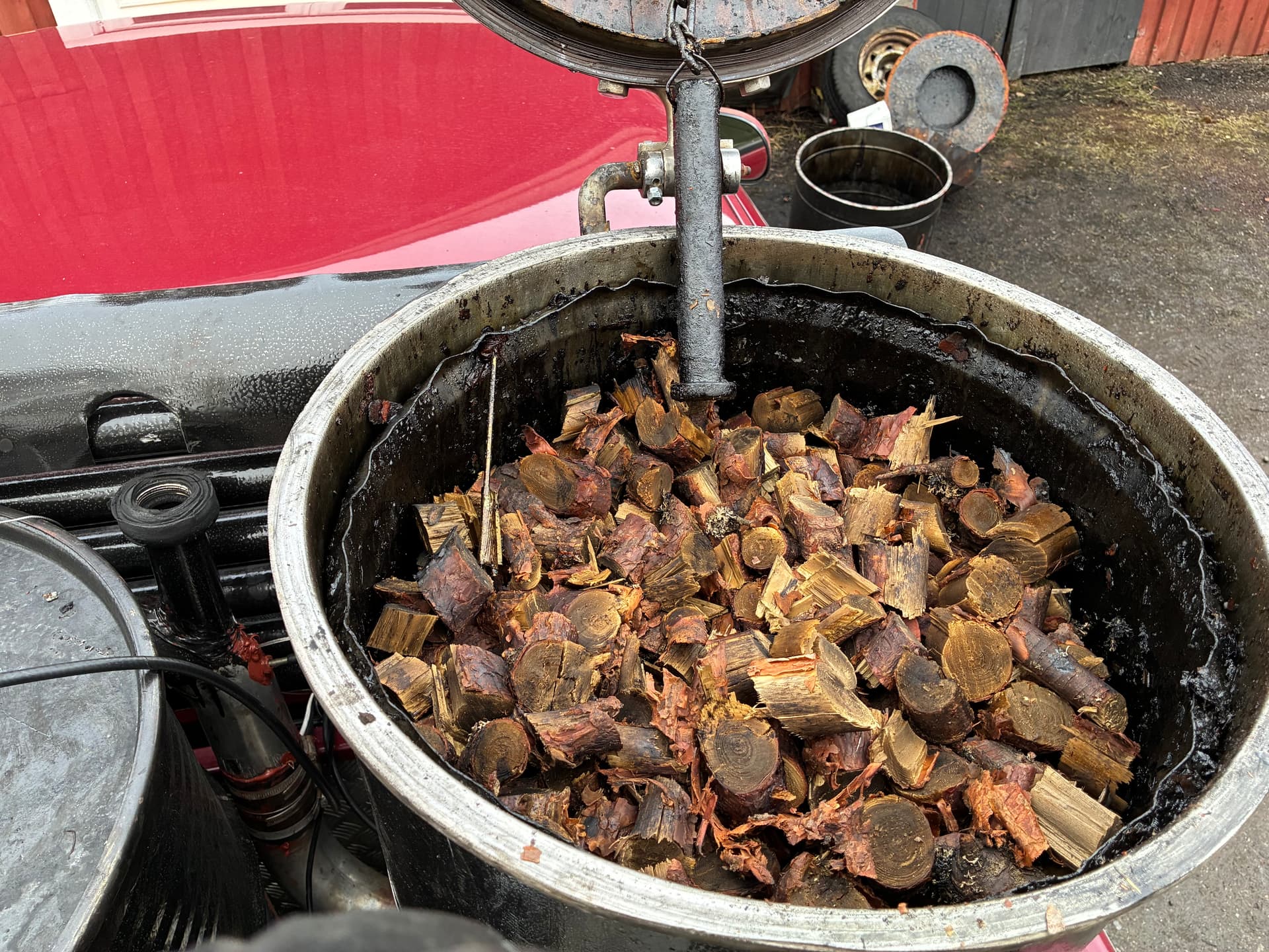

I think I’ve got this sorted now after the new hopper, I get a lot of water out and the wood is completely dry when I start, before the wood was damp the day after.
I’ll probably put in one of those weights that you suggested before, it worked great in the old car.
The problem I have now is getting a seal between the hopper and the unit, the hopper is uneven at the bottom and made of 3mm stainless steel, so difficult to smooth out.

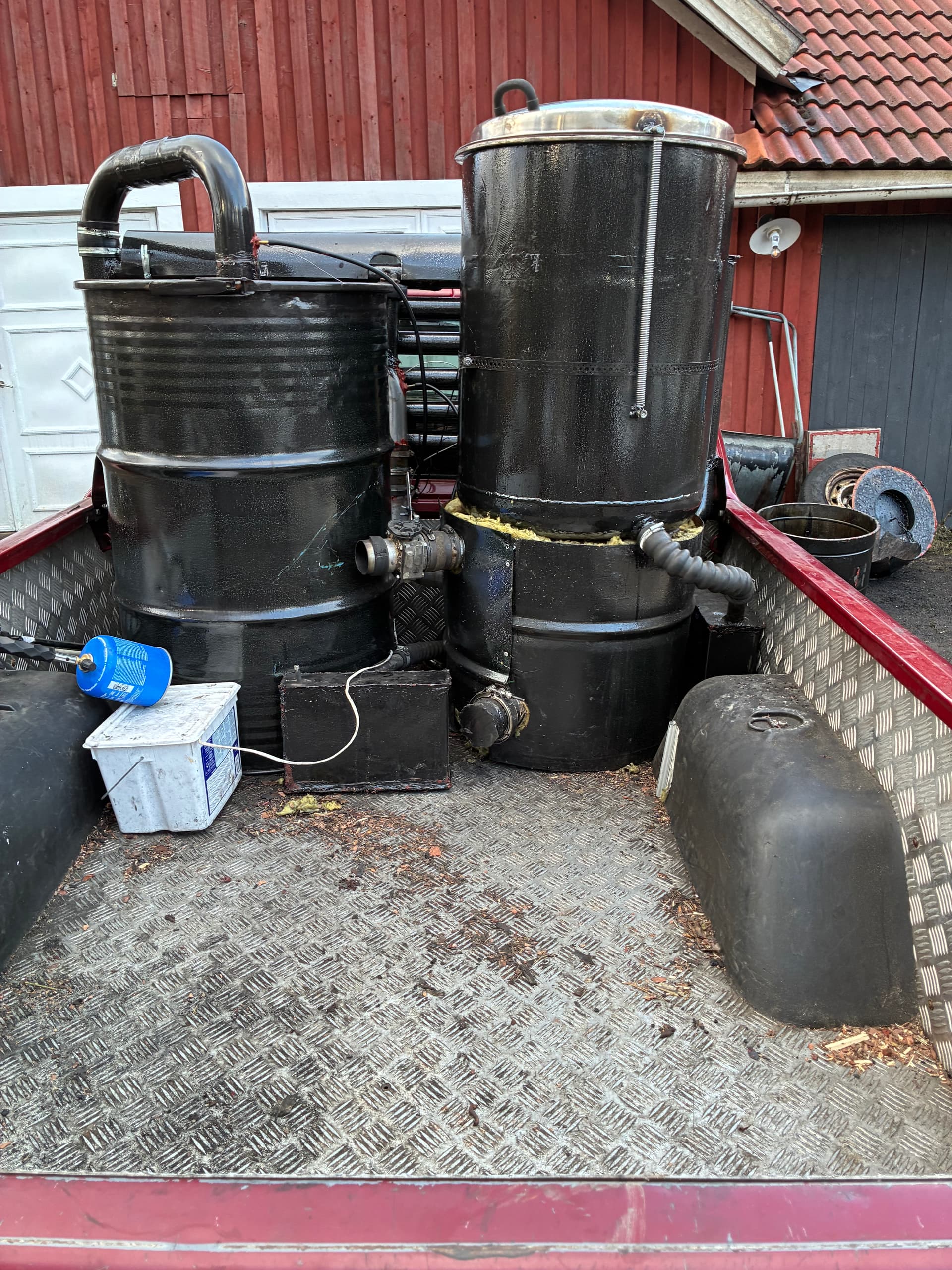

This is what the wood looks like when I start in the morning, completely dry, I have some thoughts, now the car runs quite well, but I think it is a little weaker than the old one, I only have a 48mm pipe on this one, I wonder if it is too small?

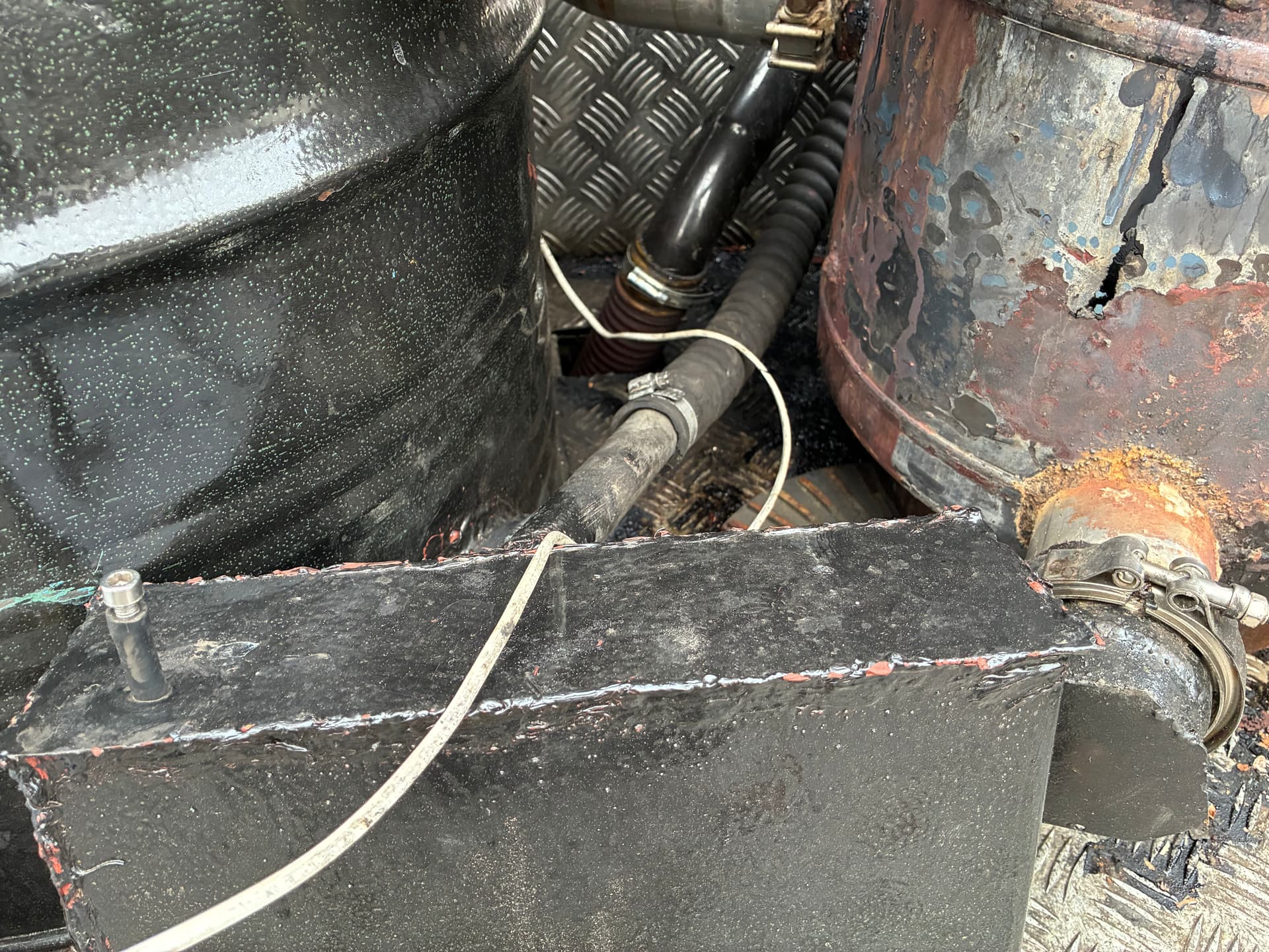

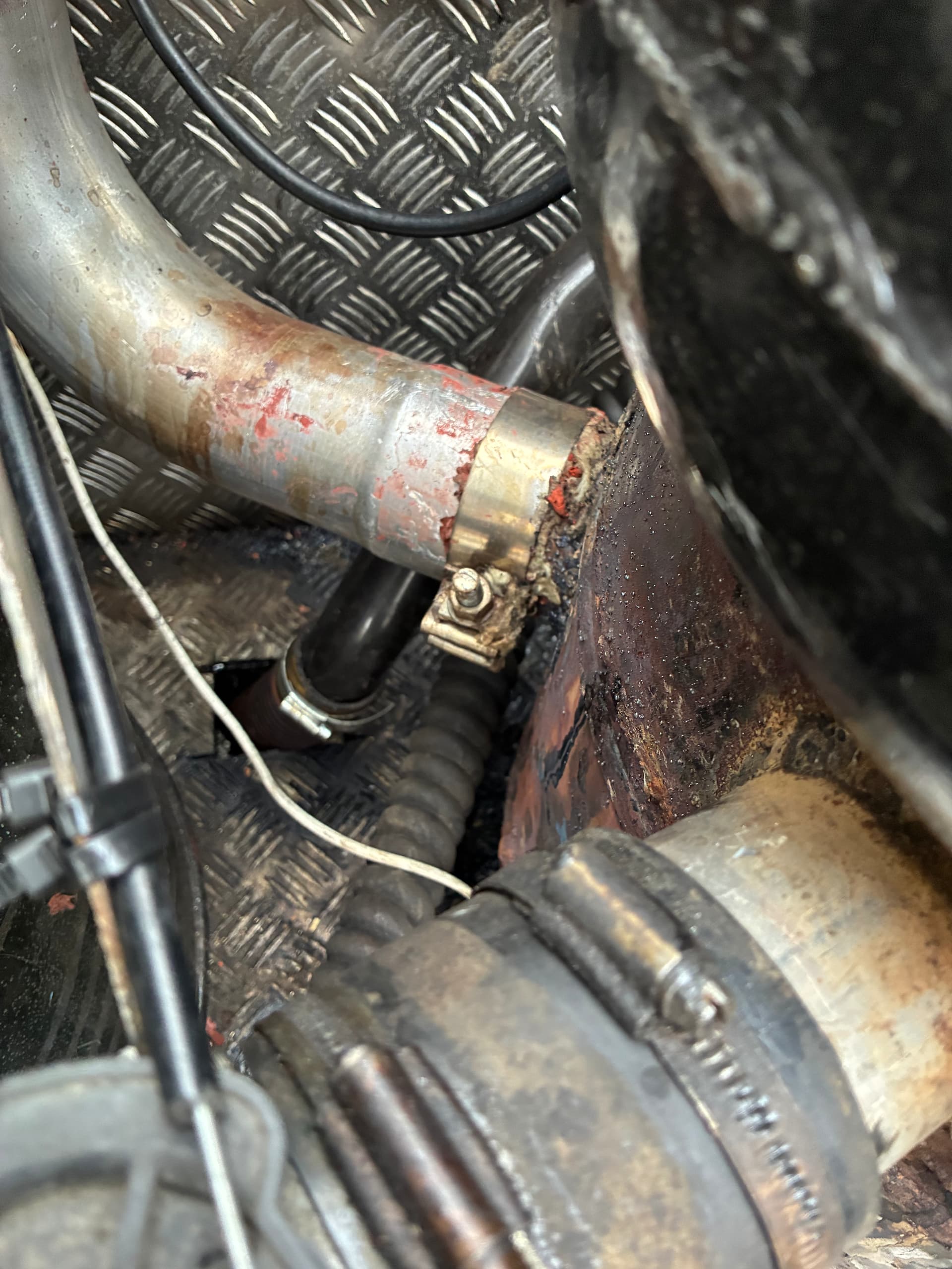

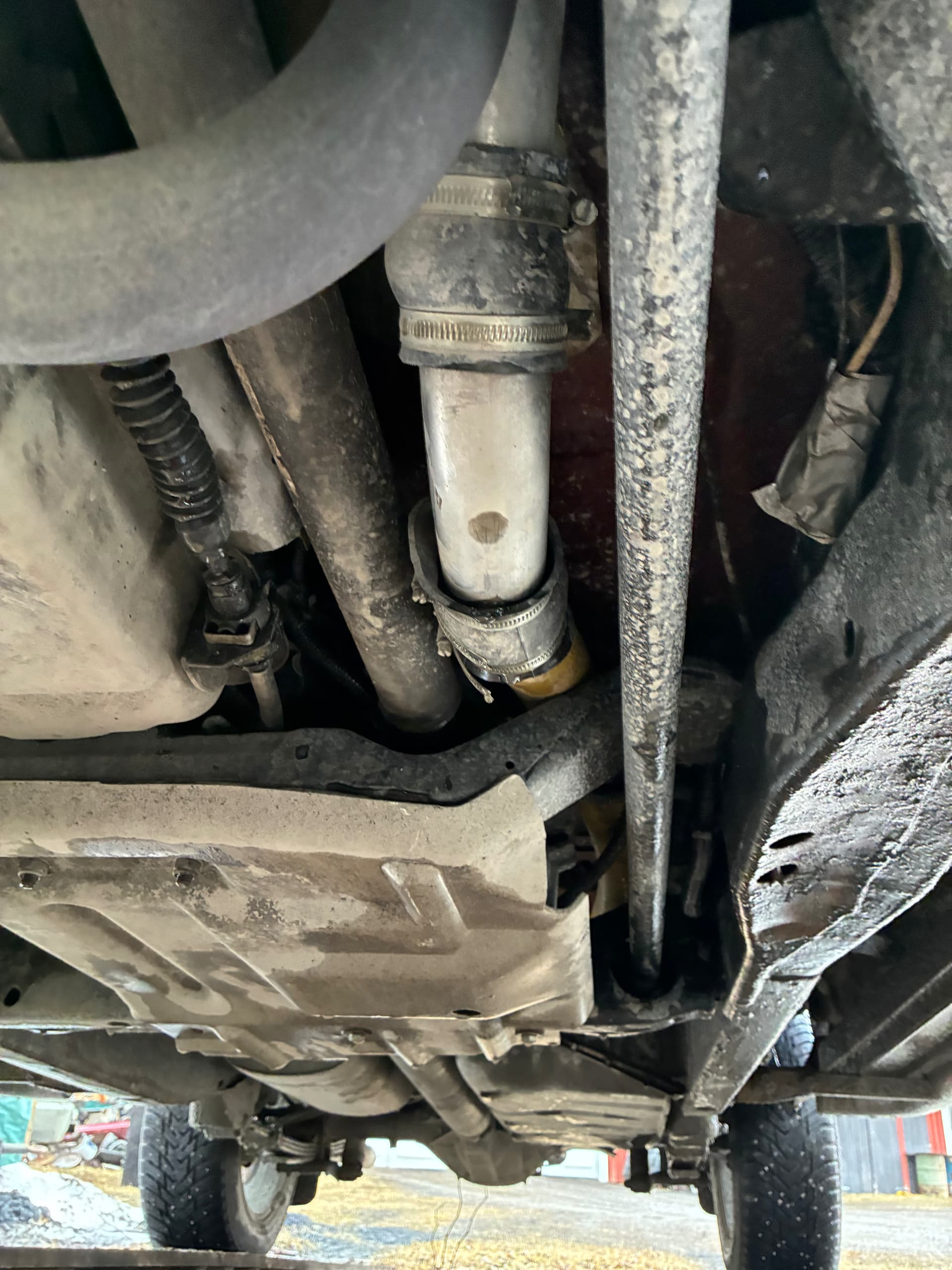

The outlet from the unit is a regular exhaust clamp, I see a little smoke there when I push the air in when igniting, could that be a cause?

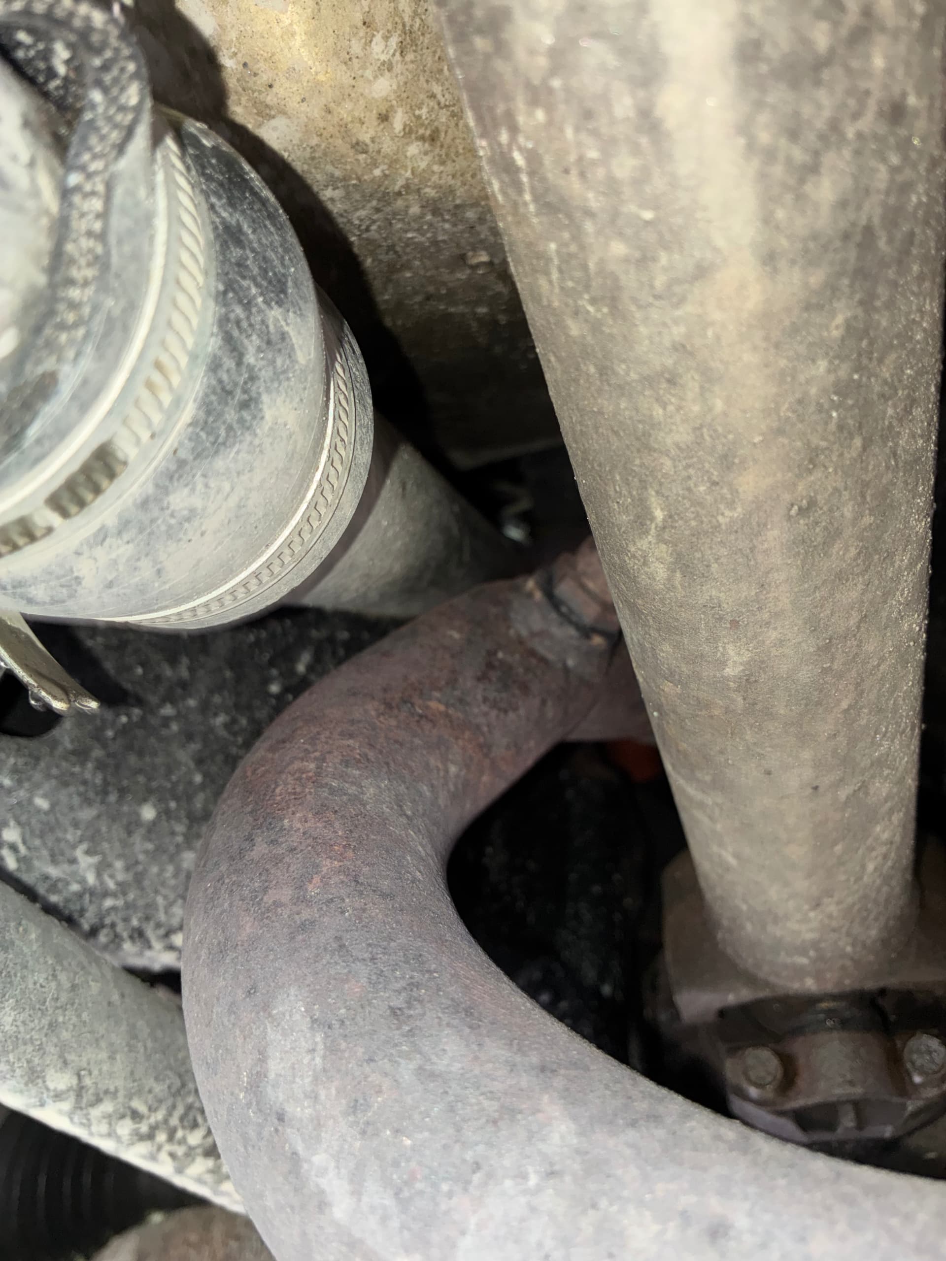

I also run a y-pipe to the radiator, one pipe to the engine and the other to the water tank, I wonder if it will be a restriction?
Should I try to fit a 60 pipe instead and maybe put the tank for the radiator under the car?

Thanks, I thought so too, started buying things yesterday to fix this, hoping I can get a 60mm pipe through next to the engine.
Will an upward bend for the condensation water from the radiator be too bad?
I was thinking of putting a hose from the bottom of the bend to the tank.

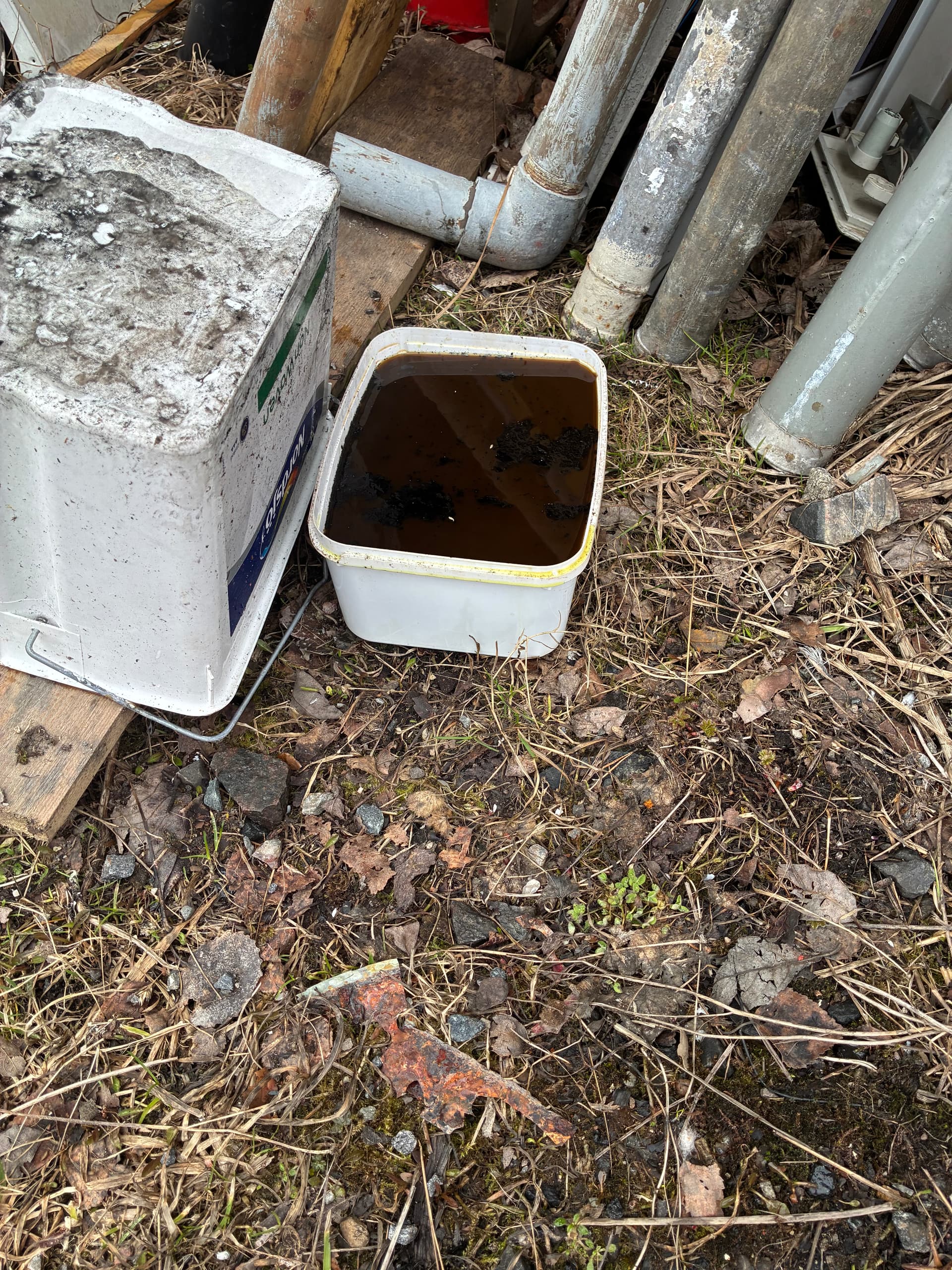

I tested how much water I got in the hopper, emptied the tank when we left and had 2 liters when we got home, had driven about 30km.

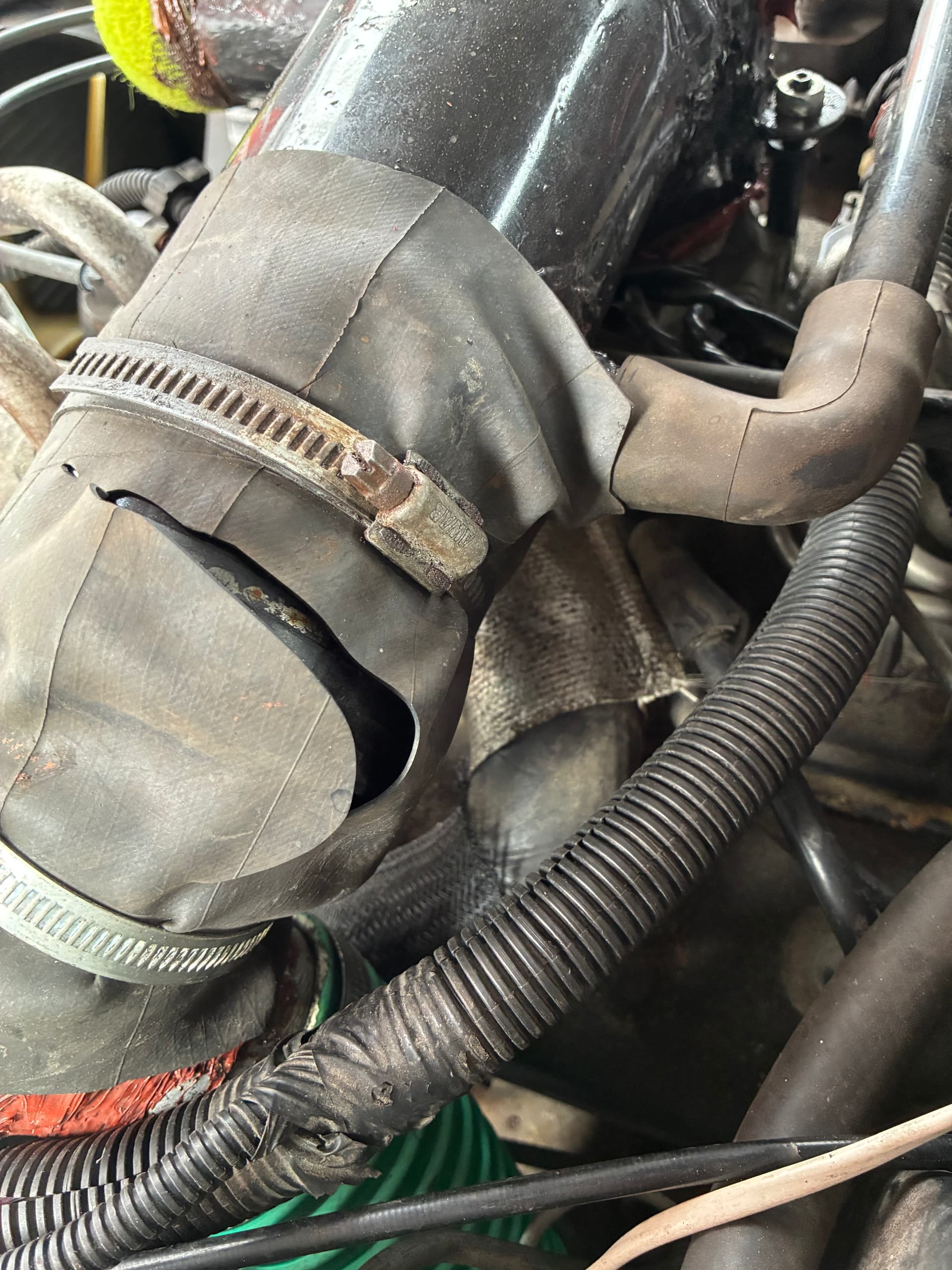

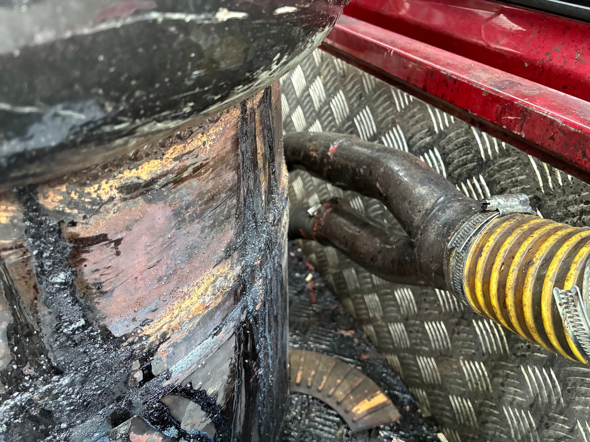

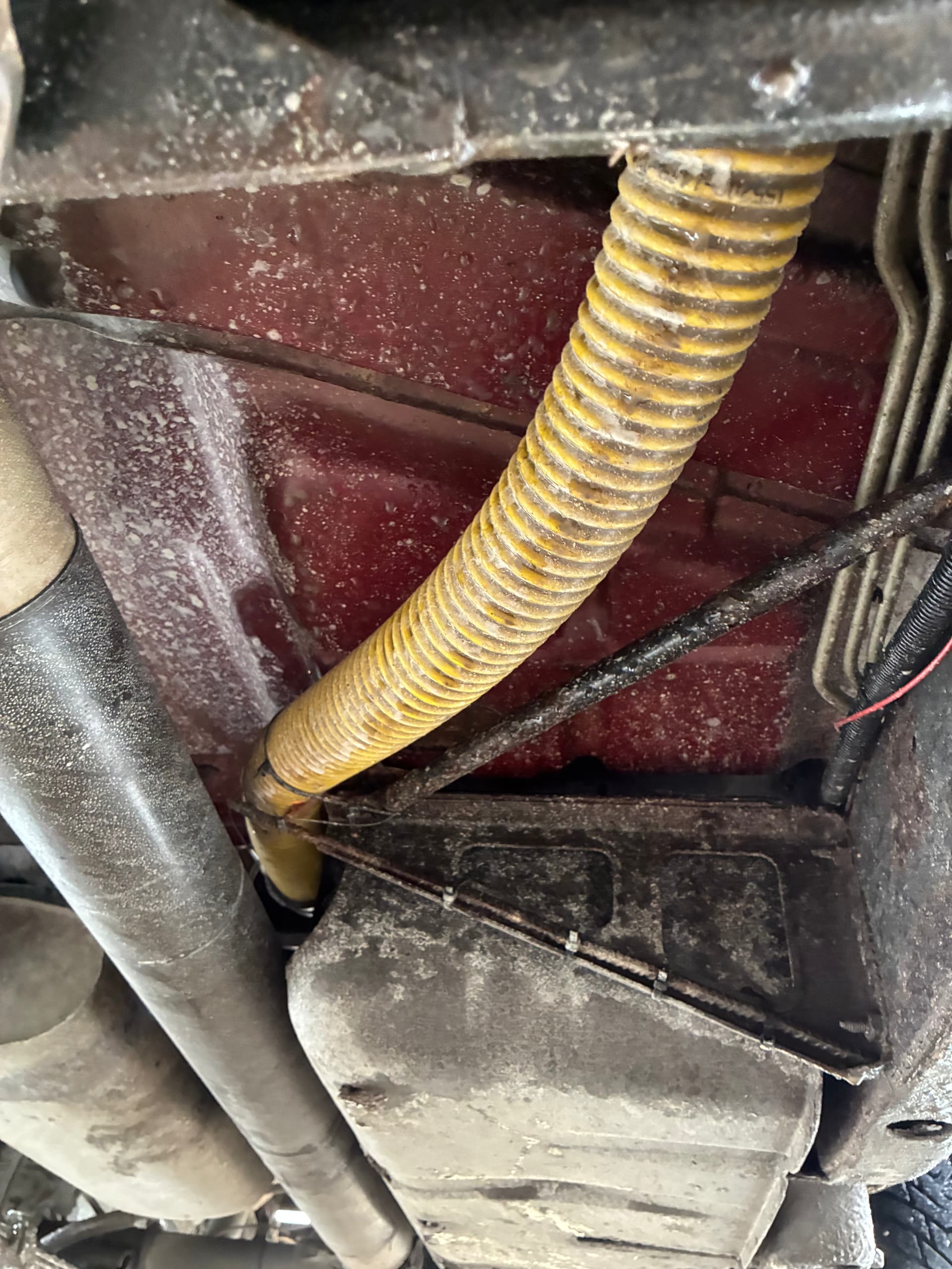

Now it stalled when I got home and wouldn’t start on gas, so I looked under the hood and thought it was the tennis ball that was malfunctioning, but I think I found the fault.
Do you have any suggestions on what I can use instead of an inner tube?
Is there a lot of vibration at that joint?
I’ve used this flex dryer hose for a lot of things Jan. It may need some kind of reducers to fit your system.

It appears to me like it ripped similar to how the synthesized rubber rips. See if you can go to a industrial/ag type of tire shop and ask if they have an old inner tube or piece of natural rubber.
Don, no vibrations I think, but it could be like Sean says it’s just plastic in the hose, have put an old hose in now let’s see if it holds.

Synthetic rubber has been around for decades so ‘old’ may not be natural. As a side note natural rubber can be melted and reformed. if you want to make a custom hose. :slight_smile:
The drier vent is just that thin aluminum foil with a piece of spring steel in it to give it rigidity. It connects the drier to the outside vent. Which also may work…

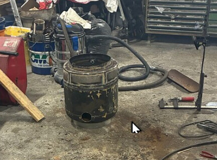

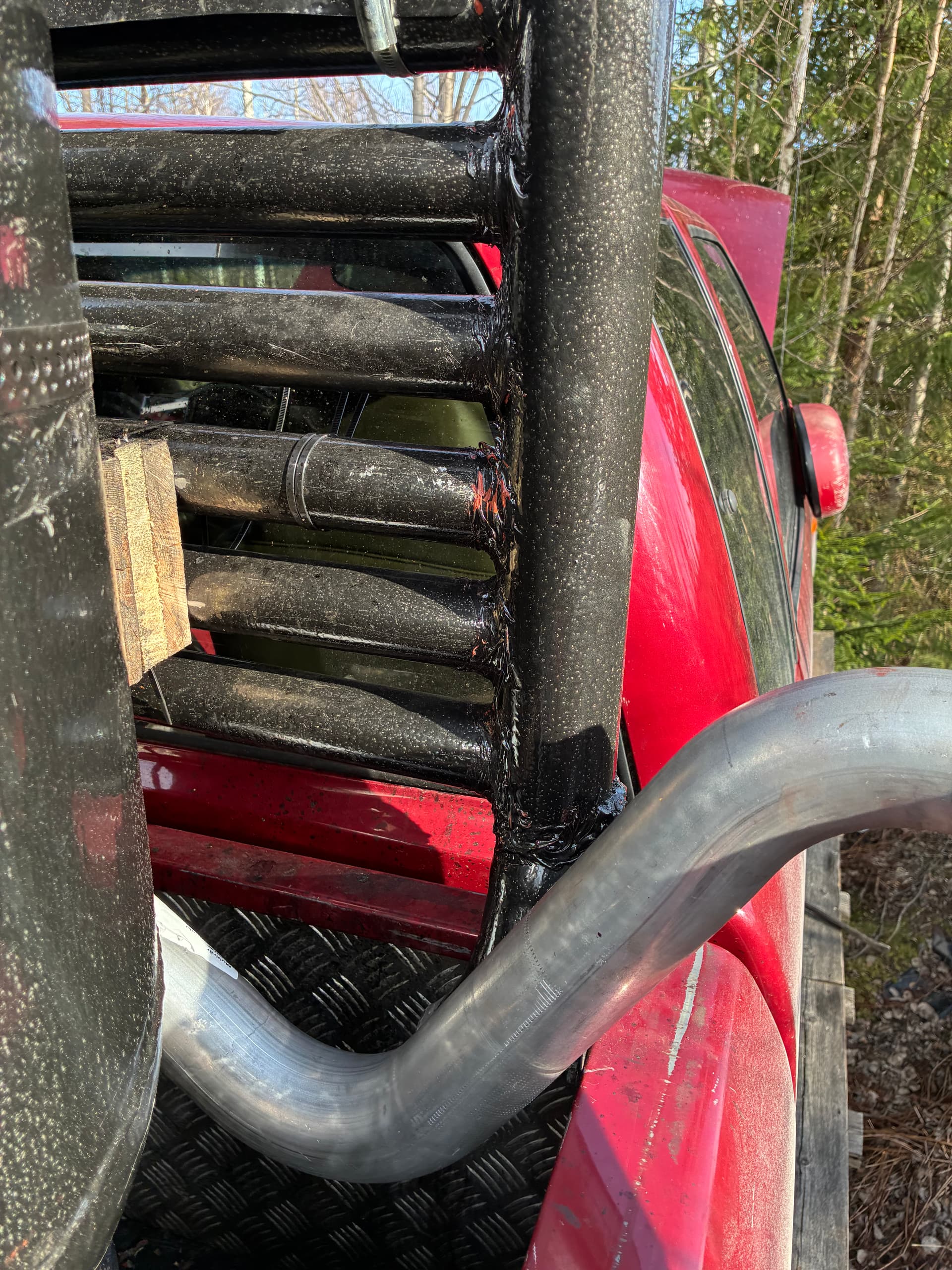

Those welds look OK to me!
You should see them up close, I’m going crazy before I get the flux welds tight, I think I’ll have to take my bottle of gas home again that my son took.
This seems to work quite well.
