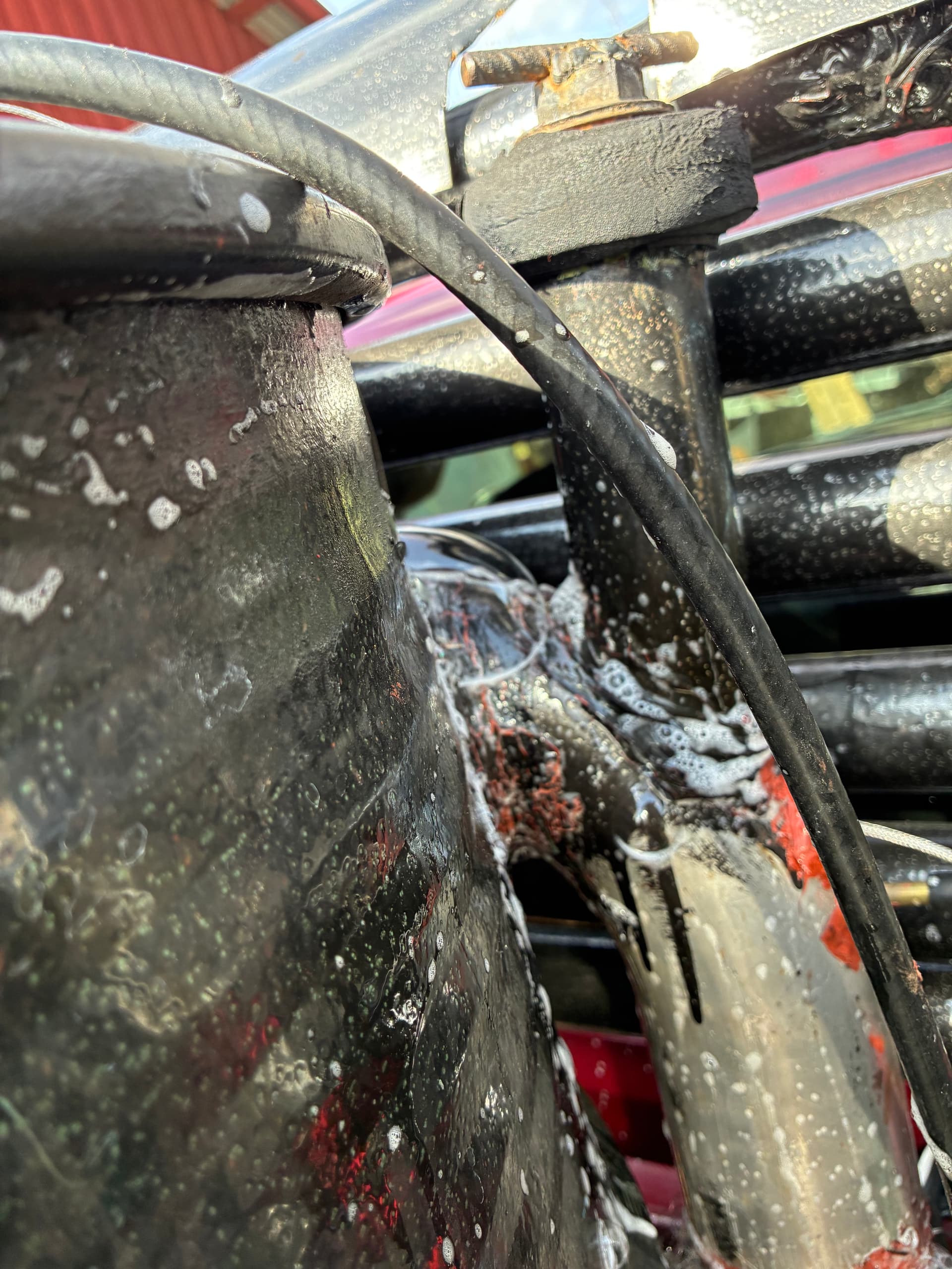

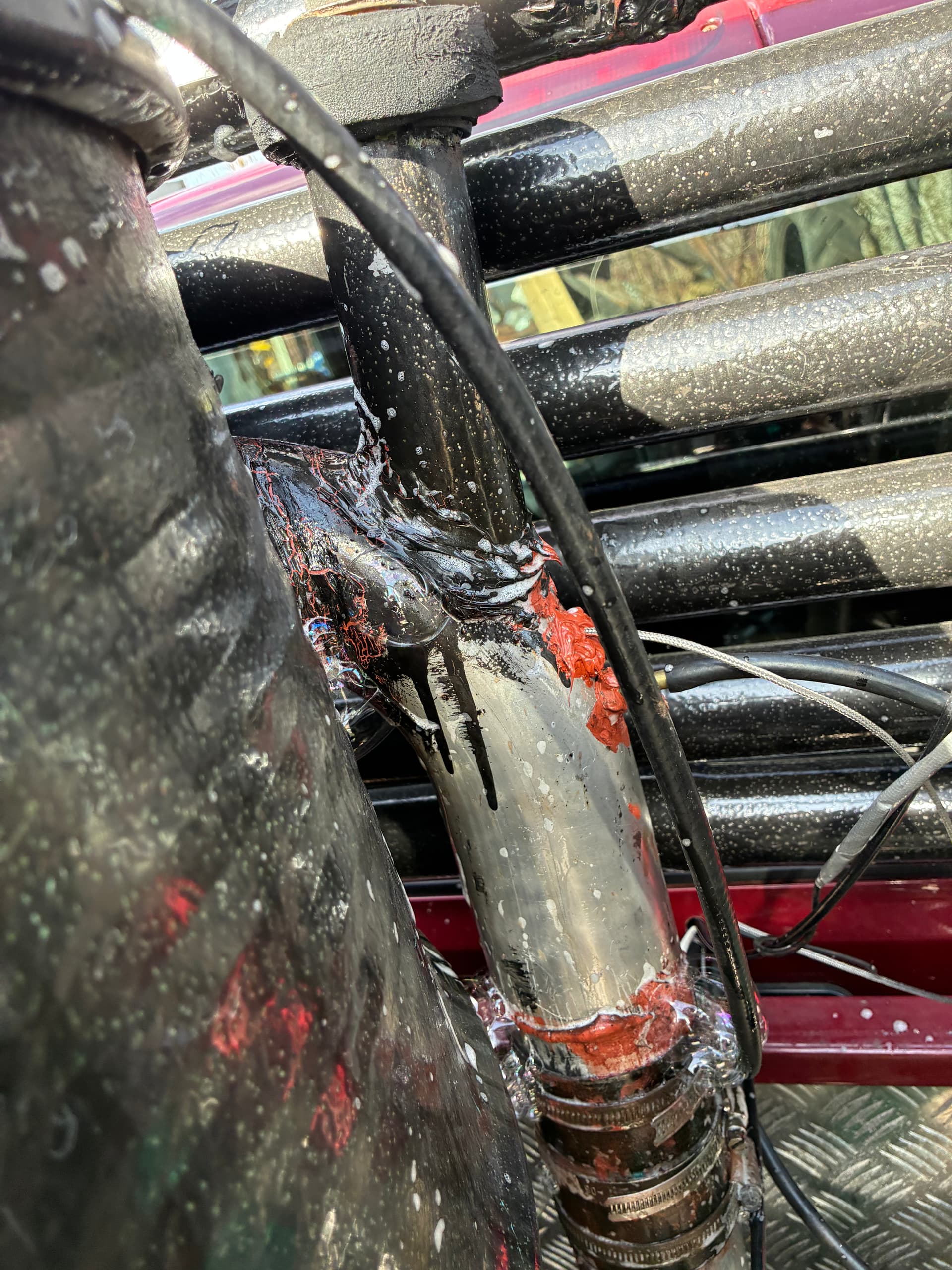

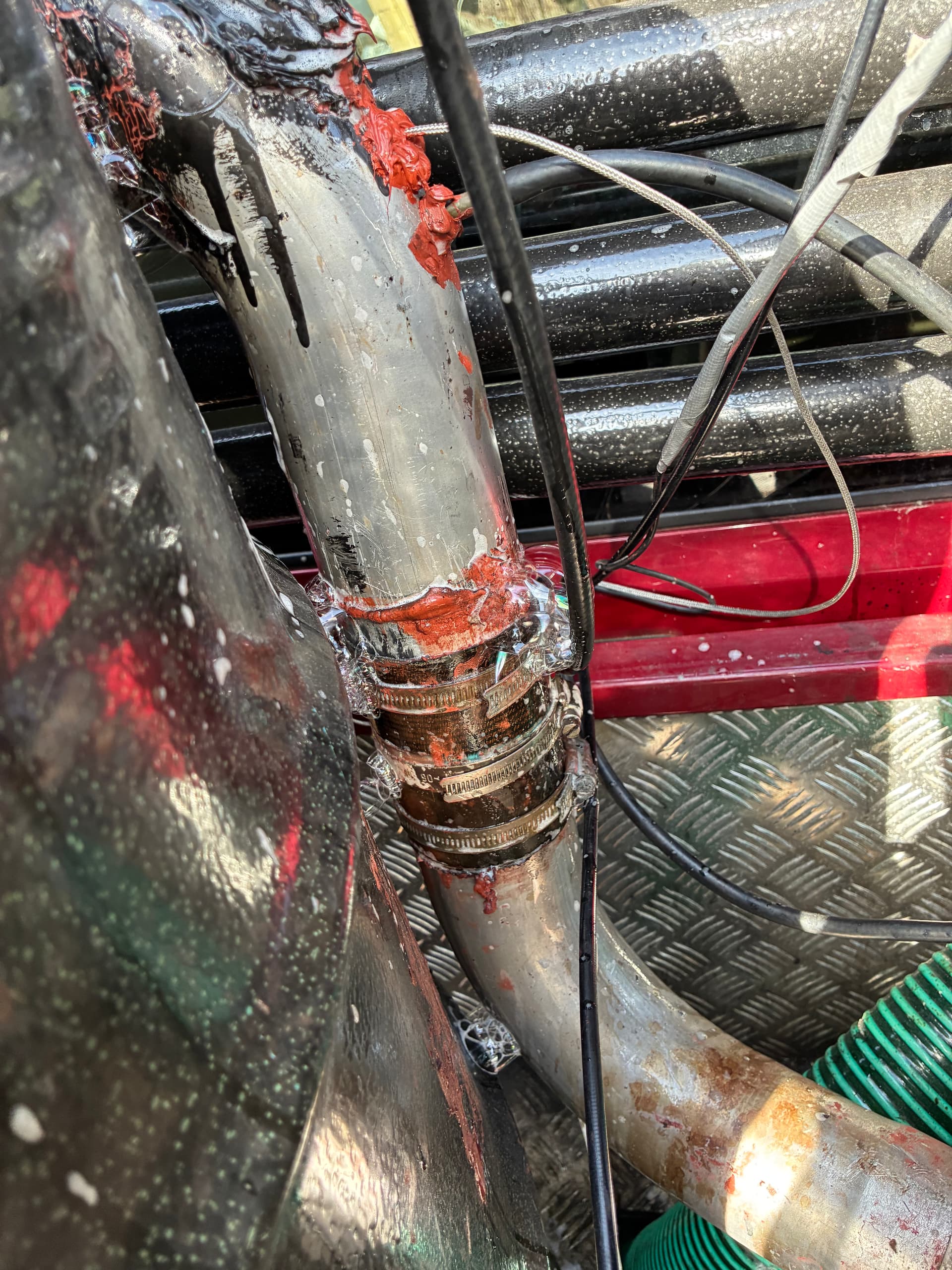

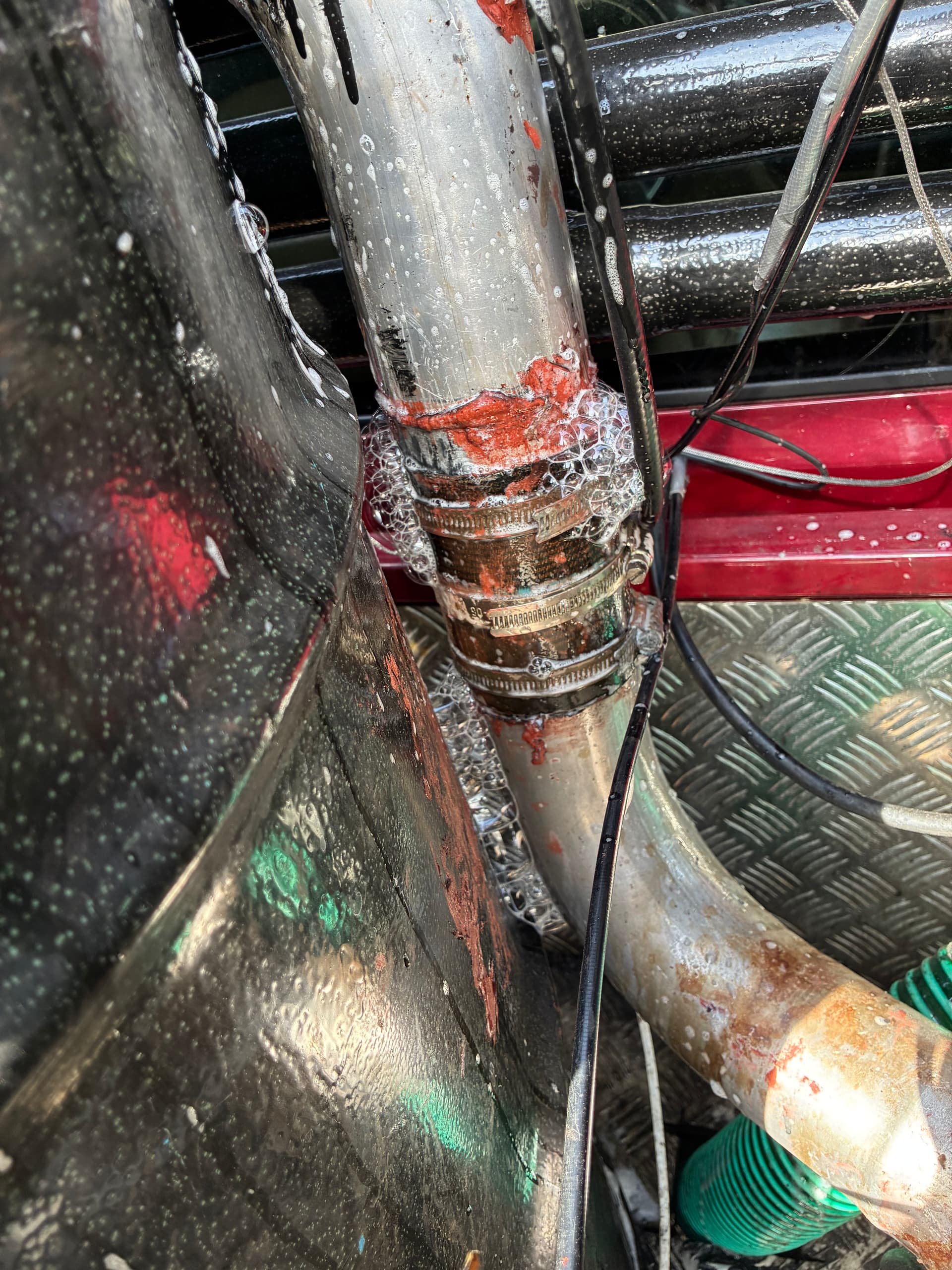

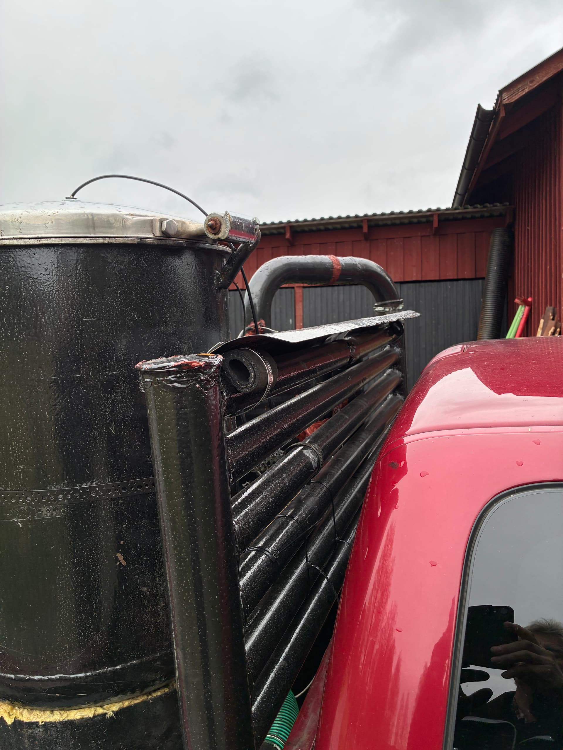

Yes, what do you think, could this be a problem?
This is the pipe between the unit and the filter.

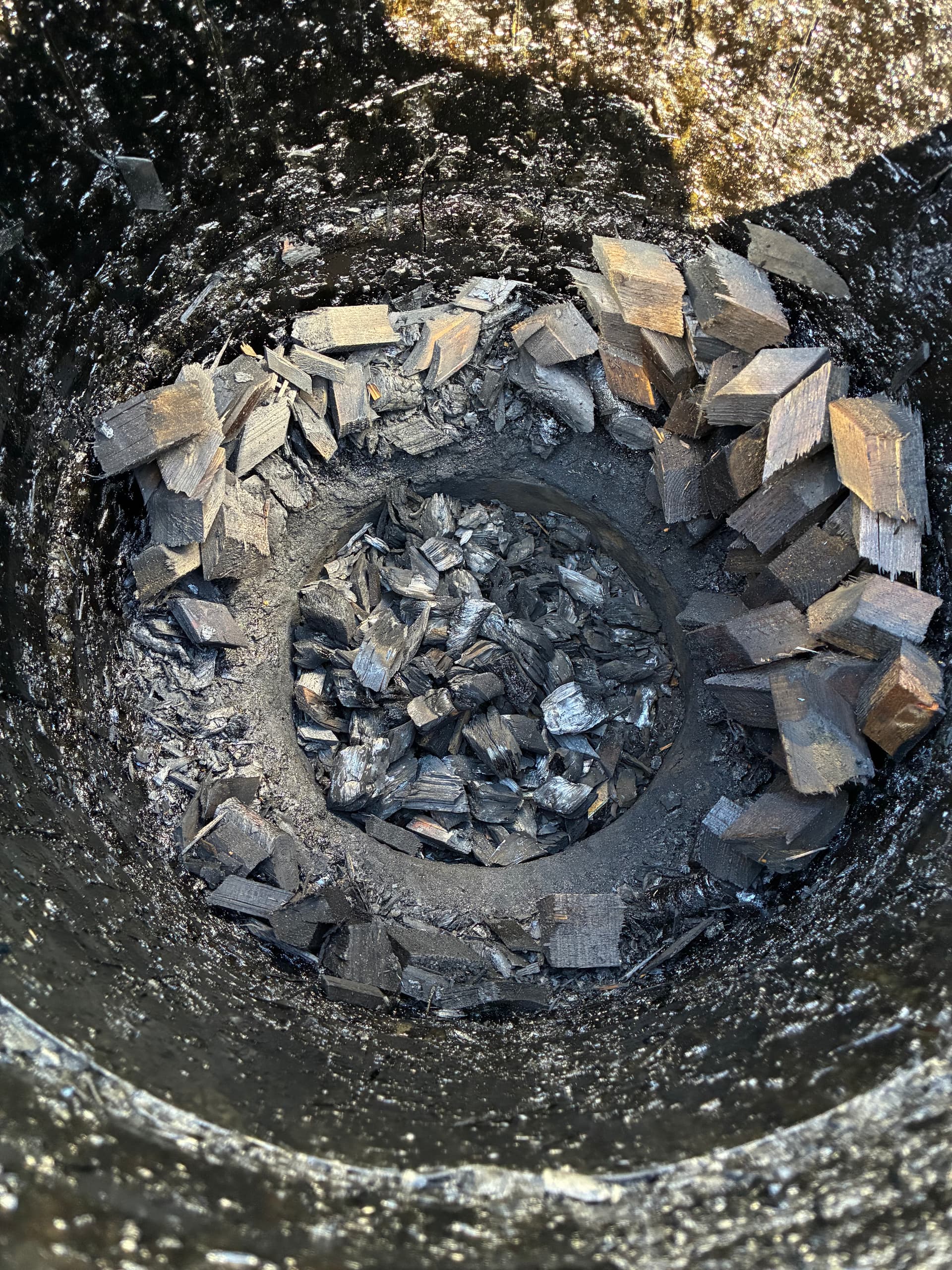

I have a very loose carbon bed, almost not felt when I drive the rod down.

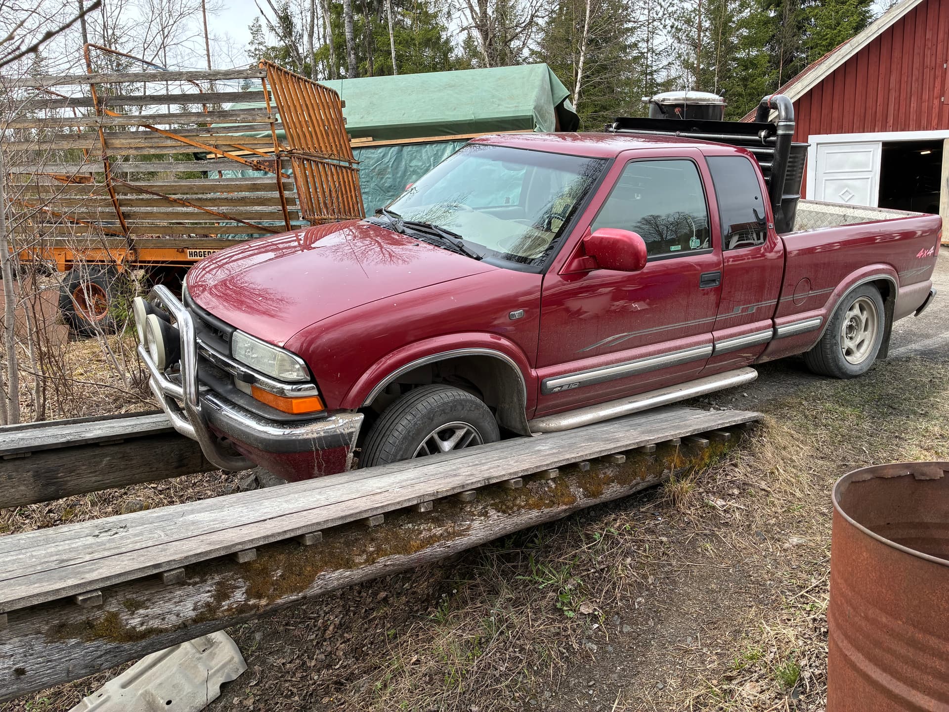

I was thinking about this with the temperature, since I have 300c after the cyclone on the old car, and 450 right after the gengas unit on the new one, shouldn’t it be pretty similar?

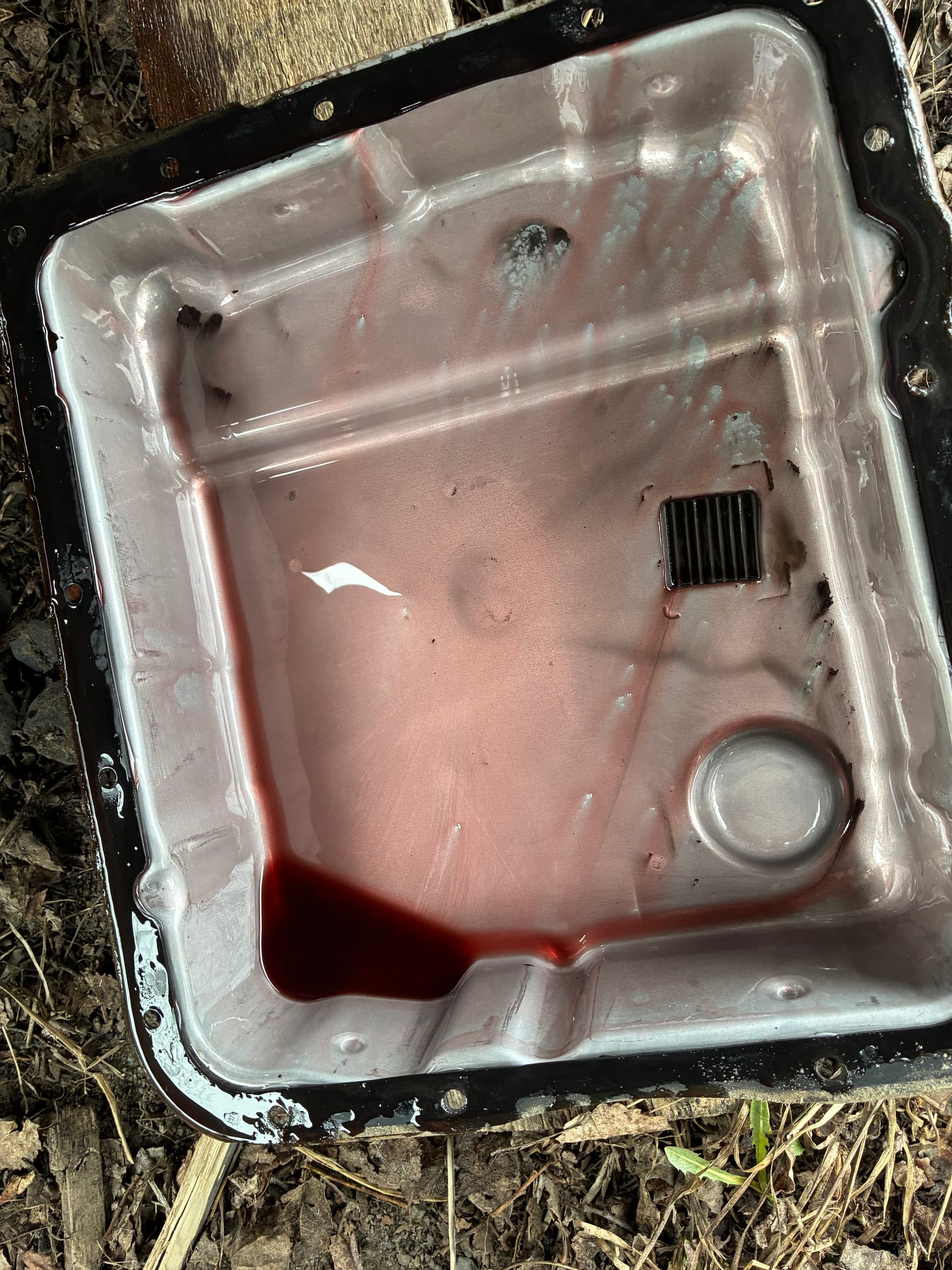

Changed the oil in the gearbox yesterday, didn’t go so well, I drove up to the dock and went under and let go of the fasteners, and the car went backwards, no handbrake of course, I was hoping it would go straight backwards but it didn’t.
Apart from that, doesn’t the old oil look nice?
I am no expert. It is definitely not the worst I have seen though.

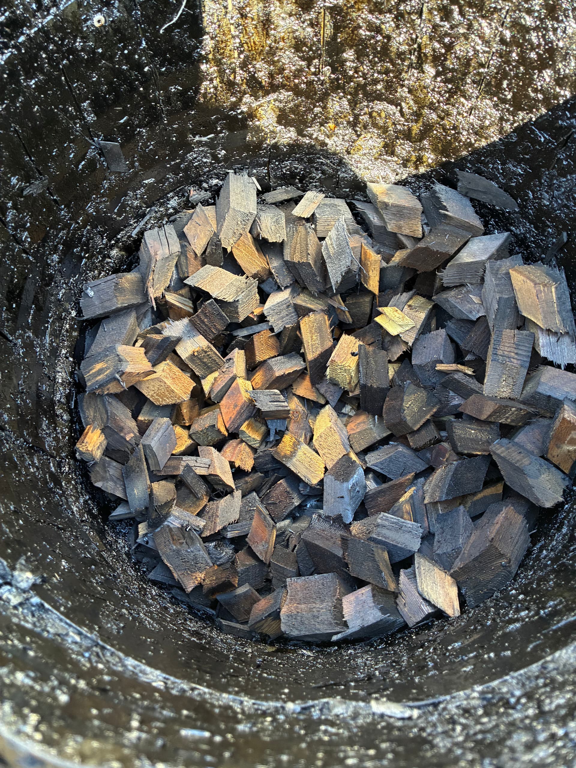

I never have any gas left in the hopper the day after I drive this car, and I think it takes a little longer before I get good gas in this one.
I was wondering if the carbon burned out during the night, but I think it looks good, or is there too little left above the nozzles?
Could it be because I drive on dry spruce, which is quite wet, I get about 5-6 liters out of a bag in the hopper?
I also wondered if the lid is not really tight, and that is why I have no gas left the morning after.
I also still have problems with it popping in the intake, and is difficult to start on just gas, leak somewhere?
However, I think it pops when it is running too rich.

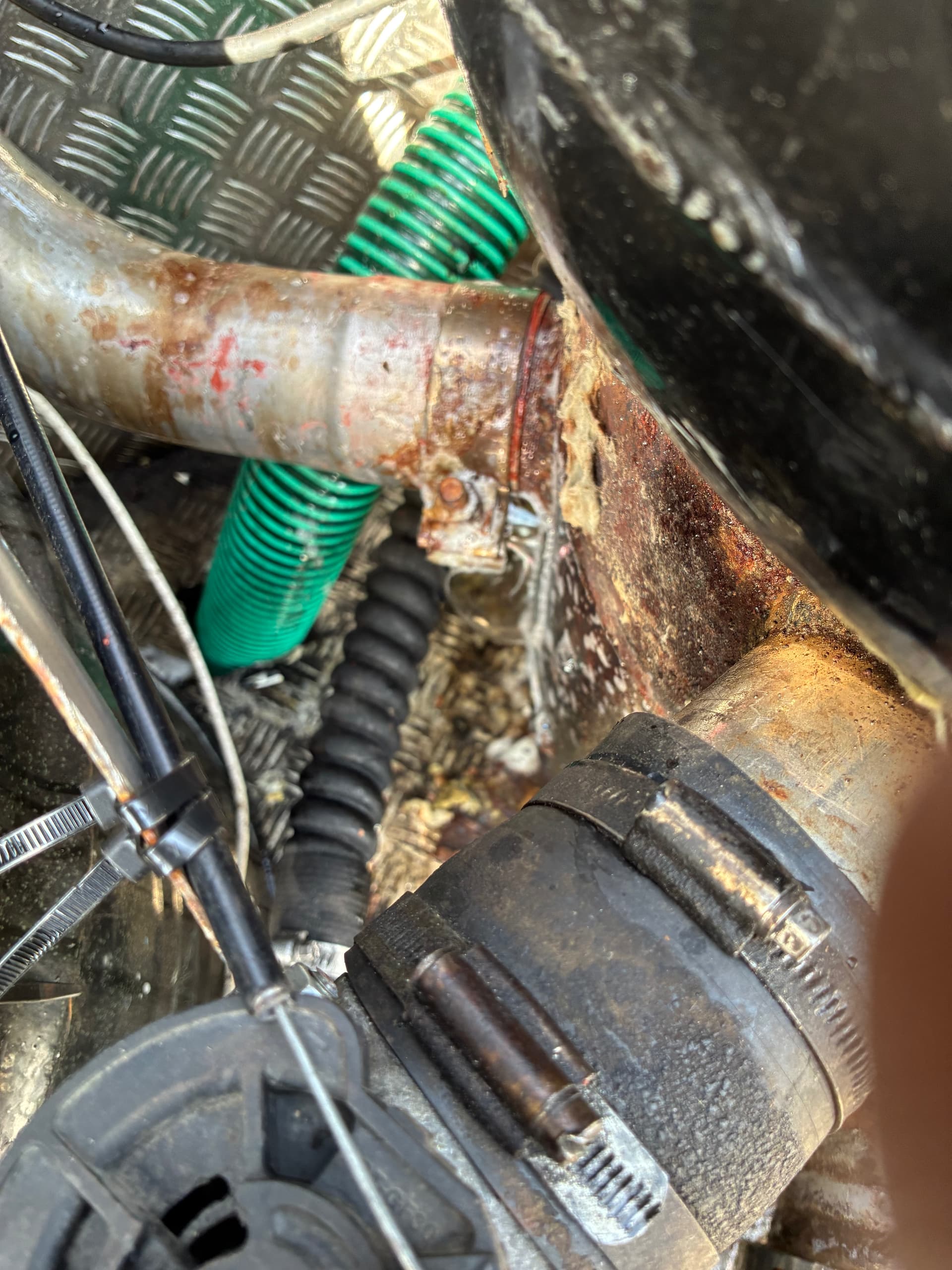

I sealed the can on the intake yesterday and tested it in the forest, it didn’t work any better, but when we got home we saw that the crankcase ventilation had fallen off.
Tried again this morning, and it seemed a little better,
but would like some advice on what’s wrong.
At 110kmh (68miles)I have 465 degrees C (896f) out of the unit, if I stop the engine and try to start on gas I have to close the air a little before it starts, but I can’t move the throttle and it stops, if I close the air more it dies, if I open the air it dies, I have to drive for quite a while on petrol before I get good gas.
I never have any combustible gas when I start in the morning, which I always had with the old one, I’m running out of ideas.
After sealing the intake, it seems to puff less.
