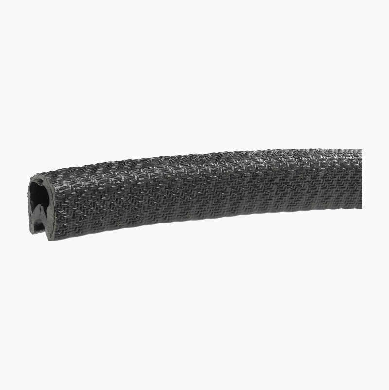

Would this work as a seal between the lid and the wood container?
If I press in silicone first and then tap the strip in place?
Have you felt it in the store?
Those edge protections are more stiff like plastic than rubber in my experience and won’t smooth out used as a seal so I think there would be some leaking, they are a bit hard and would need another seal to be good. I have not held that one from Biltema in my hands though so it could be softer but I have other ones like it.

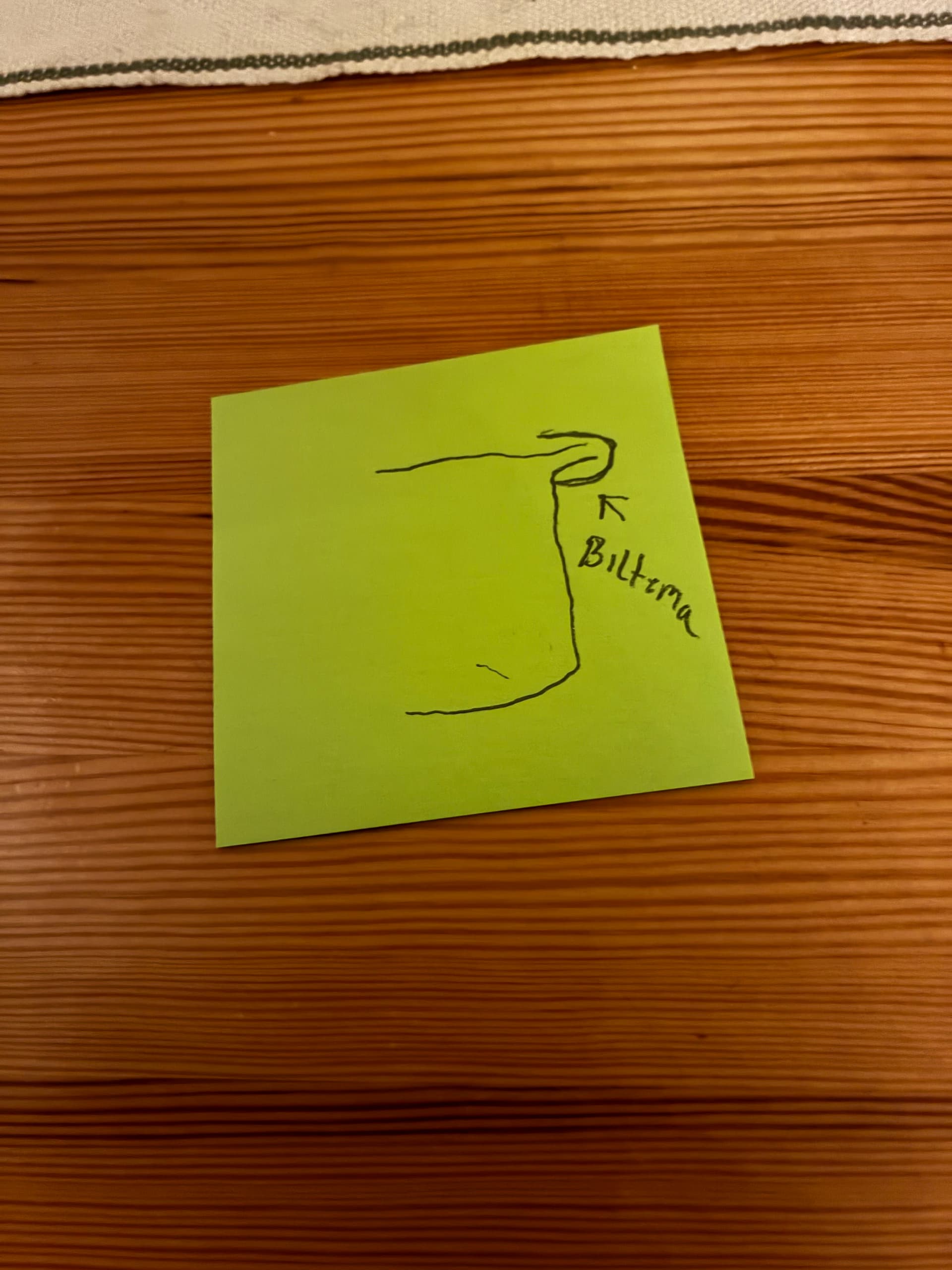

I thought it would sit over the edge of the box and the lid, if I press in silicone in the u-rt first then tap the strip over the two edges?
Do you have any pictures of your project?
Ahaa, that’s how you were thinking. I think that would work but someone experienced should probably say what they think about it.

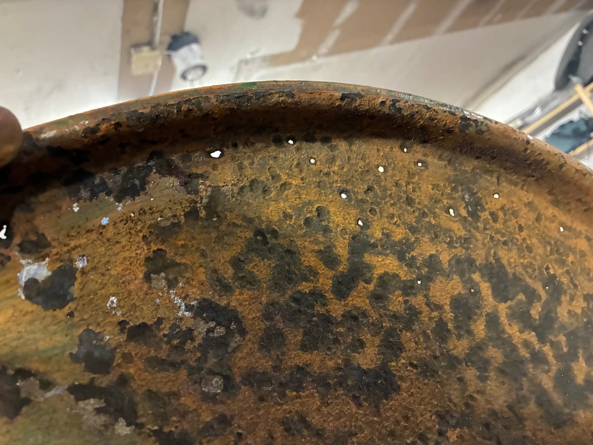

On this topic you picture up well how you have rust you must deal with. And what you’ve done.

Black gooey and dripping is normal for a raw wood gasifer.
But I’ve tried to help neat-freaks with woodgasifiaction and they could never accept, black and gooey in the upper end as normal. Actually desirable; showing heat refining out of for removal of the long chain creosotes. The surface build ups then actually acting as a steel metal preserver from the acid conditions.
