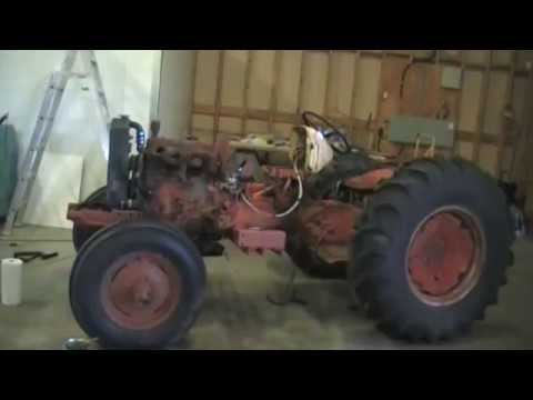

so we finally were able to go get the case… it’s in the shop and slowly being stripped a little at a time…
it does turn over (carb is off so we didn’t try starting it), and the electrics have been switched over to 12v… I have a bunch of wiring to go through before I’ll see if it runs… well, a carb rebuild as well…
I need to make a gas tank as well as the original is long gone, previous owner said it was rotten through and through.
We do plan on doin a bit of a repaint as well… may as well make it look somewhat nicer if we’re gonna put one of our units on it…
Previous owner was gonna put a loader on it… whole bunch of extra steel on the old girl, at least saddle bags for the gasser and final filter are kinda already started.

case tractor pics
Case 310 utility tractor
2.4L engine, 4 spd triple range transmission, converted to 12 v neg. ground.
Hey ArvidO. Nice picture set. Thanks.
Is that casting just below the radiator the steering box or a front of engine pump?
Thanks
steering gear…
