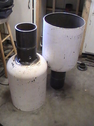

Yeah, considering its just 6" sch 40 pipe, 4" sch 40 pipe and some plate… right there represents over 25 lbs (one hearth section) in steel. this is the area in one of our units that gets hot… so we build it heavier, just made sense to me.

got one set of nozzle tubes welded in… need a better drill and drill bits… I’ve also been working making the 310 look a little nicer… some body work, paint etc… It’ll get there.

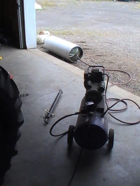

I have some propane tanks that I’ve had water in… just gotta cut those apart. and I can start welding all the stuff together… fun fun fun…

Yup, I’m kinda a fan of tractors as well… have some expired 100lbs propane tanks that I’m gonna re purpose… getting them ready to cut… they did have water in them for about a week, and then just drained and left to breath for a couple of days… pushing some air through them is the last step…
slowly things are coming together… of course this is where I stop showing what goes inside the lower reactor part… stay tuned till for further developments
