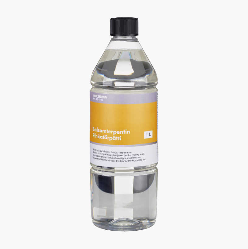

I don’t know if you’ve tried this cleaner, it’s turpentine that the painters use, actually cleans the hands from the tar.
