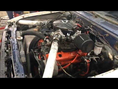

First video i forgot to post in this thread, second video is the newest. Interested to see how this smaller camshaft and low stock compression will do on woodgas

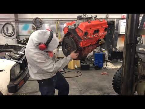

Didn’t know they had a tool to pop out that pilot bushing. I thought that was what they invented wonder bread for. At least that was how I was taught to do it.
You can then roll the rest of the bread up into dough balls and us it as bait to fish for carp because you would be wise to not eat it. You know the old saying. “The whiter the bread, the sooner you are dead”.
I have used bread, wet newspaper, and grease with a bolt before to hydraulic the bushing out they all work this one is just so much faster!
4 uncooked tater tots and a bolt. ![]()
Alright it is running and ready for wood gas.

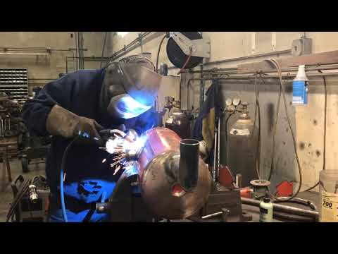

Heat exchanger drop box rebuild is sloooooowwwllly coming along
Looking good Marcus, not sure on how heavy of a gage of metal you are using. You can weld some angle pieces on the sides to keep it from flex poping when under a vaccum pull on the gasifier.
This is the same 14 gauge sheet i had a bunch of im impressed how stout it is now its all welded up. When it was just fkat sheets its a little weak feeling but better theb the 18 gauge drums i had on there by a mile. Ran into a unfortunate measuring mistaje just now though, the heat exchanger is getting rebuilt so it wont fit now. Going to be 5" diameter instead of the 7" it was before. Oh well, good thing i like building stuff and sticking it together with hot metal glue gun!
