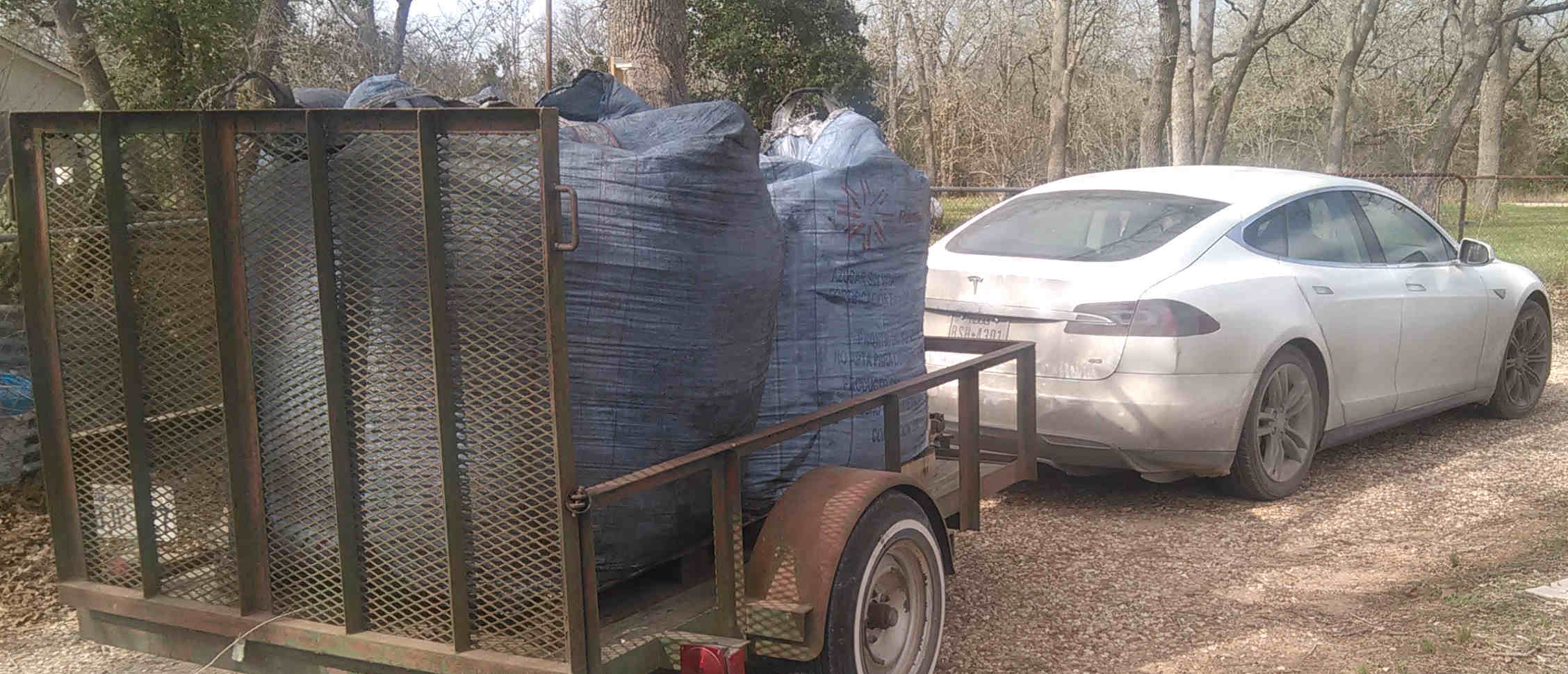

We bought this car from my neighbor who bought a Tesla Model S. His car has almost 100K miles and shows very little battery degradation.
He uses it to deliver produce to grocery stores, sort of like a farm truck. In the photo, he is hauling about 1700 pounds of charcoal fines to use as Ag Char.
