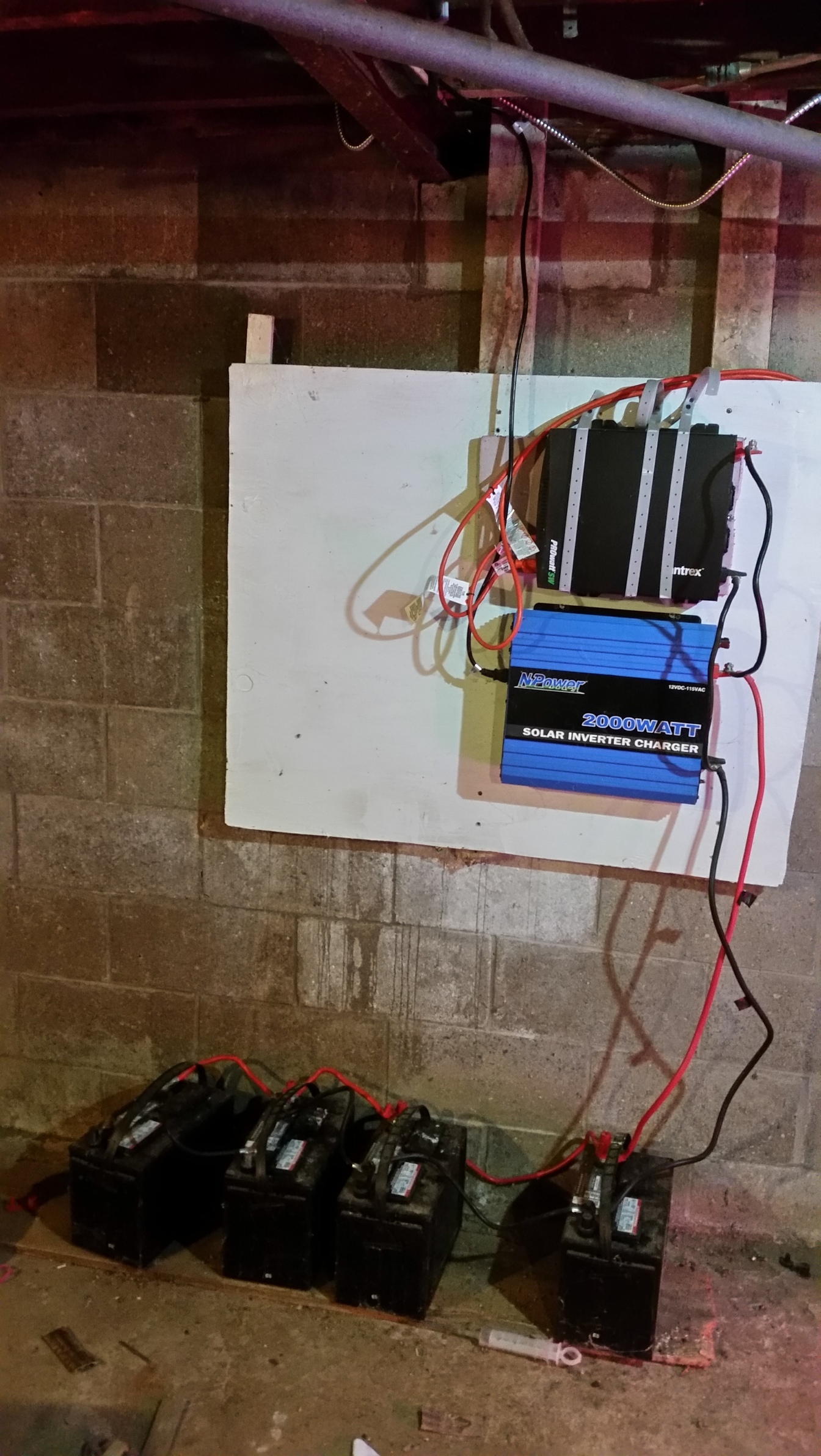

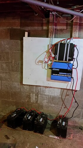

I rather like this uninterruptible power supply I have connected
to my TV and computer .blue is used as charger . It made noise on TV .
It probably has square wave output, thus noise. Inverters are in the huge price drop catagory as well. The better full sine wave invertors are cheaper and the modified sine wave inverters basically pushed the square waves ones out of the market.
If you want to run ac motors like your refrigerator get a full wave inverter the appliances will last alot longer. The square wave inverters are know to be hard on ac motors.
Square wave does burn up ac motors and can affect dc electronics that go through wall warts. Modified sine is more common in the low-end inverters now, but you want to check full sine is pushing into the upper end of low-end market as component prices drop.
If your system needs to pass inspection, the brakers now tequired will not work with square wave iinvertors. You must use true sine. Fred
Some thing to think about with full sine wave inverters is the electronics that control them are more fragile than the older square wave type. Know of one case where lightning didn’t hit the house but a close strike turned the wiring in the house into a giant radio antena. The surge backed into the inverter and fried a control board. Midnight Solar makes the best lightning arrester I have used and it probably would have saved it.

I had a samlex inverter it went out and I returner it to amazon and got a xantrex inverter both 2 Kw .
Samlex had fan run constantly .

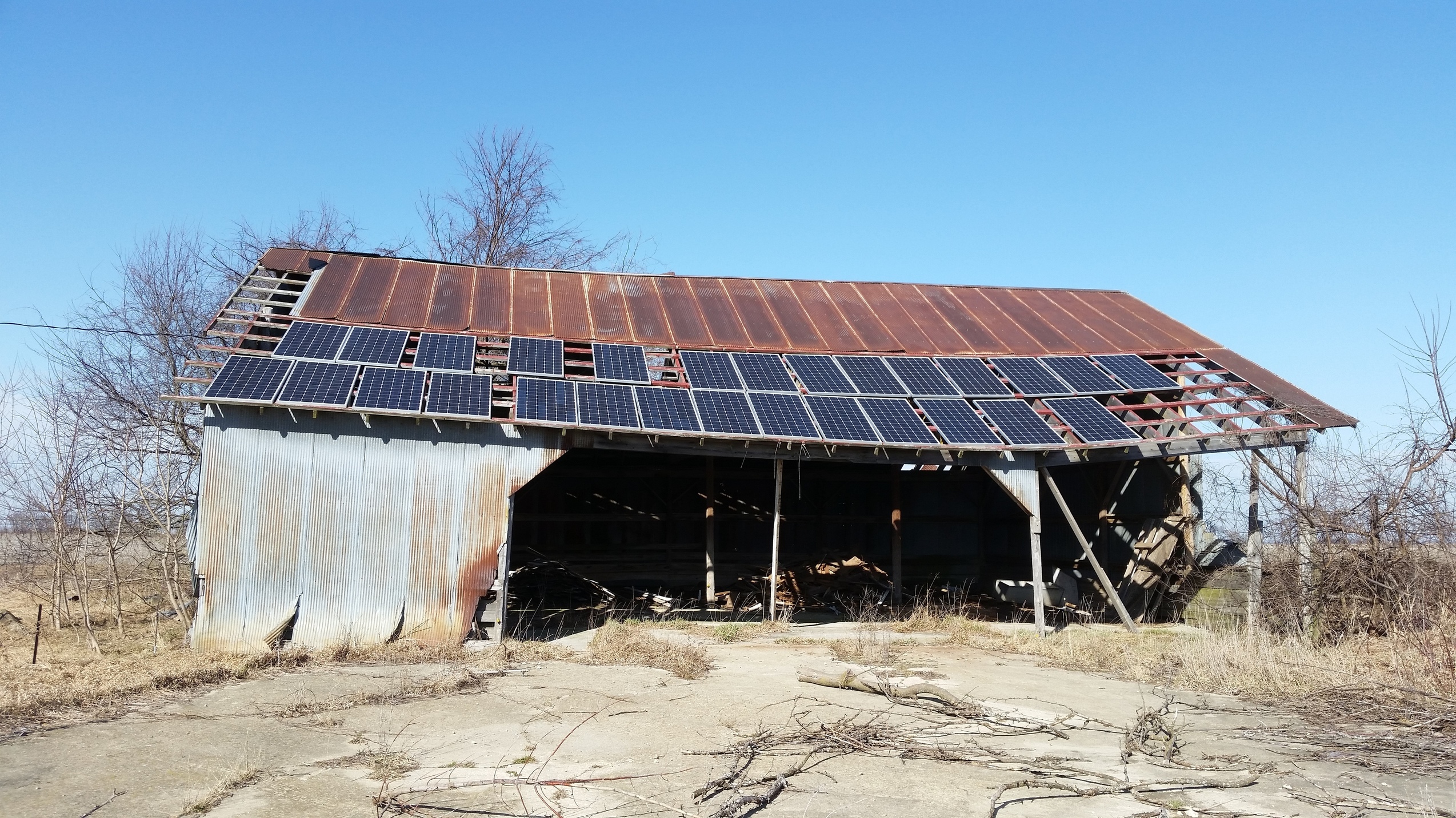

28 solar panels south facing shed 5 Kw grid tied . Not connected to back up power .
trojan batteries grid tied are not connected as back up power yet . Portable Diesel back up generator never needed .
Garage doors still not connected to back up power .
I like the solar panels but I would be a little concerned that the building they are on won’t last the 30 years the panels are rated for. I plan on putting a new roof up first here because I would hate to see my panels fall off the roof and get damaged.
