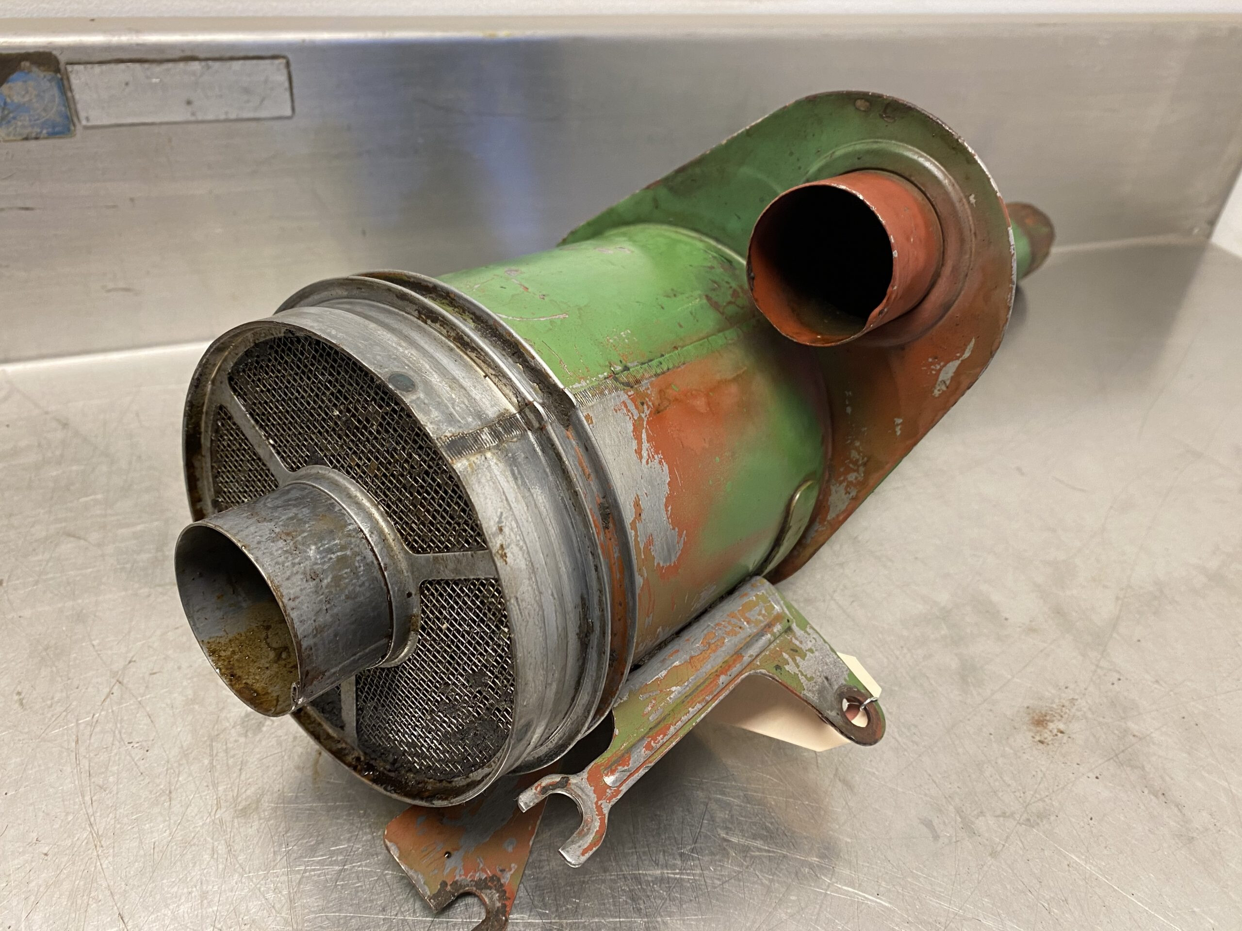

most of the oil bath tractor kind are kind of a 3 part filter system
inside you have steel mush oil and they kind of vortex
they are made for dust hence why they use them on tractors
my kind looks like this
the oil portion sits in a removable “cup”
from my understanding ait travels in the top into the oil though the mesh to the oval portion then kind of spins
perhaps this could be useful on other wood devices too many tractors used these in various sizes
this is one from a john deere twin so 2 of them might function well in a car type wood device
