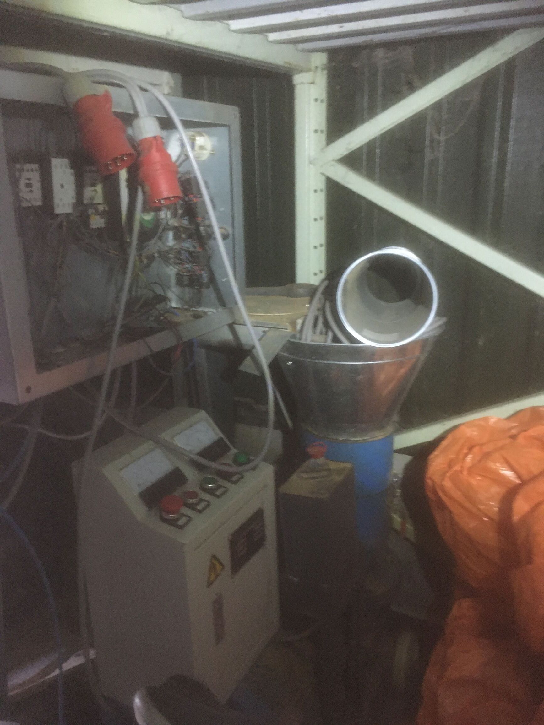

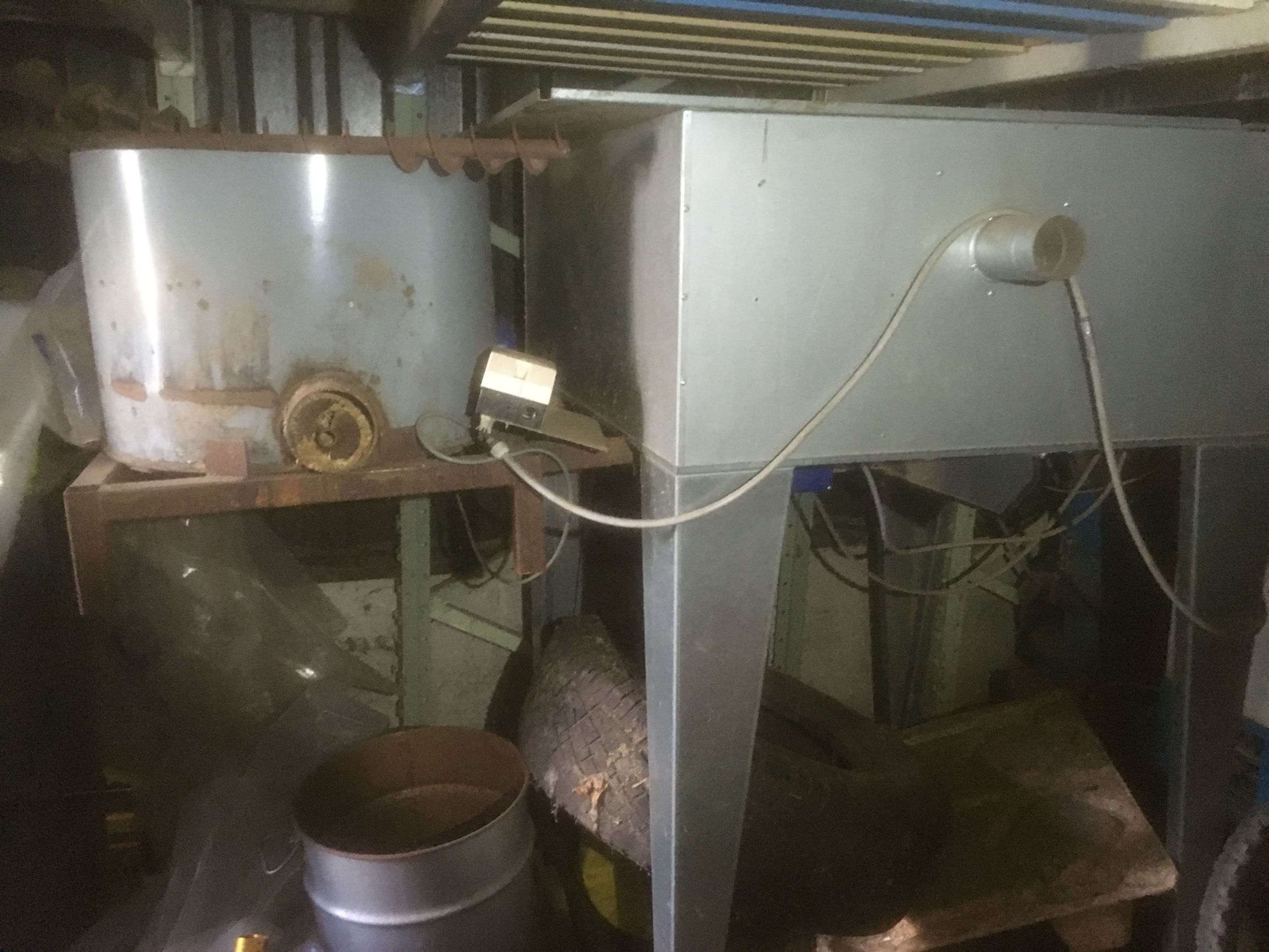

Maybe I will give this charcoalpellets a try. For the moment I am still searching wich way to go. And that is not making pellets from woodwaste. Here are some pictures. I gave it a serious try a few years ago and managed to keep the house warm with home pressed pellets. It gave a kick just like woodgas (I hope). But if you want to make pellets in a realistic way, the press has to be 22 kW as a absolute minimum. Otherwise you are just smashing time and money. This installation is 7,5 kW and delivers 75 kg/h. That means you save 15 dollar an hour if nothing breaks and power is for free.
Anyway, we had fun but now it is time to make room for the Lister genset.

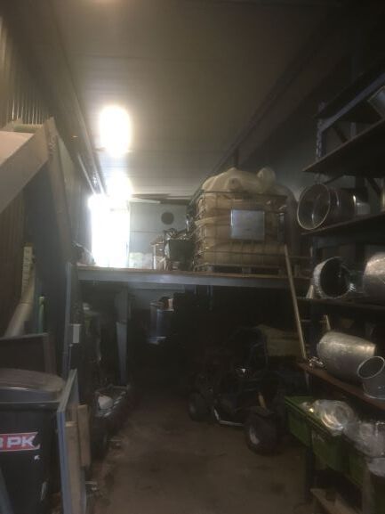

Bunkerbottom is square 6 foot and 12 feet high.
From here it goes to a hammermill 7.5 kW (it actual uses 3 kW or so) to get the right size for the pelletmill. Can’t find te mill at the moment but sawdust was dosed by the left round bunker. Dust flows over a magnet to capture metal. You dont want to be around if some falls in the mill!!!
From hammermill it is blow to a cyclone on top of the square dosingbunker and from there via a screw fed to the mill.
Speed is adjustable.
Water is fed by a hosepump with adjustable steppermotor. Sawdust is normally to dry when it leaves the factory.

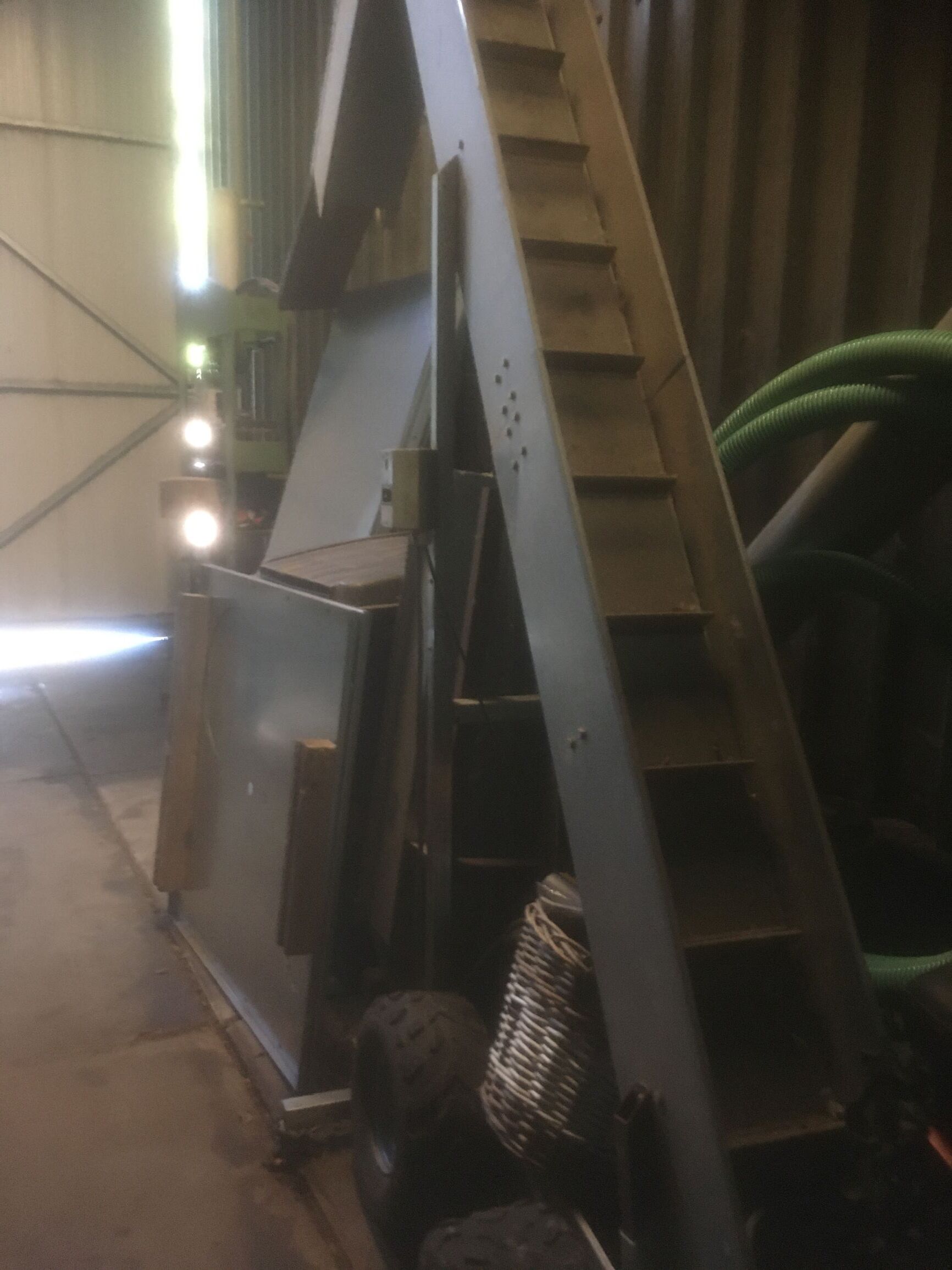

After the mill there is a shaker screen/transporter and warm pellets go up a conveyor.
After conveyor there is a last screen before pellets fall in a container.
So , I made my hands dirty making pellets and I think I am allowed to say it is a dead end road unless you go BIG. Not for home use unless you want to smash time and or money. But what the heck, it is allowed that a hobby cost money.
For the moment every thing is pushed aside to make room for a genset.
