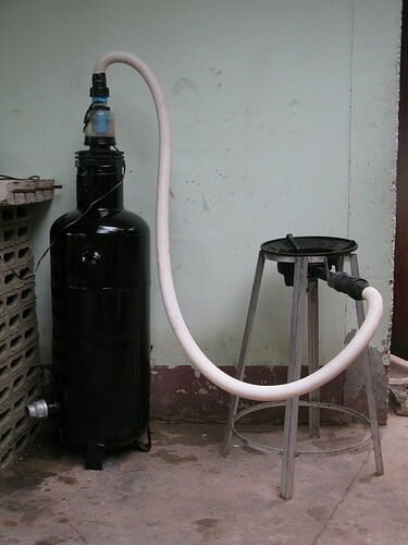

Thanks for the link and the video,
Yes that looks great, question remains for me, could we get that fuel into an engine in a easy way ?
Good thing could be; using this generated heat to gasify the charcoal ? then connect the outlet from the gasproduction to the engine …
The charcoal would be gasified without oxygen thus producing nearly pure Co ( external heated retort gasyfying )
Question would be, can we build it into a mobile device and drive with it ?
I will PM you to some contact i have in Italy, who will be very interested in your plans / idea.
Now, back to earth and our little starter project…
Any idea how big the diameter of the reactor can be ( in our case small ) for the same powers i use now ( the small engines and the Trike )
Thank you for supporting us in this.
Yes as stated by us in earlier postings, it is old knowledge but converting Co2 into Co can be done, thank you for this confirmation.
The whole setup is, as you described, to keep things simple and understandable, so we did build this converter accordingly.
As Marco already stated in another topic, this system would workable be it improveable with some new idea thinking from others.
I leave that to the other individuals.
I want to keep things so simple that a normal farmer here can build it and use it.
Nothing more then a 1 page explanation should do the trick.
I agree on your statement, “to been cut off a significant portion of your own personal energy” it sure triggers someone to build his own independent system.
These cut-off happen here so often, sometimes for days or weeks without pumping water…
Many times the farmer just have the choice; buy one portion of rice or buy a little fuel for his tractor ?
I want to give him knowledge, useable know how, to make his own fuel, for irrigation and for his needs…
That is what this project here in Thailand is about.
Giving that knowledge and no ROI

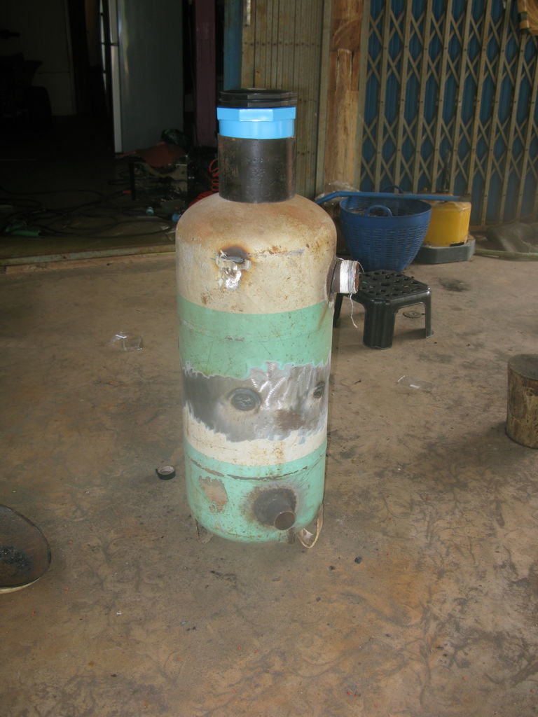

That looks tempting, but a little to far from the earth at this moment…
I want to start with igniting the plasma cutting torch near the charcoal we already use…
I know it would not be the most optimal, but we have to start somewhere…
I am going to use mom’s cooking reactor for starters…
inserting the nozzle from the side…
How much the molten slag is going to be ?
Will start testing, step by step to something usefull…
But will have to wait untill the Plasma cutting torch arrives

That is exactly the plan… gasify the charcoal, sublimate the carbon… and then test what we get…
Look at the temperature curve above… tell me what you see there…
I start with our first step, then, when i survive the first, i’ll proceed to the next levels…
This russian claims as above, i will test that…
Hello Koen, you need “soft” plasma torch and not an plasma cutter torch. But please test and after sent the results…
We can play with this torch. Adjust it, modify it… untill it works…
Endless fun…
