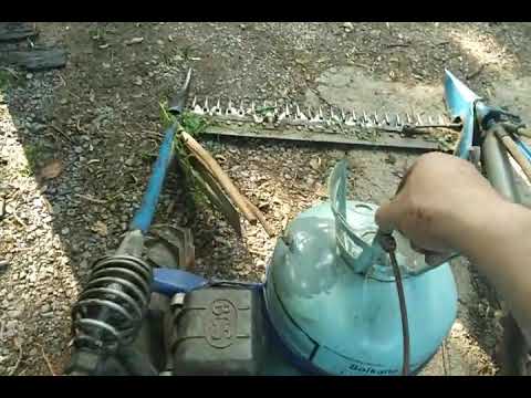

I hope Giorgio won’t mind if I add a video of my BCS lawnmower here, otherwise it’s not wood gas, but propane
Nice recycled LPG tank.
For years, you had me convinced you only used a scythe to mow. :slight_smile:
