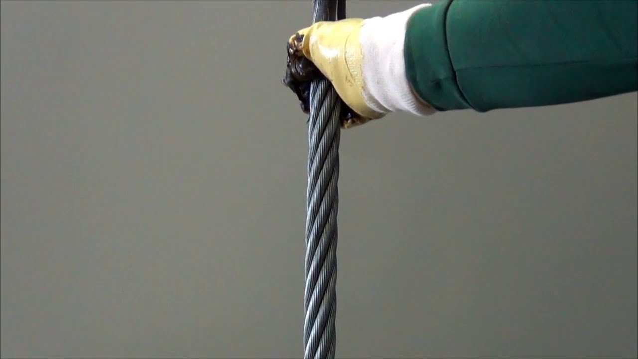

You want a tar like grease
The kind you would find on wire ropes
Normal soap grease is full of oils held in suspension and any thing you would add to that would wash away the oils and leave with a calcium or lithium soap
grease would work but it’s a nightmare for making a mess and it’s impossible to clean up after
You would be better off with filter oil because it is designed to be washed out of the filter so you can reuse the cloth
Video shows how much of a nightmare rope grease can be
Imagine you had some on your pants or shirt and then came in the house and sat in n your wife’s clean chairs
Or maybe it got mixed in the laundry and got on your wife’s clothing
Wifey would flay the skin from your hide and make sleep in the barn for a week
