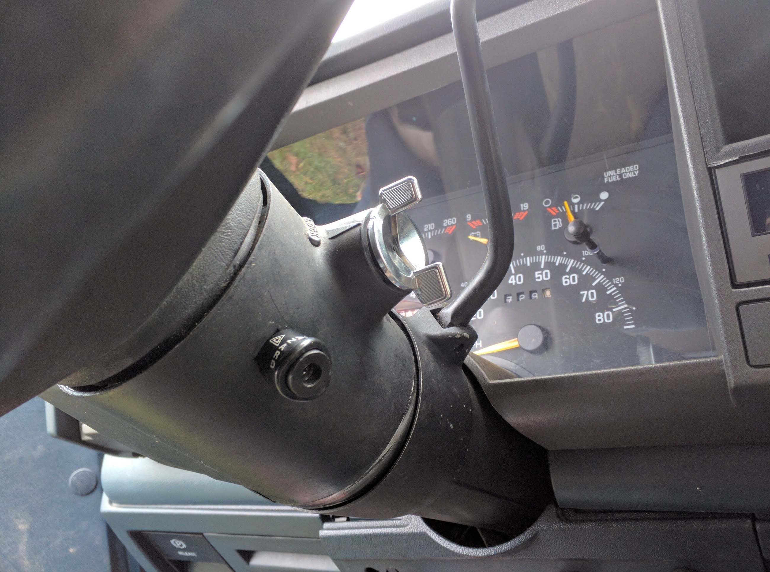

First order of business… ignition lock cylinder. Very common on old GM vehicles, either the key falls out, the barrel won’t turn from “Lock”, or both in this case… A new one is $15 and installs in about half an hour. Works great now.
Now you can get started. :smiley:
It is always a good sign when people pay attention to the small details it proves you will fix it right.

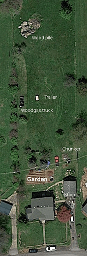

Very nice, Chris, glad to see it up and running. Thanks for a tour of the neighborhood. I did a street view thing way back but could’nt tell if you were right on the corner or not, now I know.
Pepe
I think your block drive a rounds are like mine about 5 miles. But here it’s 5 miles to work but 40 home too. Good on ya

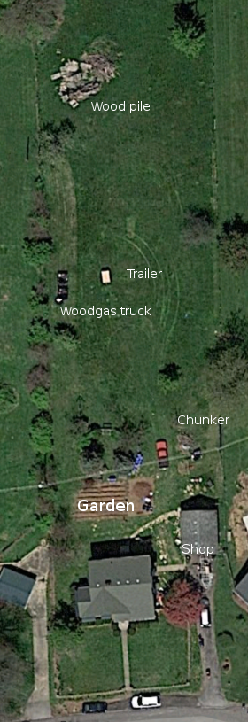

The satellite view captures my various projects quite well… This is from spring 2015 (click to expand).

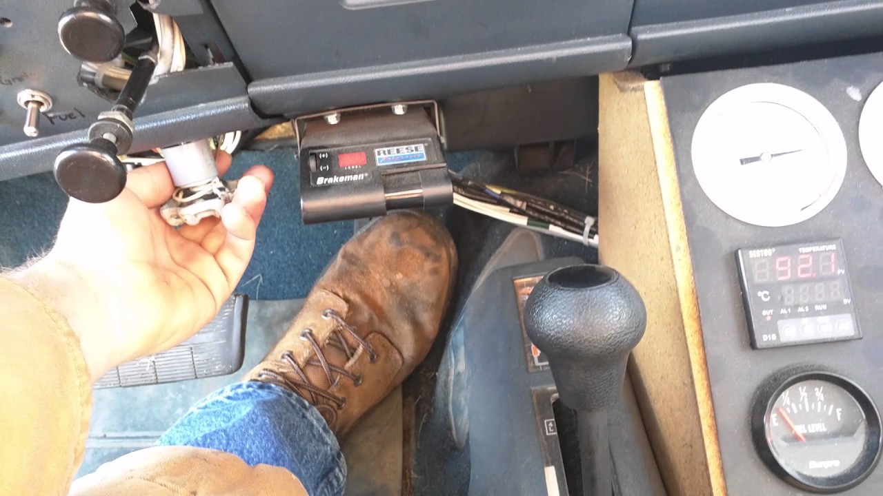

I forgot you said the transmission was iffy. I would have never thought you could rent a truck and make that trip for that kind of money. Good job. The temperature gauges you recommended— I didn’t see any dimensions on them. And is the one reading C and the other F or will it read two thermocouples with one meter?? I understand that if something falls in your lap, you need to grab it and run. I to often, timidly reach for it while looking around and someone else snatches it out of my hands.TomC
Dimension is a standard size, 1/16 DIN. Fits a 1 7/8" square hole, 3 1/4" deep. Each gauge will read either C or F, single thermocouple. The other number is a programmable set point, we can safely ignore that for our purposes.
