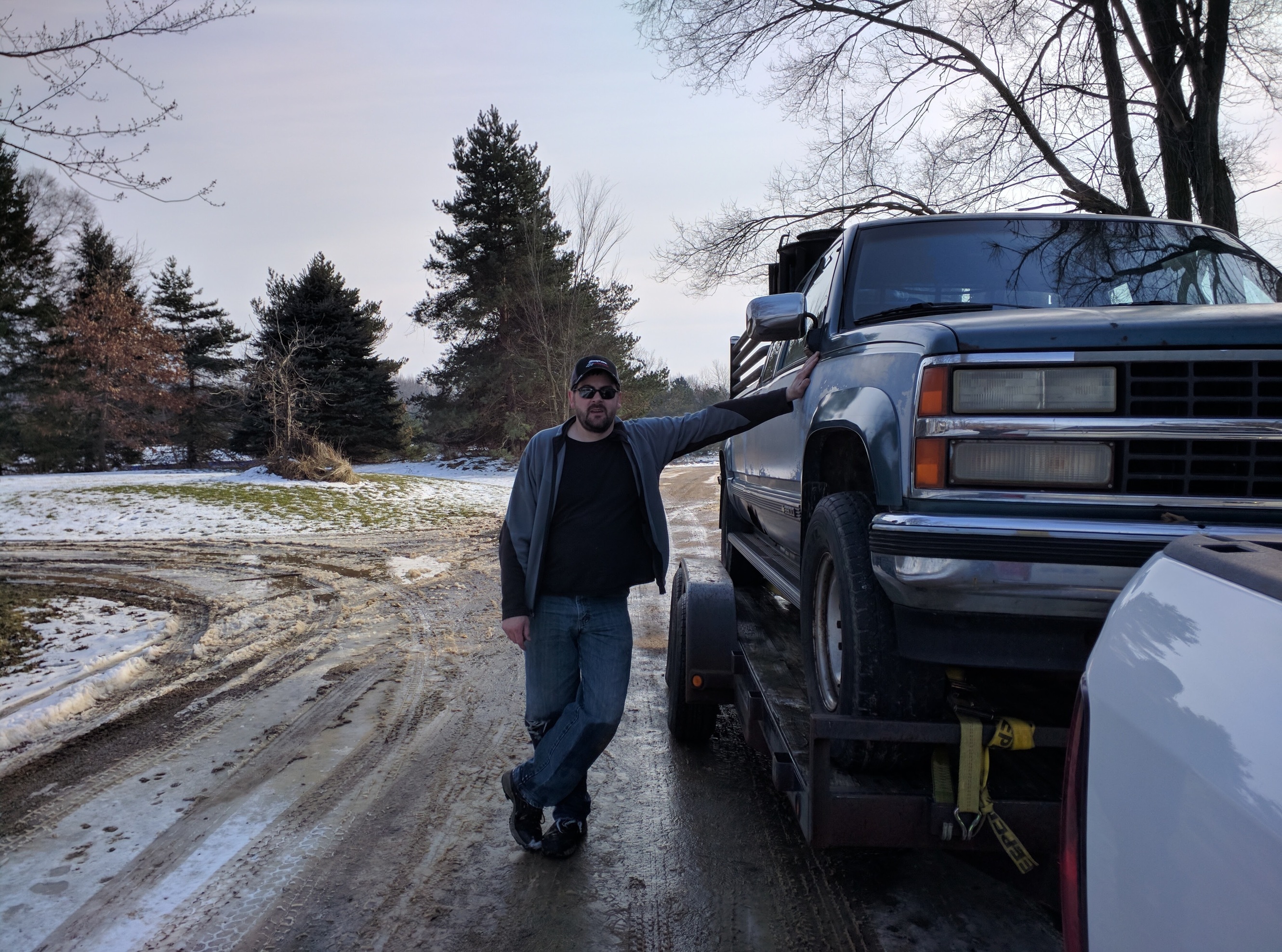

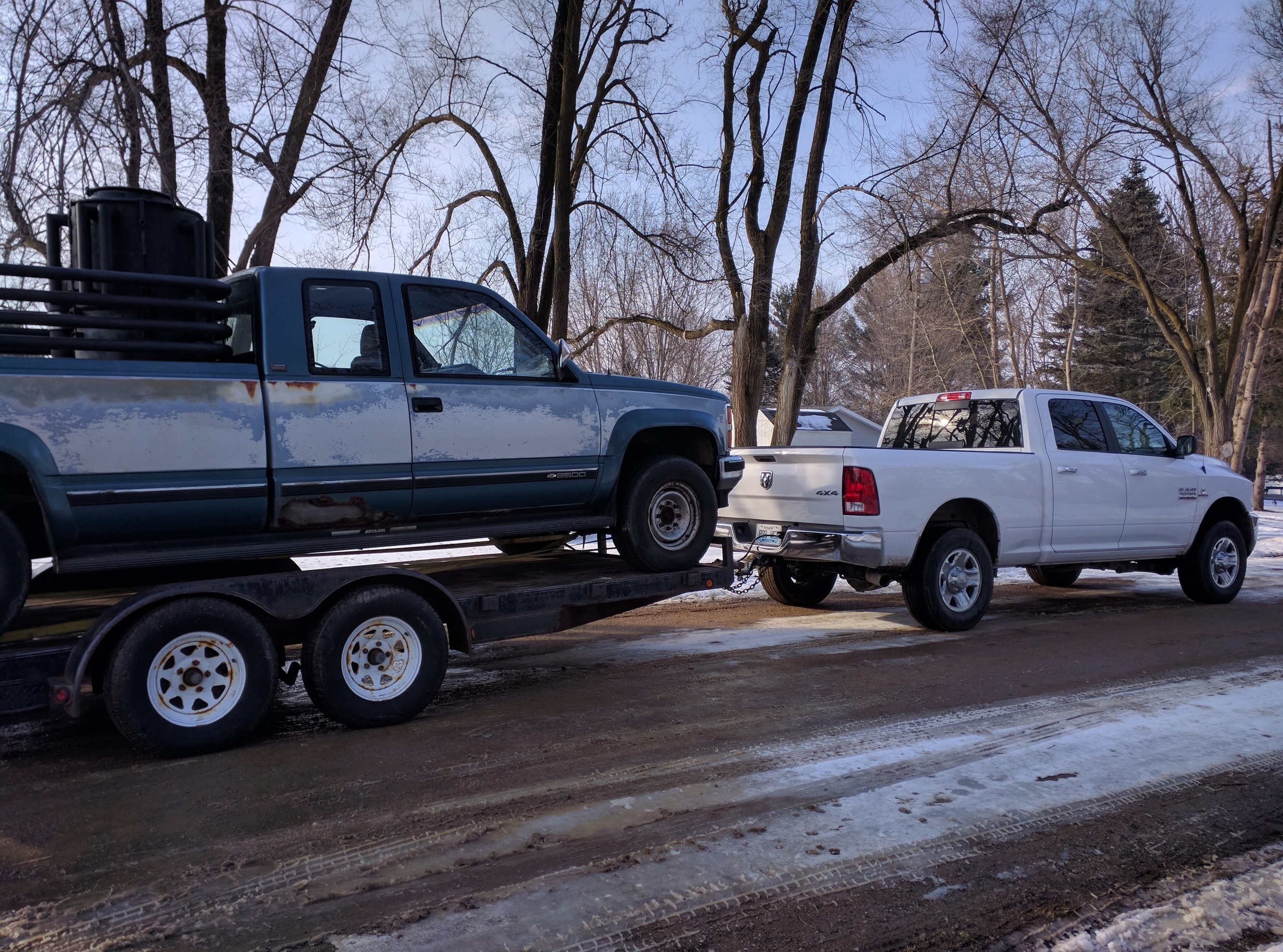

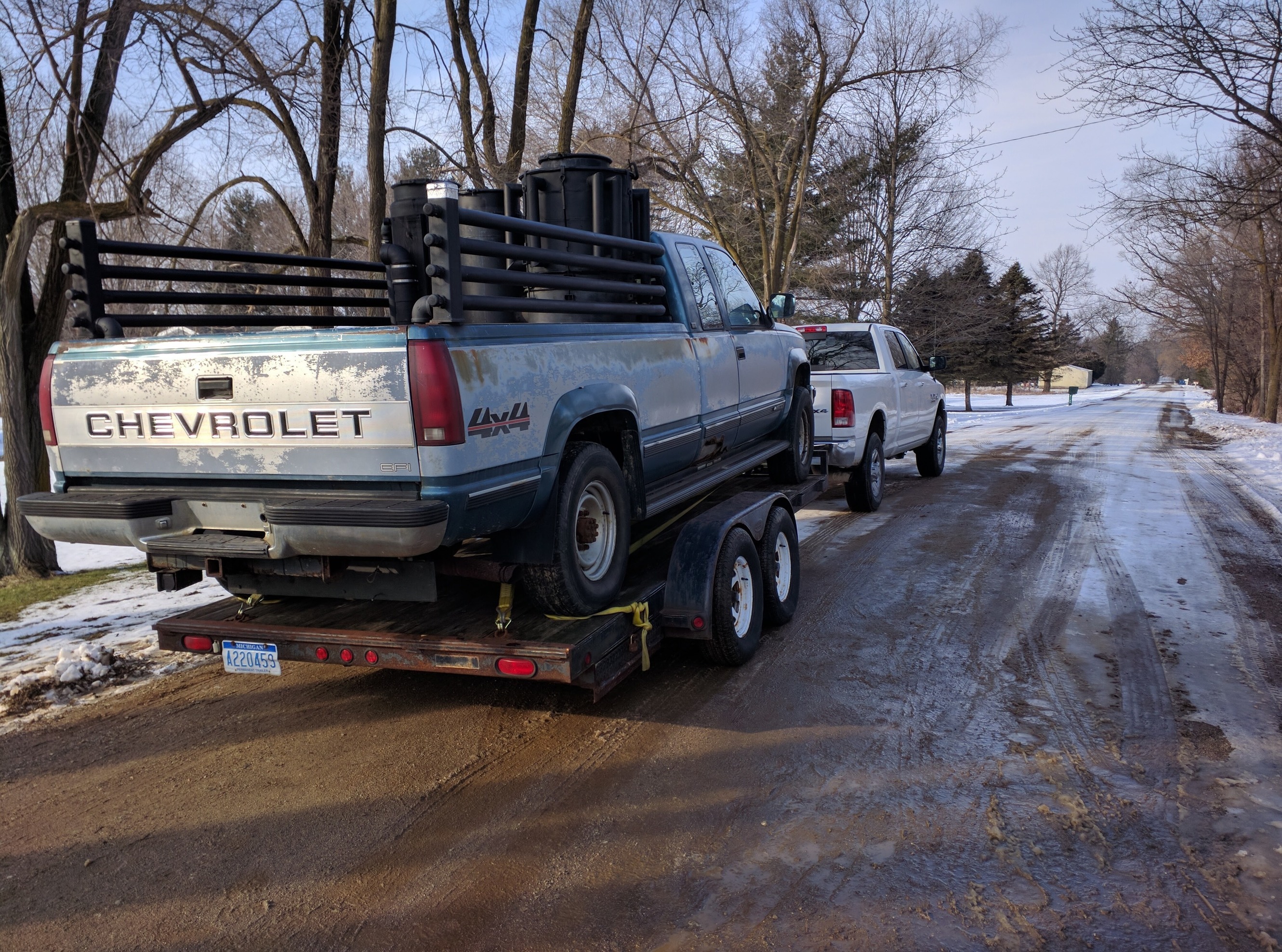

Home safe and sound. Here’s more pics from yesterday.
