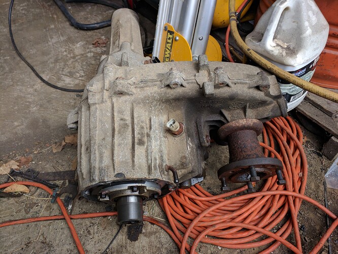

Transfer case:

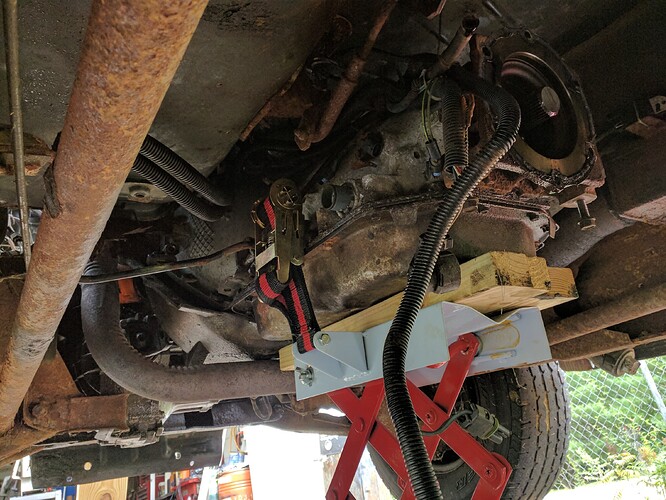

Last couple of bolts:

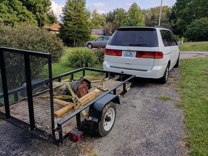

Loaded and ready to go:
Note the 2x4 sections screwed to the plywood floor. Excellent bracing!
Yes I’m using a trailer behind a minivan… It’s a bit disconcerting, but I have no other way to haul things right now! I want my truck back.

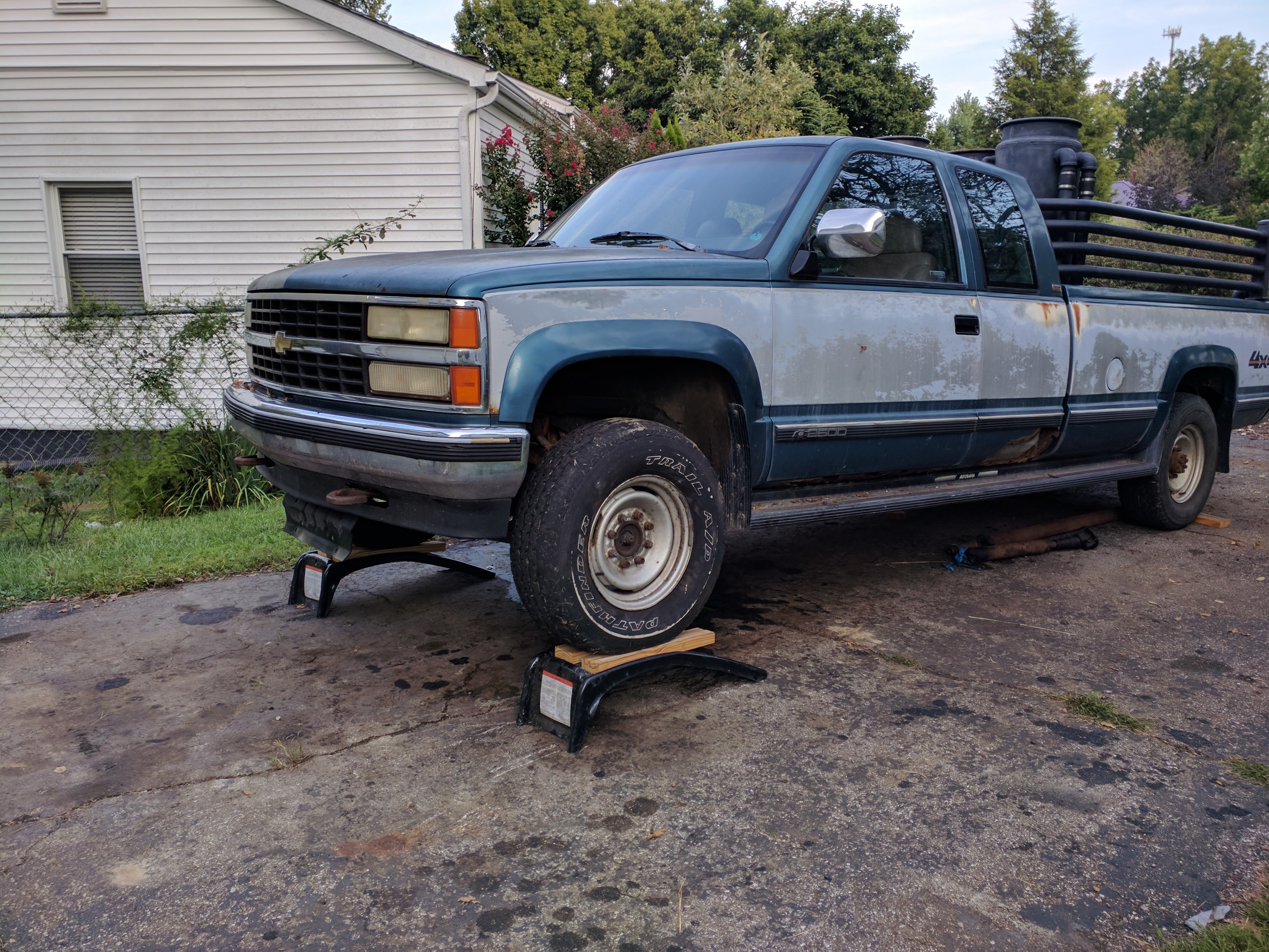

Part of the problem of working on this has been getting the truck high up in the air, in my driveway. This is a very heavy 454 in a full size Chevy. Without a lift, your options are pretty limited. So, it sat.
