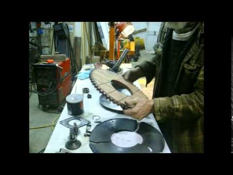

I finished the chunker and the shop was a little lonely, so it’s time for a new clutch in the ole cat. Just so used guys don’t think all I do is lay around and do nothing, here are a few pic’s of moving it in the shop today.

Hey BillSchiller, made this vid. just for you, “not” but I did show you what a fish plate looks like, so hope it helps you out in the future! I did get the clutch put in and will make a short vid. tomorrow showing it done. Then off to the pony motor R&R, hope I can find the right parts.

Got another video up for those of you that are interested. No problems with installing the new clutch, but did find 4 bad seals,more things to fix.

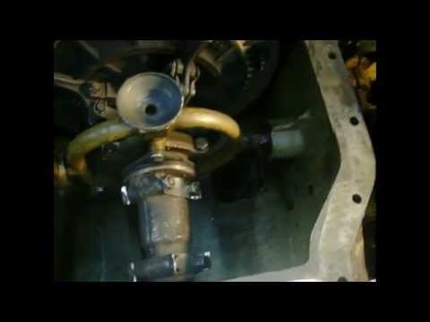

This is what I found, two bad bearings on the left side finial pinion shaft. The big bearing was $250 at Cat, I got it for $100.
This is the seal that made me tear the rear end out. Now that I have it apart I will do both sides.
