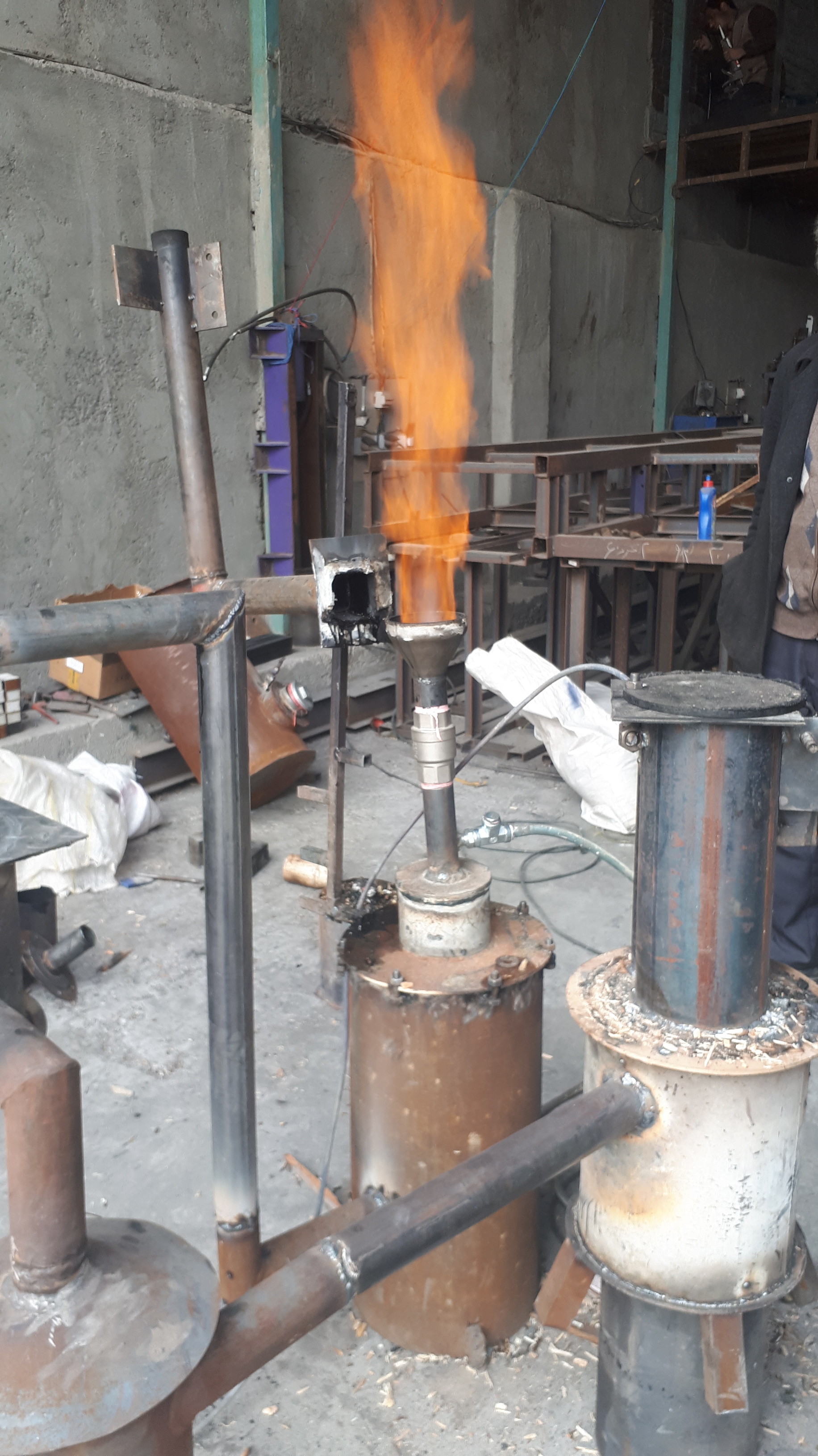

I was busy with making a new gasifier,this week.
The new gasifier is excellen.
I made it with kristijan’s help and map
This system works by air compressor.
Allright Saman!
This is a healthy flare! I bet you are pleased.

Thank you kristijam,it was yor plan :clap:
I have good air and fuel preheater.
But it has big problem :slightly_frowning_face:it need shaker.
Ypu can see in my video,how i shake it

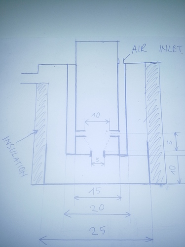

This is kristijan’s plan.and my gasifier
