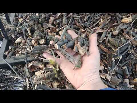

This chunker looks so easy to make compared to other types. Has anyone used something like this to feed a gasifier?
@Tone don’t you have an auger type chipper?

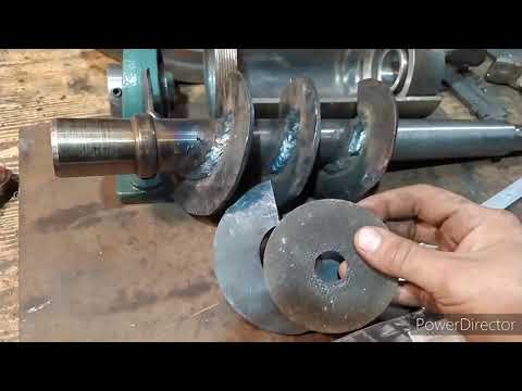

Cody, it’s true, I make fuel with a screw cutter, … it cuts up to 8 cm thick, but I intend to make a bigger one up to 20 cm thick
I’m really glad you found that. :slight_smile: That is my favorite style of chunker since it has built in autofeed and lower HP requirements, and anything bigger goes to the firewood pile. Although I think I will try to figure out how to add a safety bar to it to kick it out of gear. chunking up wood isn’t worth risking losing a hand.
@Tone since you are the resident genius of these. Is that just a cast steel waterpipe for the tube? And how do you harden the edges? It looks like he used mild steel in the video for the auger flights.

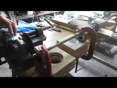

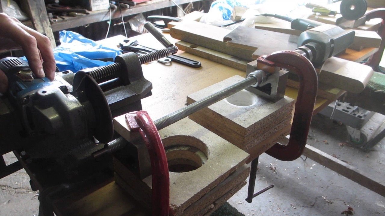

This will be a PITA, but there is a workaround. Search: centerless grinding
just take a design using pipe, and put the hardened steel rod down the middle. The purpose is solely to prevent the flexing of the pipe (I could pour cement or abs plastic down the middle, but I don’t think I would get the same strength) The only drawback I see right at this moment is the torque might twist the pipe.
That video rocks. I don’t think I have never seen a video that used the vice to hold the grinder that makes it simpler even though it is all pretty sketchy using the clamps to hold it.. lol
