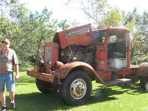

John Deere had ‘pony’ motors that were used for starting their bigger diesel tractors. Basically, you started up the pony, it heated up the diesel fuel, and it cranked the diesel engine. Alternatively, you could start a small tractor, and attach a belt to it. I think they had an electric start option but they were finicky enough it was common to drain the battery, and not get them started which of course meant the batteries deteriorated quickly. You could hand crank them, but you basically had to be an ox because they could take a minute of cranking to get started.

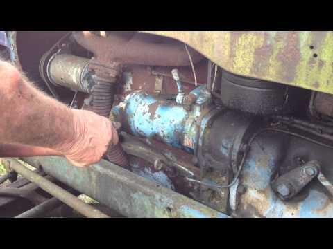

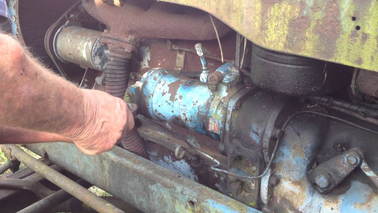

There are good solutions,…
https://www.ipu.co.uk/products/spring-starters/
wow, tone, very interesting!
this would be a good solution for my hanomag …5,2 liter engine…otherwise needs always 2 batteries…would be nice to find a used starter in this way…new is expensive, i think…

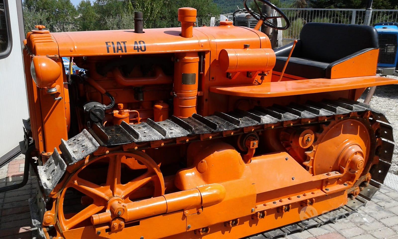

https://www.agriaffaires.it/usato/trattori-epoca/11618061/fiat-40boghetto.html
my son found this foto …we spoke about diesel start without glow plugs…
this traktor is obviously a diesel, and seems have also spark plugs…as starting help??
who can explain…
on this foto is to see the tractor has hand crank…
Georgio some American equipment manufacrturers did develop starting on gasoline with spark. Then after engine fully warmed up switching to diesel fuel for working.
Thus gave better really cold weather starting.
International Harvester Corporation was the most well know, doing this.
Complex system with in their cylinder heads with a for-gasoline compression reducing sub-chamber and a mechanical mechanism to close that off, disable the sparks for higher compression diesel operating.
“I think” your FIAT is this starting/warming up, on gasoline system.
