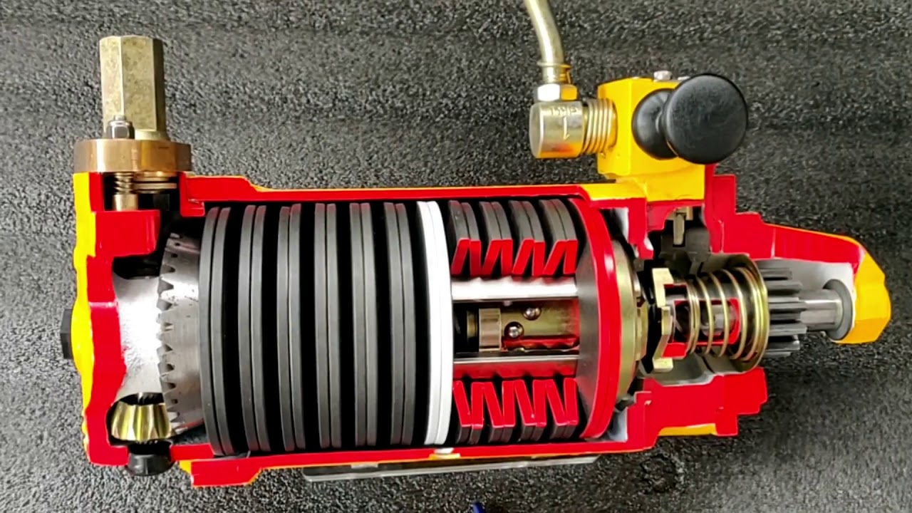

If I understand correctly, this tractor model has a dual-fuel engine, it can work as a diesel engine or as a gasoline engine with spark plug ignition, this method is also for starting the engine itself, since manually starting a cold diesel engine is impossible.

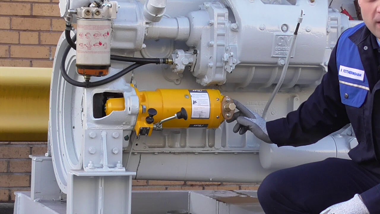

found a page with the spring starter…price is heavy though…

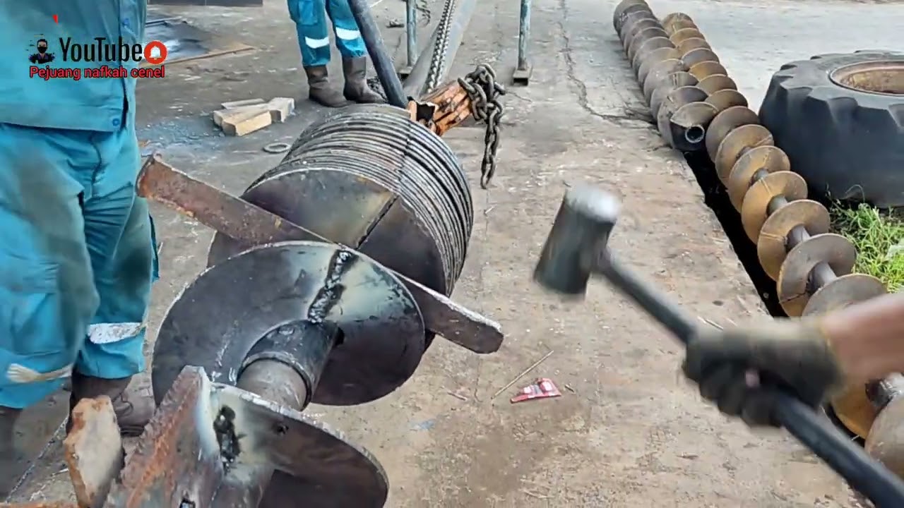

I came across interesting video on YouTube. Guys making conveyor screw. Maybe some inspiration.
I found this today, really got me inspired to start building one.

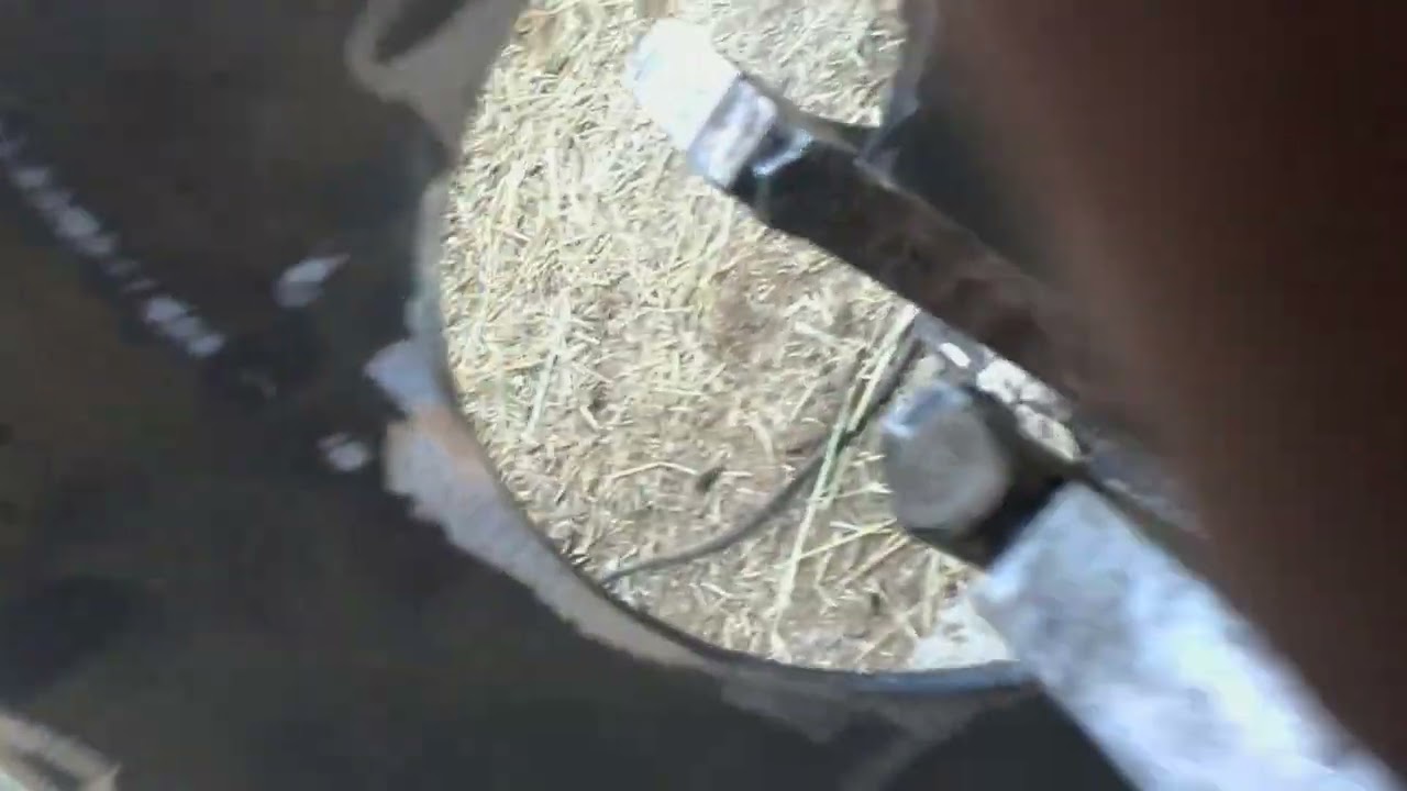

Very good video as it first shows the machine working. Then ends showing the machine working. This system able to self feed right down to the wide spread twiggy ends. No pre-stripping prepping needed.

The heat from the welding may warp the shaft a little, so maybe it would be better to recut the flights on the lathe after they are welded. Also probably better to recut the surfaces where the inner bearing races contact the shaft after the flights are welded to the shaft.
Hi Chris, I don’t suppose you have had time to work on your screw chunker until you get the head gasket fixed on your Dakota, but how are you planning on bending the flights? I have been doing a lot of research, and I think I am going to build some like this:
It seems to be the simplest way I have found and looks pretty easy to make. I am using a 2" shaft I found with 10" flights. I am thinking 2 1/2" spacing between the flights. I agree with Rindert on re-cutting the flights after they are welded to the shaft, but I still might partially bevel the edges on the lathe beforehand, just to save on the grinding.
GC
Many ways to skin a cat, as they say. This guy’s seemed easiest to me.
