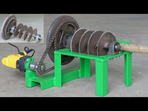

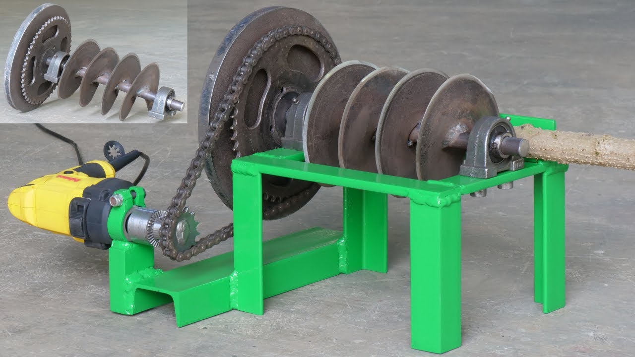

Here is a small screw chunker driven with a drill. It looks like a motorcycle gear and chain, then like 8" discs, but they only look like maybe an 1/8" thick, and a flywheel.
The person I guess was from India. I think it is funny, because The rest of the machine is so overbuilt, for a drill to power it, then they cheaped on the flights. The feed angle is also to narrow. ![]()

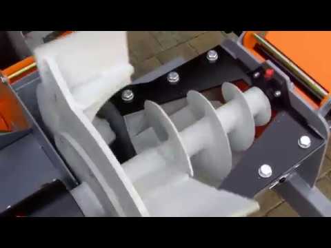

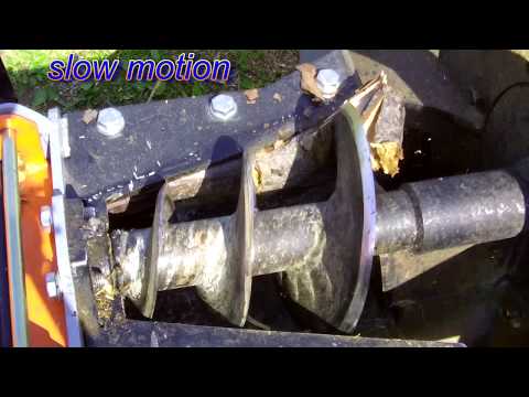

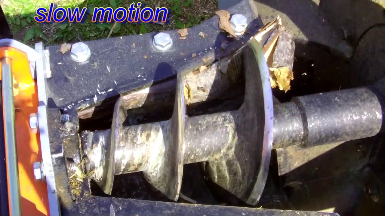

I was visiting my friend Boštjan, maybe you still remember the pictures of the old truck that stood in the bushes for 30 years, Boštjan used an engine with a gearbox to drive a screw chopper up to 120 mm wood thickness, there is nothing better than using an old reliable air-cooled engine without unnecessary electronics for such work.
120mm. I had to look it up. Almost 5 inches. I’m surprised by how small the shaft out of the trans seems to be for that kind of necessary torque.
Any more specifics on the screw? How thick of material were the flights made out of?
Yup, screw chunkers just use less torque. They are actually more efficient and feedback a lot less vibration through the pto.
Hello Chris, the cutting screw is made of hardox material with a thickness of 10 mm, the rear largest diameter is approx. 30 cm, the flywheel is approx. 80 cm in diameter and 30 mm thick. This screw cutter is much larger than mine and much more massively made.
