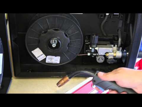

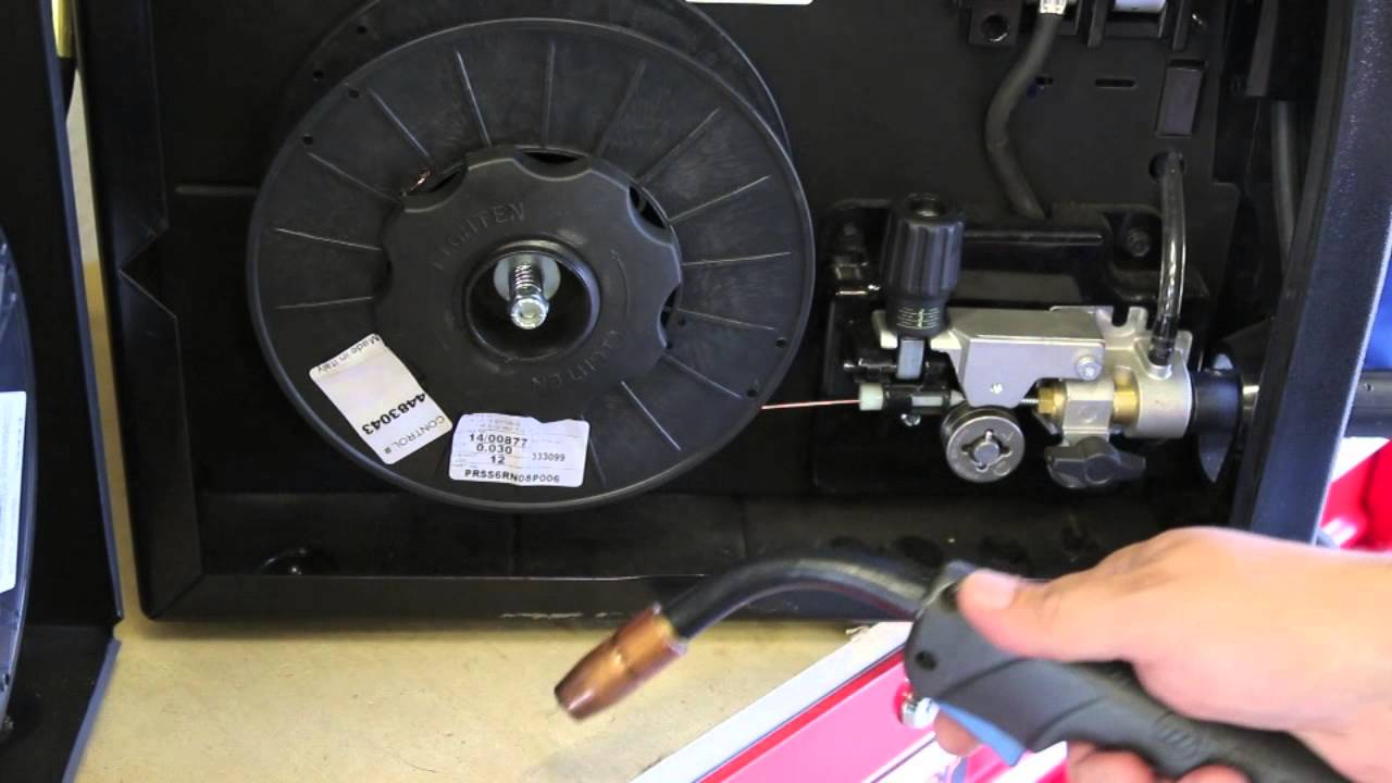

HELLO DON MANNS, Trying too weld with gas,I bought 4 -10#rolls of 0.23 solid wire, I thought i did change the polarity correctly,I got too recheck,then useing my meter check for ac bleeding past the diodes, there will be some ,but not sure what is a tollerable emount yet.from the diodes too see if diodes are melting down,i heard you can loose power from faulty diode bridge,so i check that too, It has done nothing but pop since i changed polarity and wire,THANKS

Thanks pete that looks like a good wire feed testing, i may have too get a smaller tip,my tip is for 030 or 035 wire and my wire is 023,and yes that did help tunning the tention on the were feed and roll of wire Thanks again pete ,and allso Yom C.The other half my problem is my cheap weldere and like mr. al frick was saying ,i beleive i need some no ox greas too keep the main 220 wires from corodeing,as i pulled the wires last night moveing the brakers over one notch,i seen the corrosion on the wires that get screwed too the brakers,a bad layer of the whitish ox corrosion,that can cause power fade while welding.THANKS AND BACK TOO MY chicargo electric pop corn poper mig till i get a real welder.If i dial it in it barely welds without the poping.At least it welds for some welds,i woulent want too use it on the heat exchanger outer ,as it might extract leaks over time with the poping areas.
Thanks Pepe; I watched many hours of YOu tube trying to figure out my problem. He did not hit upon my problem of having too long of and extension cord to the welder. But he sure hit on all the other subjects and many that I have not seen such as “tensions”. I knew they were important by what to set them at was a mystery. I don’t care how long you have welded, watching these four productions will teach you a little something. And if you have a problem go to the net and find the welder manufacture’s weld sight. It takes a little doing but some where there is a “technical support” telephone number. The tech I talked to did not find my problem right away, but we kept talking and discussing and bang, he hit my problem. Thanks again PepeTomC
