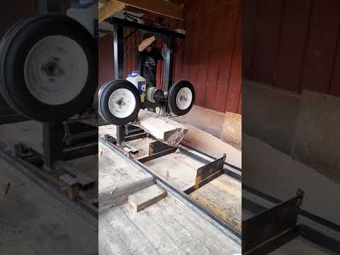

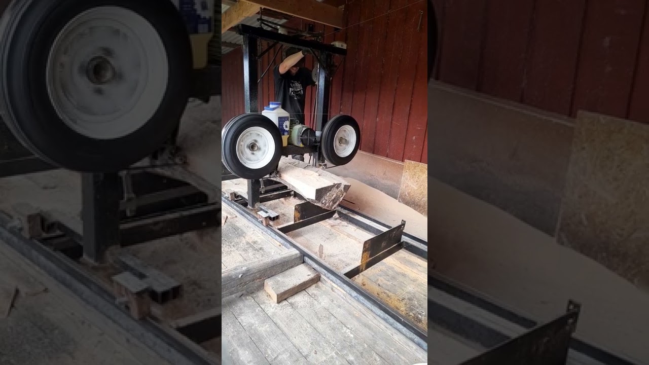

Sawed a lot of 14 and 16 inch boards but have to slow down a little . The blade I was using on this 16 incher has hit three nails. I reshaped but will put another on before I saw anymore which may be the first of next week . :slightly_smiling_face:
Your mill cuts way faster than mine. I think it would take me at least five minutes to get through that log. Can’t say for sure because I’ve never cut 16 inches. Plus I am always cutting dried logs.
Thanks for the movie Wayne.
Do you know the speed of your bandsaw blade?
Good morning Jan .
A very ,very rough estimate is 5,000 feet per min..
Thanks Wayne.
I think I have about 4200ft, but the motor is only 3kw, a bit too bad for wider boards.
