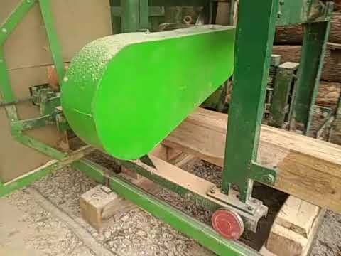

testing the saw

Hello Tone . Thanks for the video , looks like you have it going your way.

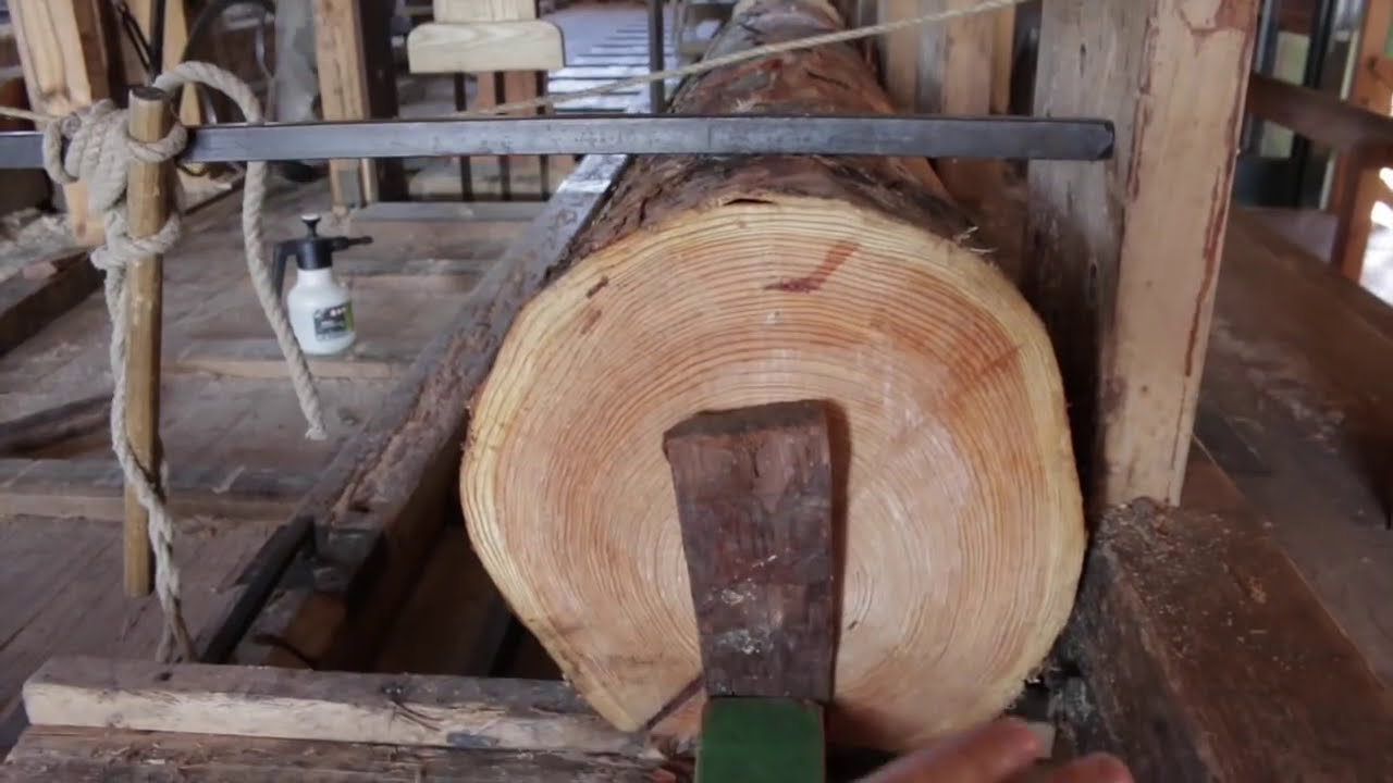

The wife usually off bears for me but she complained about these 4 inch X 12 inch beams .
We came up with something to help a little and save on the back :blush:
Mr. Wayne, I love simple solutions, you make everything look so easy, but I know that working on a saw is not easy, let alone easy, all the wood goes through your hands many times. :+1:
:smiley::smiley::smiley: Who isnt strong has to be smart! I use the same method some times and it still surprises me how easy it rolls no mather the load.

So, your carriage is self powered? I have to push mine by hand. I also push wedges just behind the kerf to lessen any friction on the blade, plus I feed a lot of water on the blade to keep it cool. One of these days I’m going to saw a fresh log. That is a nice machine Tone. Well worth the price.

Something doesn’t sound right . Maybe not enough set on the teeth . The body of the blade should not be in contact with the wood , only the teeth.
I have never had a blade to get hot even without water.
I do drip soapy water on my blade but to keep sap from forming on it .
I’m sure you are right Wayne. I’m a pretty inexperienced Sawyer. I only saw maybe a few hundred board foot a year when I have a need for wood and sometimes none at all. It’s all older Ash that has been standing dead for quite a while now. Just starting to gather up some Maple logs. I just built the thing as another path to being self sufficient. I usually put the Riving Knife on my table saws and I figured the wedges would act the same way. I just read somewhere that watering the blade was a good thing and it’s free. It has been recommended to me to soak the logs somehow before I cut them but that seems like a whole lot of messing around but anyone who says and old dog can’t learn new tricks is wrong.
Hi Tom,
It is pretty important to have the right amount of set in the blades. There is a lot of valuable information on The Forestry Forum. My reading and experience is that there should be 50% air and 50% sawdust spilling off the gullet of the blade to stabilize and cool the blade in the kerf. If there is not enough set it shows up as hard packed dust on the boards. I am always feeling the exit sawdust and if it is cool and crumbly everything is good but as the blade gets dull it will be warm and fine dust or real stringy. I set more for soft wood and less for hardwoods. Wet logs saw better which is why they had log ponds. I never use water but should to keep the blade cooler. I read somewhere that blade tip temperature reaches 700 degrees but haven’t confirmed that. For pitchy logs I give the blade a squirt of 50% diesel and 50% chain oil and it helps. My two cents.
