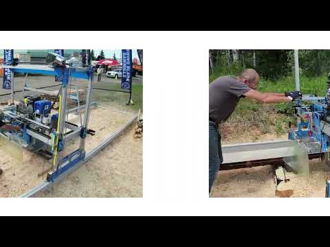

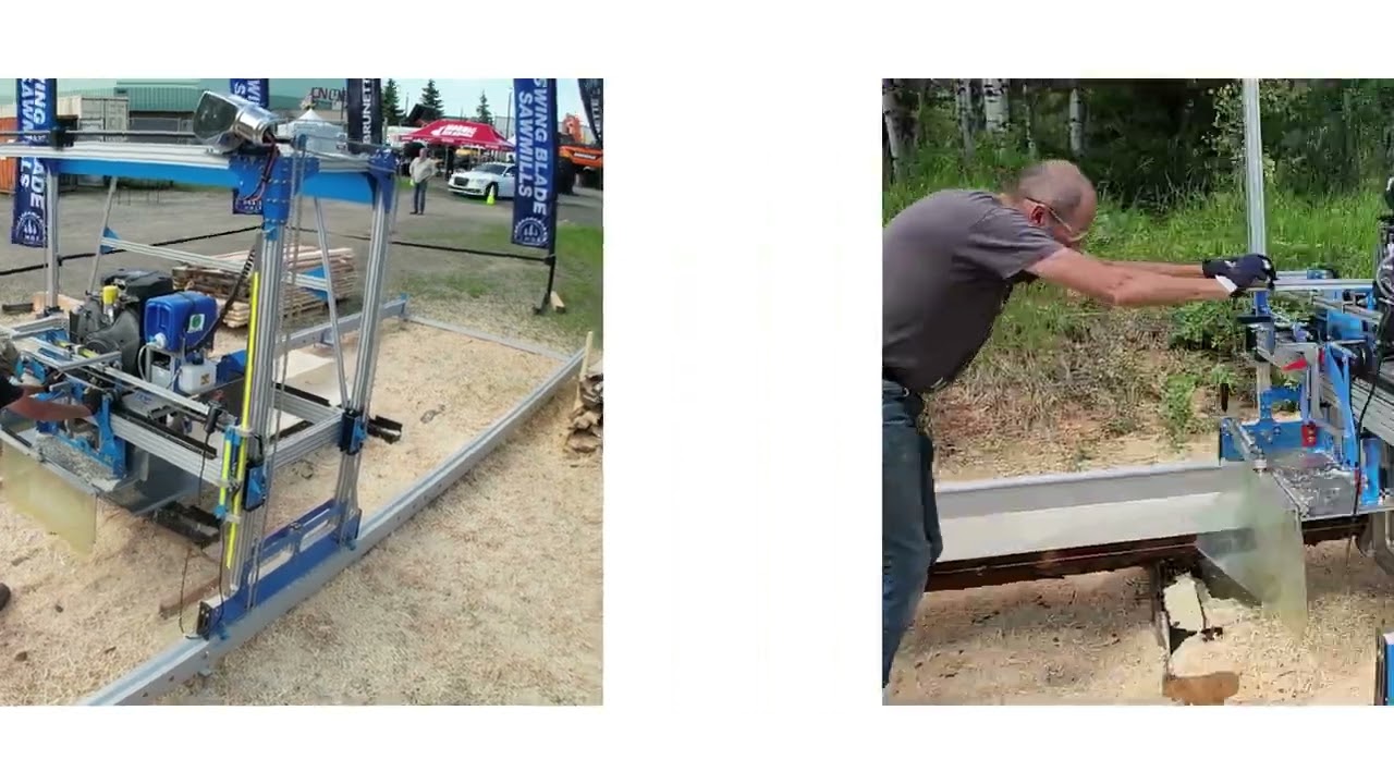

Back when in 2007 when I searched out and bought my 3rd hand used Peterson swing blade mill I was only aware of Petersons and Lucas’s.
Ha! If I’d waited a bit until D & L regional to me came out with their new light weight portable . . .
D & L’'s swing both ways for a true 180 degrees; with angle set points in between.
Just how they do that?? I’ve been watching videos:
Lots of ideas from these to emulate for a one-off, DIY mill.
Watch carefully.
Watch for the years spread, time-lapsed changes.
That D&L 180 swingblade had a lot of nice features, it would be appreciated here on the farm but there is no justifying a new saw when there already is a saw here no matter the bells and whistles. Even the time that goes in to building one is not really justified but it doesn’t stop me from wanting one though.

My two cents. A lot depends on the size of logs that you have/ can get. The Mobile Dimensional / Mighty Mite/ Mahoe Mill is similar to the various swingblade mills in that they shine with the bigger heavier logs that can not be moved easily. The bandsaw mills work best at 6 inch to 24 inch tops. Big enough to get reasonable production but small enough to handle with smaller equipment. Anything bigger than 32 inches I tend to rip with the chainsaw to handle easier. Chainsaw mills are the cheapest but usually best for cutting big planks and timbers. I usually cut with a skip tooth full chisel chain and had lots of ripple in boards and heard that the round over teeth ( can’t remember the proper term ) work better for ripping. A near new bar and a razor sharp chain and a light touch to keep the revs up and make sure the oiler is working well. Lots of gas and sawdust. I love my bandsaw mill but it was a learning curve to cut accurate lumber.
How is your house coming along Darrell? Been a while since you mentioned it.
True in my case. Still, my mill payed for itself within the first dussin of logs - not counting my own time of course.
What type of mill to choose? As always, it depends.
As I see it the swingblade mill has a couple advantages.
No1 - log handling. You just roll the log in once - no more wrestling until all that’s left is the bottom slab. Size and weight of the log is almost irrelivant.
No2 - easy and fast sharpening. Most swingblades have only 5 or 6 teeth.
No3 - Edging is done automaticly as you go.
No4 - Easy quarter sawing (if you’re into that).
Downsides.
No1 - Really wide boards are time consuming to make. With horisontal double-cutting you have to do more than twice the number of passes. Also, the board width is limited to the blade diameter minus the axle.
No2 - the fabrication gets more complicated if you’re unable to go electric. A non tiltable gas engine requires a 90 degree gearbox and the sawhead gets heavy and bulky.

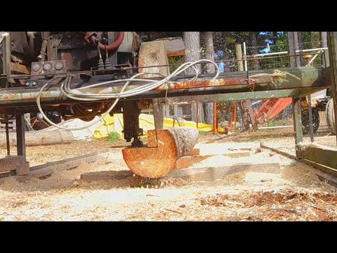

Here is a D.I.Y. made dual-blade system. Watch his loving pre-sawing care (he’d be an excellent woodgas system operator). His blades have insertable teeth. Wider kerf-cut. More sawn chips and strands made.
Watch that he produces a fully cut board with each forwards pass. Then can do another board cut coming backwards if he wishes, sometimes.
Four post saw carriage. Carriage up and down. Engine and saws platform moves left and right.
The fast of a two blade system sacrifices some of the able to do the speciality cuts possible of a single swing blade.

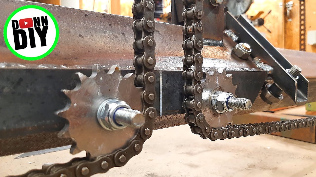

I just wanted to highlight a bit of Wayne’s ingenuity and math skills here. If you watch his video showing the sawmill details, he goes over how he measures and raises/lowers the saw head, all in one operation.
He uses a large notched steering wheel. For each full rotation of the wheel the saw moves up or down 2 inches. Half a turn is one inch, etc. Translating that into exact measurements is the math part.
The steering wheel shaft has a 10 tooth sprocket. This drives a jackshaft on top of the mill, with a 28 tooth sprocket. From this we have a 10/28 ratio, which is a reduction in speed. On the end of the jackshaft, we find a 9 tooth sprocket. So each initial revolution becomes 10 / 28 x 9, sprocket teeth moved. The calculator says this is 3.214 teeth per revolution. Wayne is (apparently) using a #50 chain with a 0.625 pitch.
3.214 x 0.625 = 2.00892" per turn. Very nicely done Wayne!
To get exactly 2" you could use a 10 tooth driving a 25 tooth, on a shaft with an 8 tooth. 10/25 x 8 is 3.2, at 0.625" pitch that would be exactly 2" per revolution. However 8-tooth sprockets are harder to find.
If you’re using different pitch chain, you can do your own math. For example I’m thinking of going with #60 which is .750" pitch. Divide 2" by the pitch to get the number of teeth to move per revolution. Then you have to experiment with combinations of sprocket teeth to arrive at that number. Remember:
  • Two sprockets on different shafts connected by chains = ratio ie division (like 10/28)
  • Two sprockets on the same shaft = multiply (9 teeth x the previous ratio 10/28 = 3.214 teeth per rev)
So for my #60 chain example: 2" / .750" = 2.666667 teeth per rev
One workable combination would be 8 tooth chained to 30 tooth on a shaft with 10 tooth.
8/30 x 10 = 2.666667 exactly.
Each revolution is therefore exactly 2". However moving up to #60 chain does incur more expense with heavier chain and sprockets.

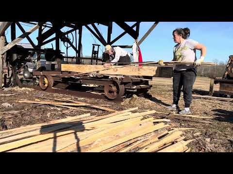

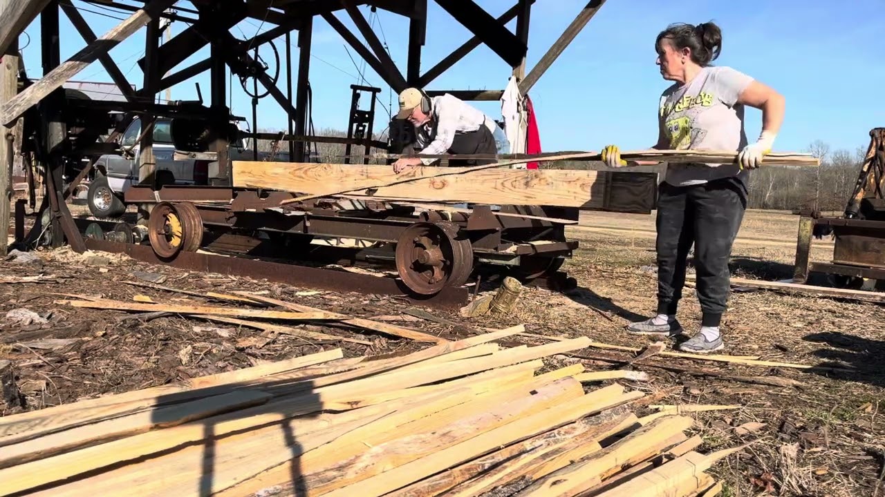

I sawed 4X12 14 foot long today and just about all an old man can handle :smiley:
Tomorrow it will be 10 X 10s
It is a good thing Wayne that you have a strong wife to help you.
I do not consider anyone a old man until they make it to 95 years old, because it takes a young at heart to make to that age. But I know what you mean by feeling like you are a old man, that I can relate to.
Good job Wayne.

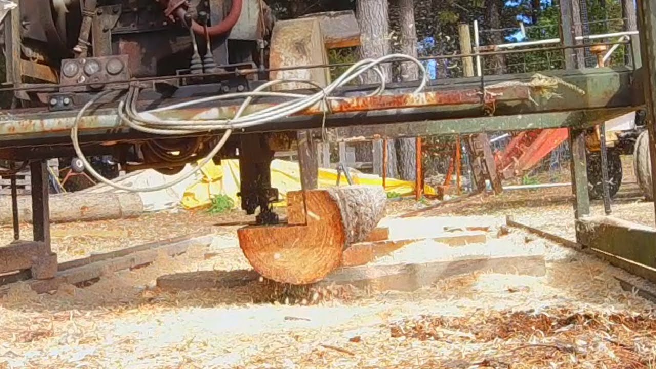

After some years with my mill I’ve come to the conclusion that there are many advantages to running the log through the saw on a trolley rather than running the saw through the log. For one thing I could easily mount a bigger engine and Wood gas it if it just sat in one place. I will probably try that idea out next spring if I can scrounge up the materials.
I keep looking at my sawmill and wondering if I could hang a flexible gas hose to it that would travel with the motor. Having the log move instead of the saw would make running it on a gasifier a lot easier.
My engine is a 6.5 HP but it is either at idle or full speed because of the centrifugal clutch so I’m not sure the wood/charcoal gas would run it fast enough to engage the clutch especially when loaded down cutting.

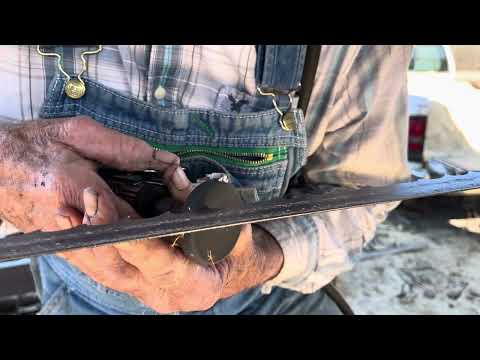

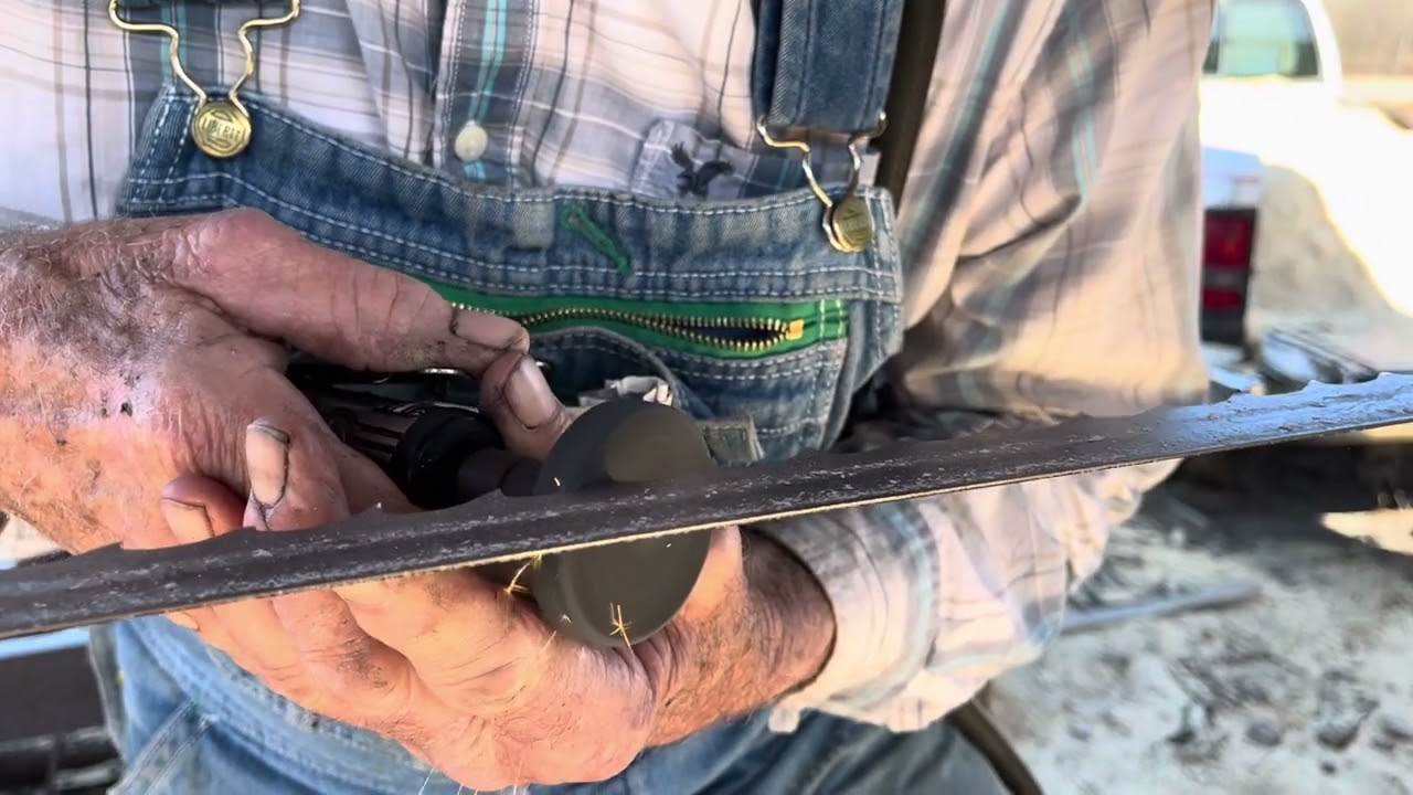

Sharpening the blade .
I will make a couple of passes rather than just one to make sure the tooth doesn’t get hot .
I will rub my finger over the tooth to feel if it is sharp. I can’t tell if the blade is sharp just by looking .
