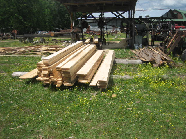

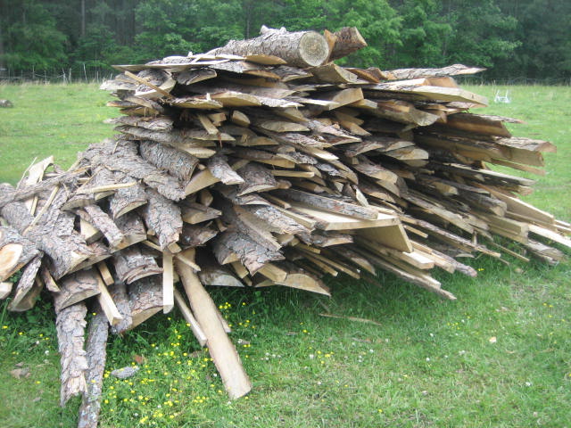

I have been making saw dust , boards and motor fuel today . Also had a coupe visitors down from Nashville to ride in the trucks .

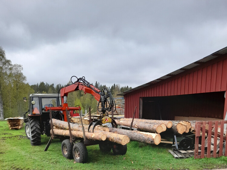

Went out and picked up some seed trees, thought of making planed boards for the hall in Sjöändan, and thought about making a small boat this winter.
