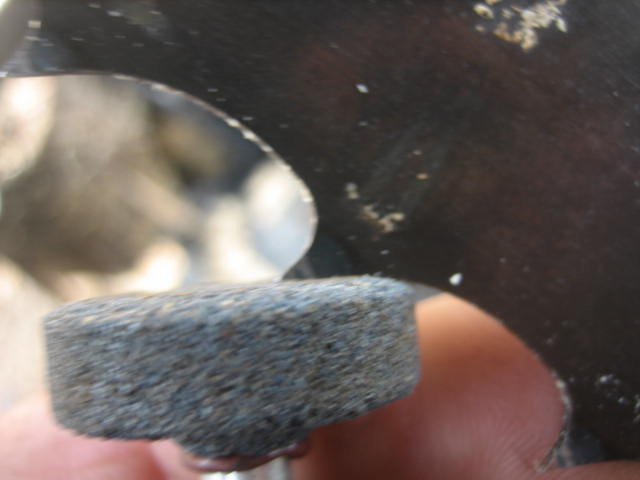

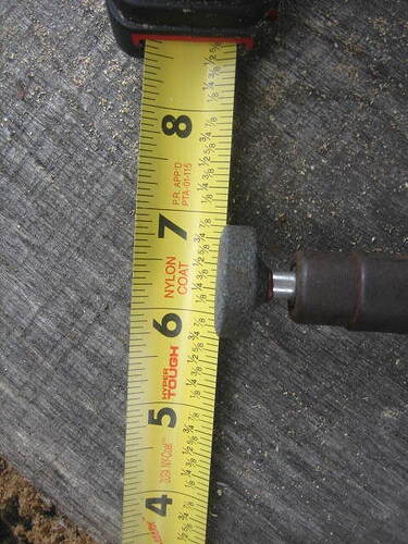

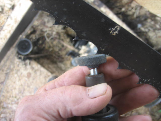

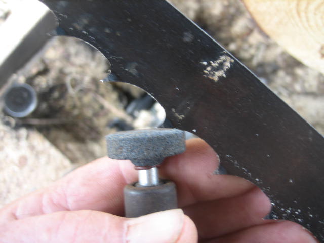

What size stone do you use to sharpen bands with?
Hello Bruce
I have tried several different stones over the ears but have the best results with the bellow .
I only touch the back side of the tooth. I have tried working the front of the tooth but doesn’t work out for me.
I sharpen before the blades get dull and will usually sharpen 6-8 times before changing the blade.
Iv never seen anyone sharpen a band saw by hand, everyone around here sends them in to get tuned up or gives it a real light touch up with a hand file just to finish a job if needed. Y’all in the south really are on a different level of self sufficiency then us pacific northwest guys. Up here is still a throw away anything broken and buy a new one culture. It’s incredible what people toss at the scrap yards here
I use a cordless 4 1/2 ‘’ grinder with a chain saw sharpener 4’’ wheel. I do it on the mill.
Thank you Wayne! I appreciate the detailed pictures! I will try the backside method.
