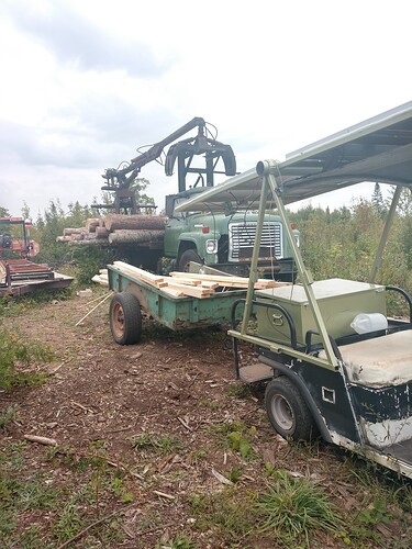

This is not my wood , just sawing for a customer that is furnishing the logs.
Look like there will be about 10,000 board feet in this batch of sawing .

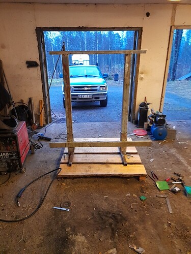

Started with the band saw today, is there anything I need to think about before I weld things together?
Is it wide enough for the size of logs you will running though it? That will take a big log.

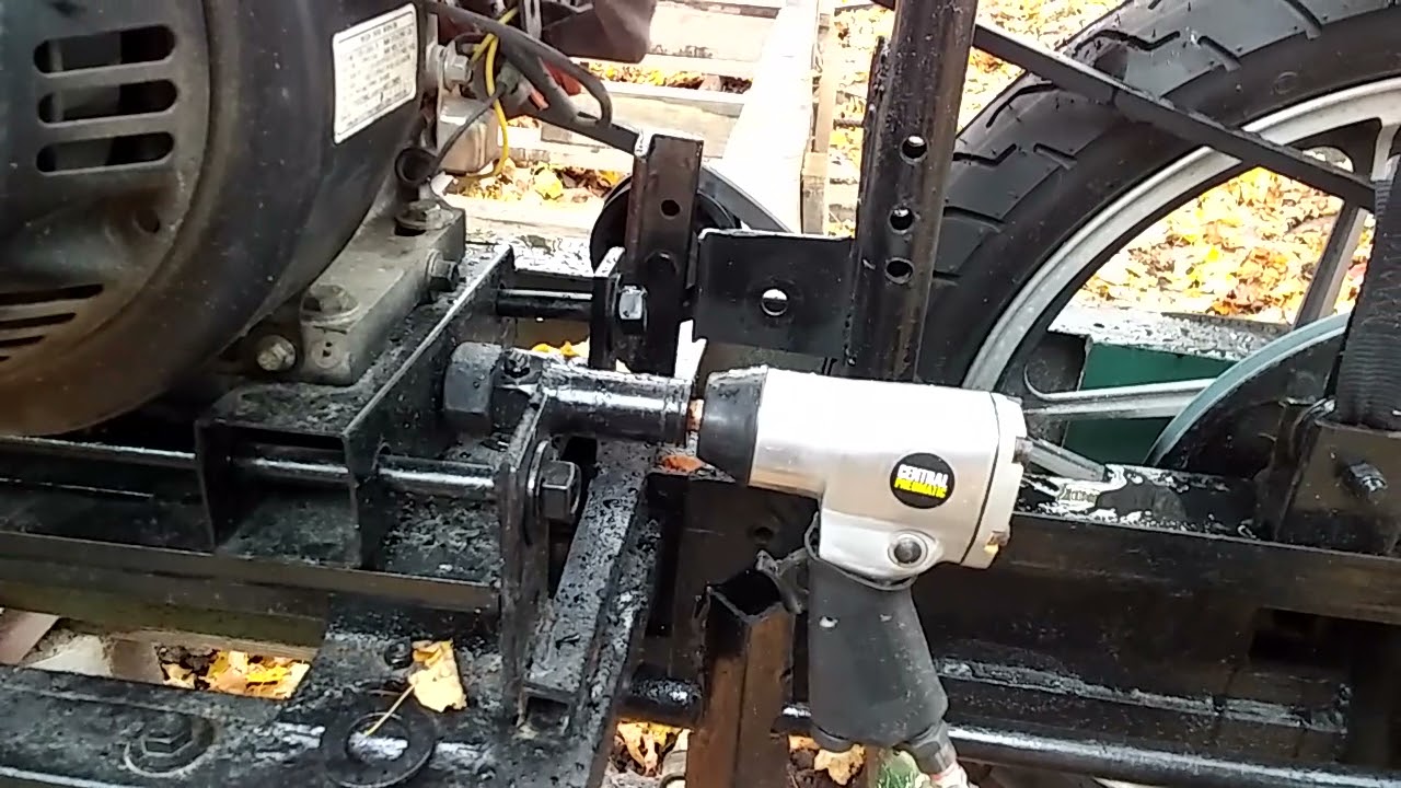

Thanks for the movie Tom, now I understand why it is good with motorcycle wheels, very smooth to adjust, and no oblique loads in the bearings.
Good idea with the holes for every inch, now I got a little more to think about, Thanks.
Blade changes are a little harder with motorcycle tires and bearings on both sides, no?
Not too bad Don. Both wheels have enough slot to push them together far enough that the blade comes right off. There are jamb nuts inside on the blade tensioner bolts so the wheel comes back to it original position and very little adjustment is needed to get it tracking again.
