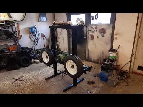

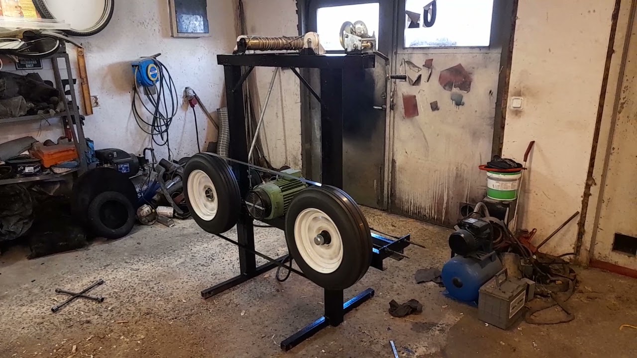

I got the wheels balanced, and it got much better, do you think I can test now or should I sand the wheels first?
Good morning Jan.
Looks like the saw is running very smooth
On one other note . I never get on the front side of my saw or allow anyone to do so while it is running .
I thought so too, but when it had gone for a while and not moved, I wanted to show what it looked like, but thanks for the tip, there will probably be some protection around it if it works.
How hard should I tighten the saw blade and how much air do you have in the wheels @Wayne ?
Hello Jan.
On may mill I use the small emergency spare tires from a car. The tires call for about 60 psi of air but I run mine 40 -50 psi.
I put enough tension on the blade that it runs true with no fluttering .
Hi Jan. On my saw mill I have two arms that extend over the blade to carry the blade guard. Because of the distance between the wheels the blade tended to go up and down a little. Iâm guessing thatâs what Wayne was talking about with fluttering. I screwed a couple of wood blocks under those arms so the blade just barely touches them as it runs. Took out the flutter and also helps clean the rust off the blade when it sits a while. I thought about making blocks that sandwich the blade to help clean both sides but have gotten there yet.

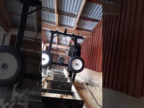

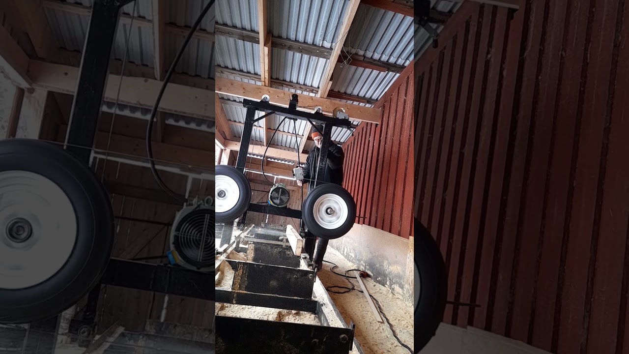

It worked quite well to saw, however, I thought it was a bit rough surface on the wood, and then I have a problem with the supports for the timber, they get stuck in the guide to the band on the right side, I think I have to move them 2 "to the left.
Have any of you sawed in partially frozen wood (birch) with a band saw?
I have tested a bit, but it seems to chop in some places, I have to press quite hard, and then it suddenly releases, then it continues in the same way.

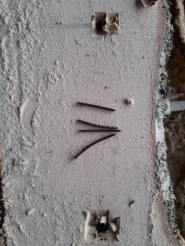

Do not think it was frozen, I sawed off 2 pieces of 4 âor 5â nails, but saw the band did not like it.
I found 2 nails today too, will be trying to sharpen the blade again, but it was only 3 â, not 4â as I thought.

Have cut a fair amount of frozen wood. The issue is ice in the sapwood is different density than unfrozen and/or drier heartwood. If you go slow until the outside is trimmed away it should work much better. Hit lots of metal too. If it was a thin nail it will only dull a few teeth and cause some surging. Reset the blade and sharpen a couple of times and you should be fine again. When I saw you edging the board it seems you have the sawhead facing the wrong way. The blade should be entering on the log clamp side and exiting on the log / board support side. If you can I would turn the mill 180 degrees and start the cut close to the viewer and push it away from the camera.

I have turned the direction of the engine so it goes in the right direction, I was so curious so I had to try as soon as possible.
Yes, I see that I should drive slowly in frozen wood, I should try to make a simple drive of the saw, I find it difficult to push the saw at a steady speed.
I have saw 4 nails (3/16 "thick) now, so I probably have to try to make a grinder, to get the blade right.
