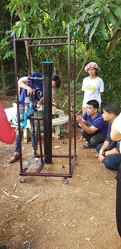

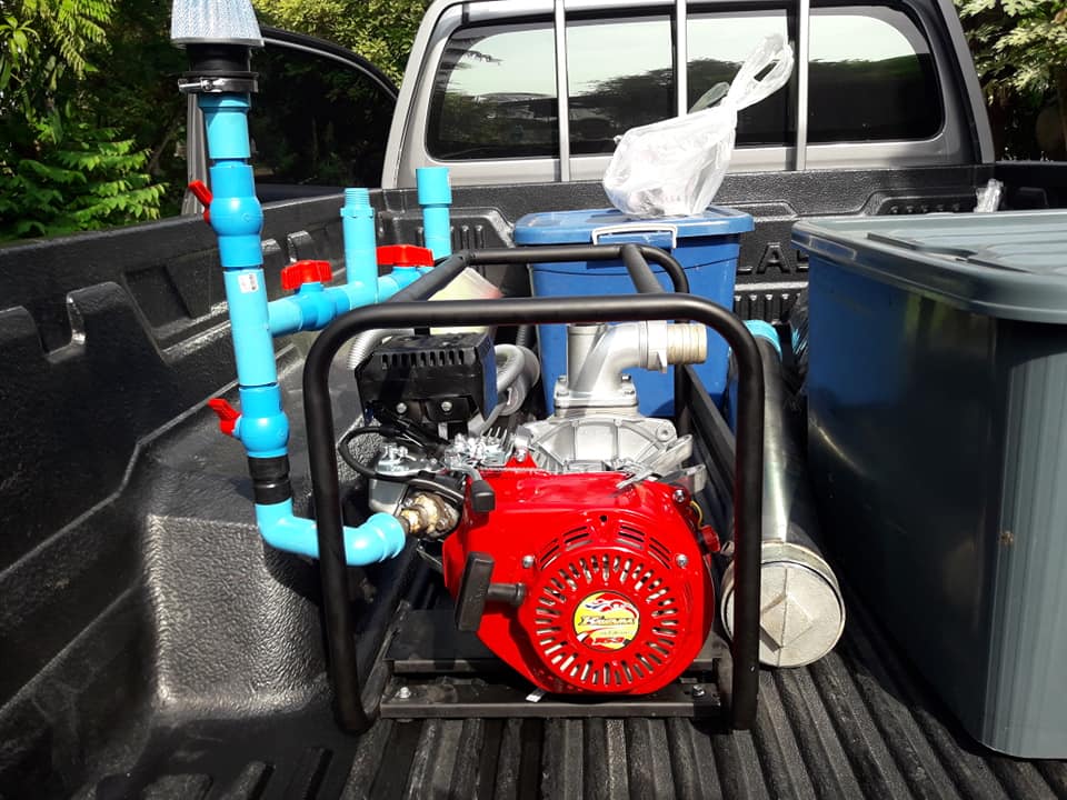

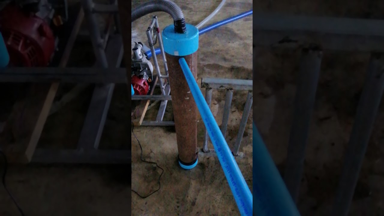

Koen, I am very curious what it looks like inside the 4" gasifier pipe?
(video 1)
Hi Billy,
Its a straight open pipe inside, about 120 cm long (48"), filled with charcoal, nozzle lit at the bottom/side
diameters of the pipe vary between 4 and 6"

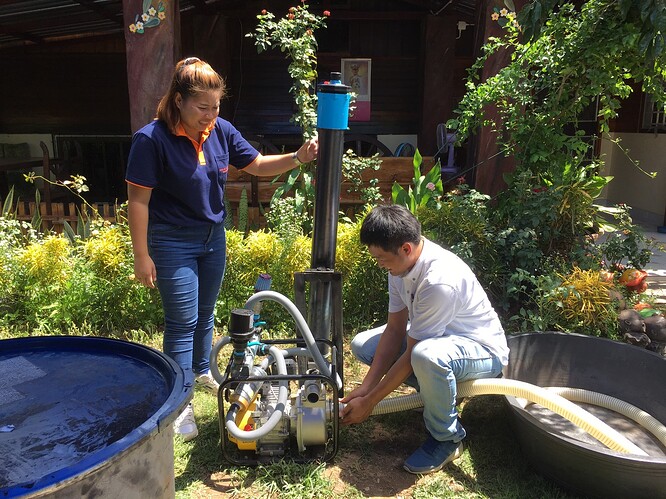

Hi Koen , you mention nozzle on the bottom side , and i did notice a glow while it was running so i presume that the nozzles are horizontal on those builds have you made in roads with a decent material ? or are you using TIG type nozles in your small 4 and 6 inch dia pipe gasifiers ?
Hi Dave,
They build them with 15mm hole in the side ( like a small nipple female thread ) or just a hole with a nut welded on the outside.
Just to remember that simple also works…
All other options requires in depth thinking and add more to the difficulty level…
Whenever something goes wrong they ask my advice on how they can improve themselves…
I am actually surprised how fast things get picked up once they start doing by their own idea’s and how well some builds work…
As where i aim for highest power output, they are already happy when the engine runs and the pump pumps water…
Hi Koen , so let me get my head round this , you mean they just drill a hole in the side of the tube and weld a pipe nipple in and allow that to burn out ? if you have any close up pics that would be handy to look at and understand how they even manage a few hours run time .
Cheers
Makes perfect sense. no unusual materials. just weld in new pipe and pump,.Pretty soon they will; have found the perfect local material for making nozzles, the toughest ceramic or clay or metal part. It always works that way. After they replace it a few times they’ll start looking for an alternative. It will end up being Somethiing Koen will not have thought about. Unless he’s still available to ask what to do. Then they’ll just keep doing doing what he tells them. But still someone will figure it out…Poor People everywhere operate that way. They have some kind of survivability meter that is different than people that have too many options. And like Koen said, he’s looking for optimal performance, they’re just trying to make a pump run on charcoal.
This makes me smile. If you want something to spread, keep it simple.

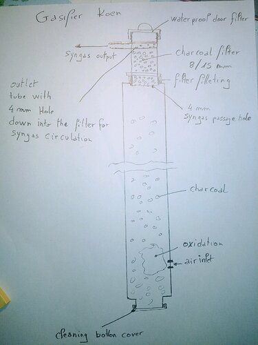

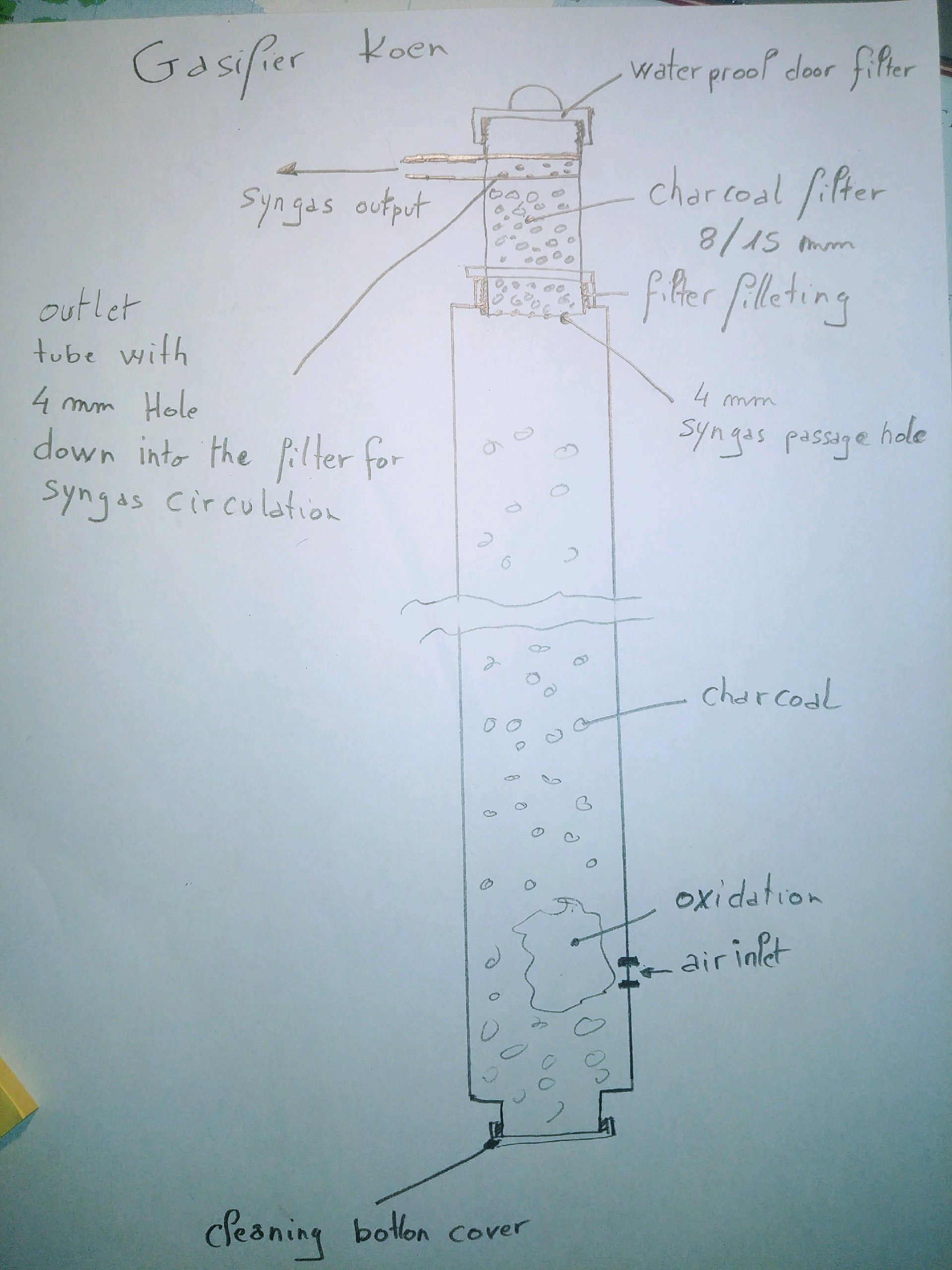

the charcoal gasifier Koen is a marvel of simplicity, but I propose the addition of a filter at its upper part with charcoal, for three advantages,
if the gasifier is used for a long time, there is a risk of significant dust rising,
more important syngas cooling is achieved
less fine particle in the filter before the engine. and after the gasifier.

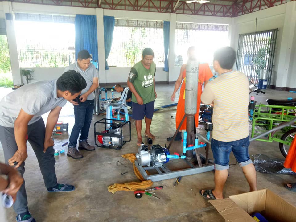

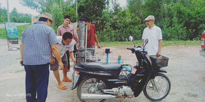

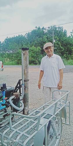

Hi Koen, I do not speak the language, but the blue pole that the instructor was using seemed to speak as he was pointing things out.
I see they have developed a down draft and a down cross draft charcoal gasifiers. The cooling rail design look great. Let them know I will be copying their design. They have become apart of the DOW team.

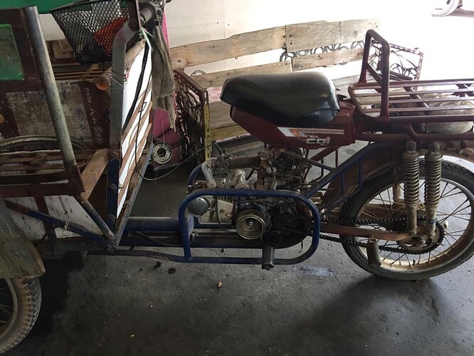

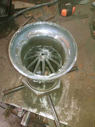

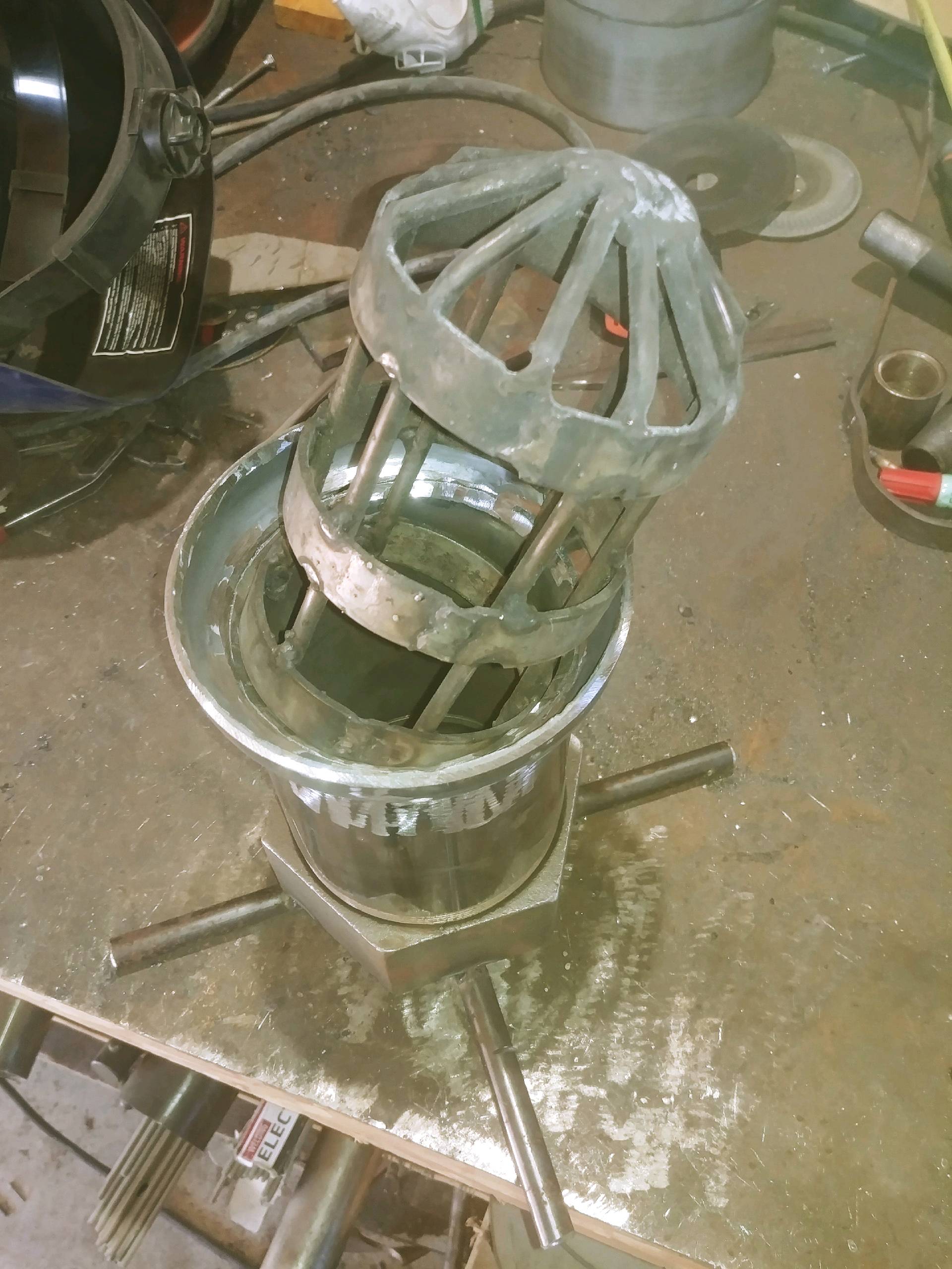

I had no experience on small gasogens, I was not measured that it was a fairly large engine for the wood gasifier,
so I turn my little trailer into a charcoal gasifier and here is a transformation of the gasifier Koen, an ash collector at the bottom of the device.
