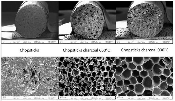

I do not know what to think anymore . I thought that the baked coal at 500 - 600 c was ideal but now I’m not sure. Hard coal offers less oxygen surface and therefore reacts slower?
The main advantage of charcoal baked at 500-600c is its ignition speed?
Thierry :disappointed_relieved:
Hi Thierry,
Nooooo,…, the density has only to do with the amount of pores inside/surface of the charcoal…
If you look at the picture i posted you see the structure changes , ( the sponge gets more open pores hence more surface can contact with oxygen)
The more pores you have = equals airbubbles in concretefoam = less dense ( less weight per volume)
I would type this in French to explain this better, but so sad, its not my native language either…
Lets have it as a joke; i rather have 1 kg snowflakes falling on my head then 1kg lump of solid ice…
Both are frozen water, both have 1 kg of weight…

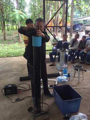

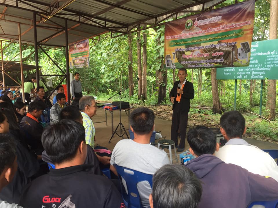

People from the government and ministry of energy are giving classes and helping rural area’s
today 2
Just look at what you two have started, just amazing. One person, and than two can make a difference. Here is proof of this. Great a job Koen.
this monk is going above and beyond… my hero…
