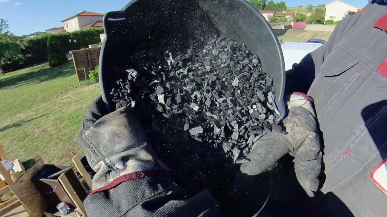

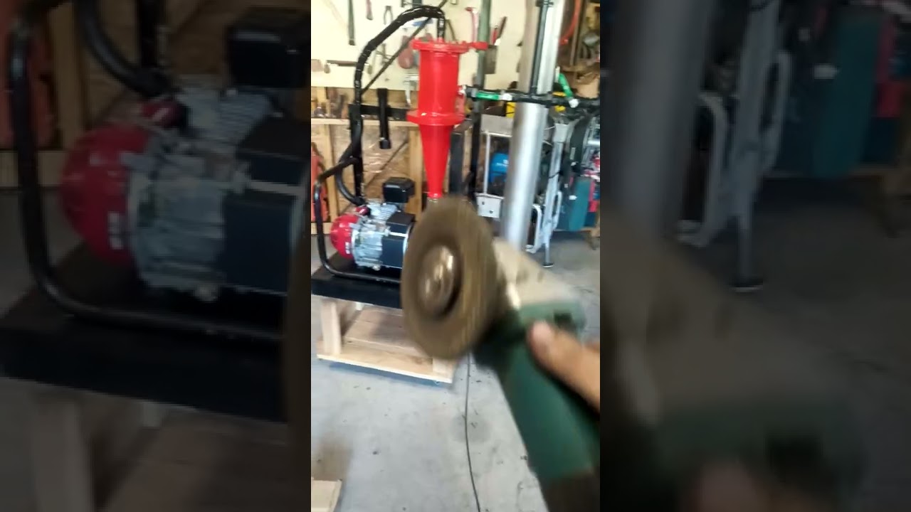

In europe, great energy difficulties await us, cogexyl has developed an autonomous system for the individual, a charcoal distiller with hot water heat recovery, for sanitary water, heating water, washing machine water with a copper circuit in its cover, is with the gas device, either we make electricity or charcoal gas for the gas stove, so without wasting raw materials, you are completely autonomous with ease…
