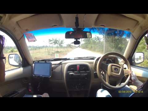

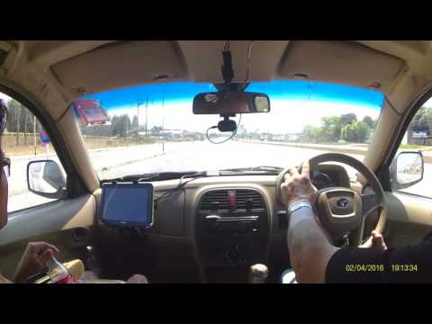

Been on the road for about 3000 miles now…
Its a beast, not a pussy…
driving on pure charcoal gas:
Doing some long hills climbing (8%) average 12,6 Kg Charcoal per 100 Km, with the flats ofcourse…
The engines bites itself @ 3000 RPM and the gearing is superb in the range 2500 to 3500
Revving up to 3300 without hesitation Torquing from 2300 do able
The steeper the hill, the wiser to choose the correct gear, but still … thinking and feeling more power from Charcoal gas then from CNG
Its all about the correct fuel trim i guess
The car loves long stretches on charcoal, no need for hybrid driving.
Short start stops, more consumption average from CNG, it looks that the engine is build for long steady instead of city traffic.
Everybody happy… the beast not tamed yet…
