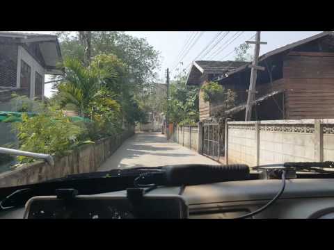

Thanks for the ride Koen. Was that on charcoal or petrol? Hard to tell because it ran so good. You sure have a lot of fences and walls around property over there on the second video!

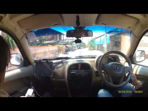

I can adjust the ECU settings “on the fly” with the Tablet left side ( not really on the fly but you get the point )

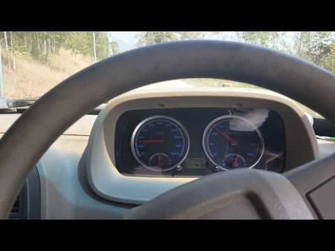

uploading some clips from my phone to, shaking but more detail of the dashboard…
one more actioncam…
Looking good Koen! I don’t see you fiddling with controls or checking gauges. Do you monitor temp or vacuum on the gasifier?
Like Don said, you hardly would know it’s on charcoal gas!
Hi Chris,
1: Automatic air-gas mix valve, base adjusted, AFR compensated
2: No temperature controls / vacuum-gauges yet
