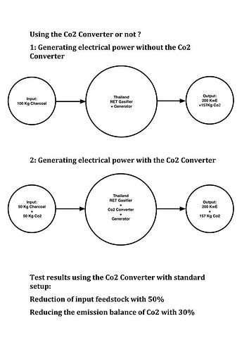

a small example for the use of the converter with some numbers…

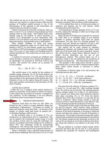

Attached the document extracted from the same thread…
My suggestions are…Don’t forget the nitrogen present inside the air .. that diluite a lot your fuel mixture.. the reduction reaction is endothermic and CO2 absorb some heat from red charcoal .. using just oxygen from air (including nitrogen) the temperature decrease a lot and you don’t have an exothermic reaction as you claim.. hydrogen from water vapour can help you to maintain high temperature inside the reactor but there are some ways for steam production without use the heat of reactor. Inside the reactor you need stable and high temperature in the time.

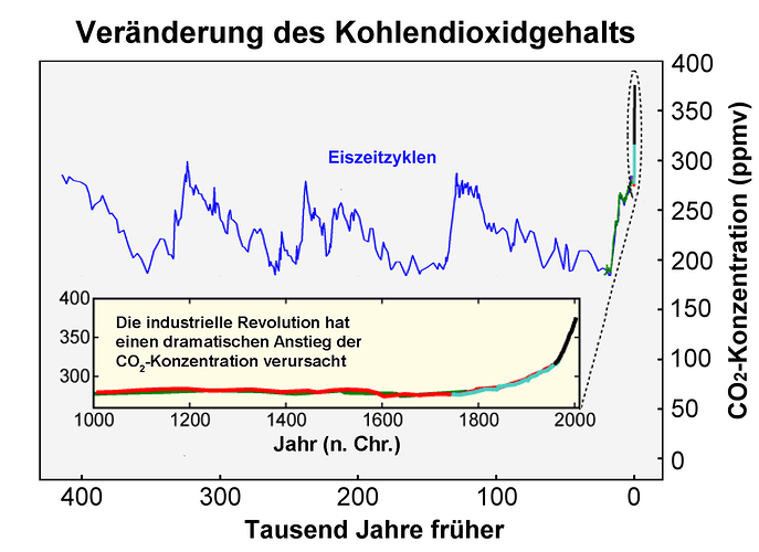

The amount of Co2 , measured in the ice layers on antartica, have never been higher… ( look at the picture )
With all the energy we consume, we produce inevitable Co2
Either we decrease our consumption of energy or we find ways to decrease the amount of Co2 produced per energy consumed.

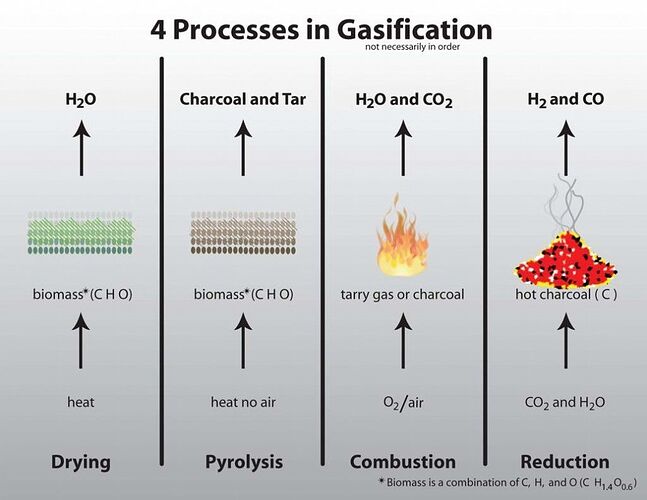

These are the 4 main processes in a gasifier.
Balancing all of them in one system is what i call a “master piece” of inventively tinkerers.
I am still way from being a master in one step gasifying, learning step by step.
I have just found a balance between the 2 last processes now trying to find efficient ways to ad pyrolysing…
Yes… is true… but this old diagram don’t consider the percentage of 78% of nitrogen inside the air creating an negative adiabatic inside the process… in fact the inert gas absorb the heat from red carbon reducing the internal temperature!!! All change if you with the same air produce plasma from nitrogen… in this scenario nitrogen is active medium inside the process.

  • He says he can take the CO2 out of the exhaust and convert it into CO, but not all of it… Just 50%
  • He says it has something to do with the Boudouard reaction
  • He says that he can make the same energy output and save 50% of the carbon feedstock
