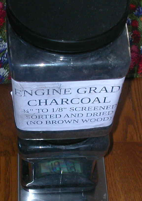

I filled large plastic feed sacks with 20 gallons of charcoal and weighed them on a bathroom scale. Information with type of wood, weight, and date are written on a piece of paper and stuck in the same bag. A 5 gallon plastic bucket filled to the rim holds 5.86 gallons, so the 5 gallon mark is about 1 3/4" down from the top. Four buckets in a sack weigh around 24 pounds, so we rounded off to 1 1/4 pound per gallon. The charcoal in the sacks has been screened to remove the fines and any nails or little brands. It needs to be run through the charcoal grinder and screened once more before it goes into sealed barrels marked “engine grade charcoal”. (1/8" to 3/4")

These peanut containers hold 8 cups of water right up to 1/8" from the lip, and weigh 4.4 oz empty. Full of ground charcoal they weigh (together) 2 pounds and 3.9 oz. or 35.9 oz. Subtract 8.8 oz. = 27.1 oz. or 1.7 pounds. Since 1 U.S. gal. liquid = 1.1636 U.S. gal. dry, dividing the 1.7 by 1.16 = 1.46 pounds/dry U.S. gallon.
In conclusion, I’ll have to agree that grinding the charcoal into smaller pieces makes it pack together tighter…so it weighs more. (Now, my old brain has been fried for today.) Martin will have to say that his charcoal weighs almost 1 1/2 pound per U.S. Dry gallon.

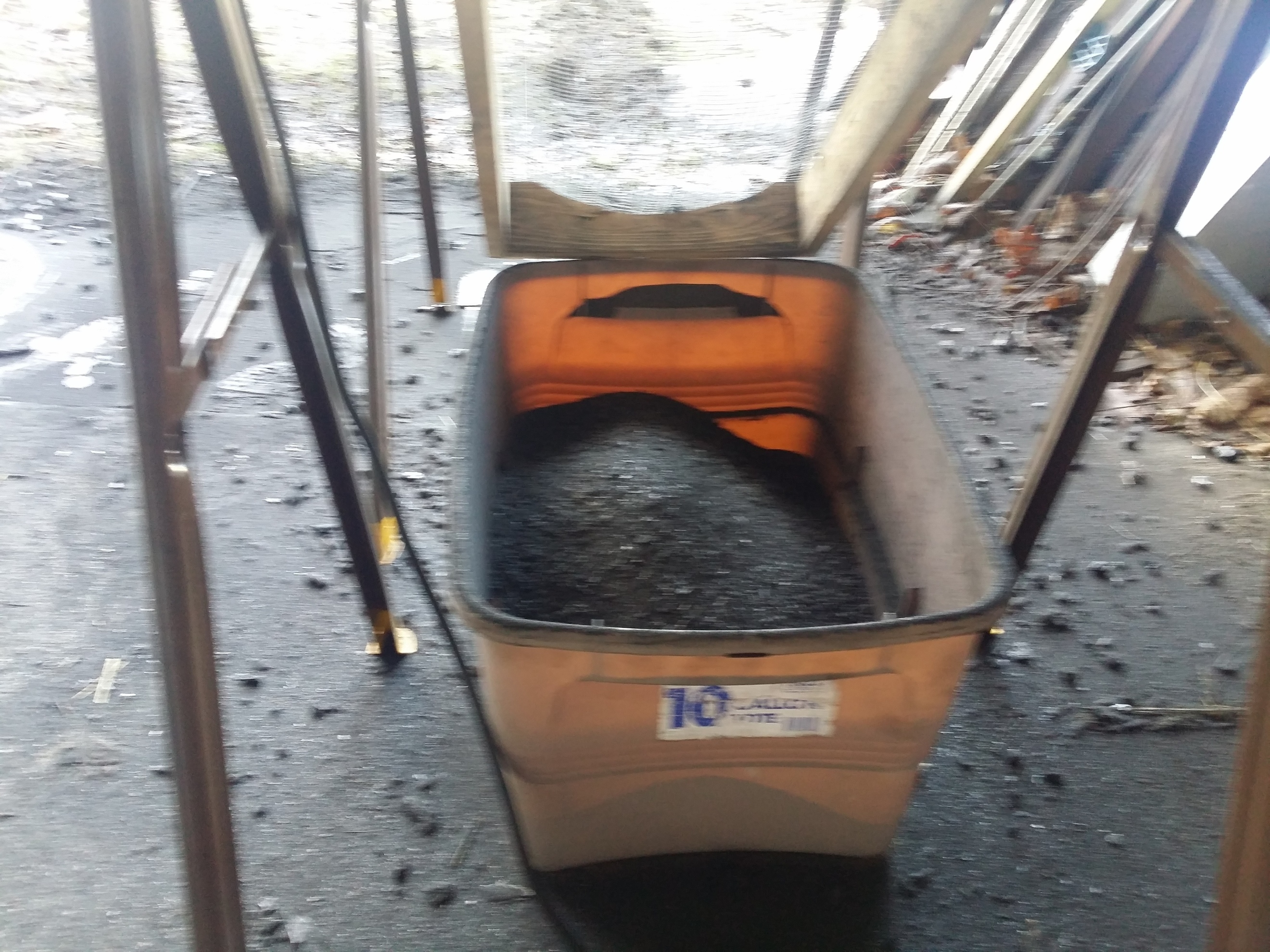

This afternoon I weighed out 45 pounds of unground charcoal then weighed again after grinding and screening and it weighed 40 pounds. The screenings weighed 5 pounds or about 11 percent but the volume of finished engine grade charcoal seemed to be reduced by about 20 percent due to smaller air spaces between the ground charcoal. Here is a picture of the fines that were screened out while grinding.
I just weighed the fines on the postage scale. 3.125 pounds divided by 1.16 = 2.69 pounds/dry U.S. gallon. Martin’s suspicion was very close.
