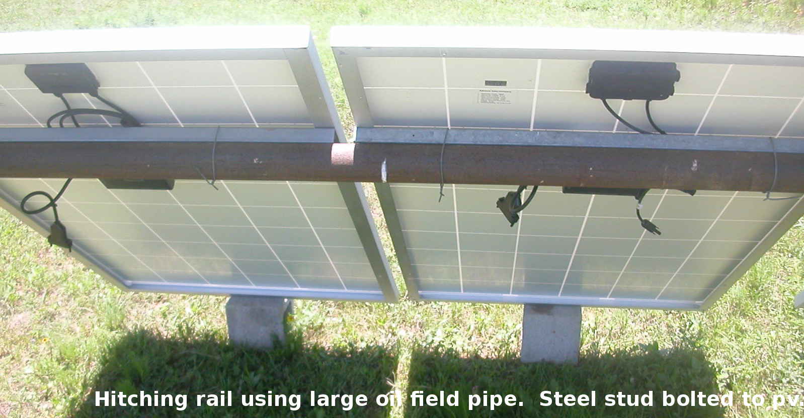

One of my neighbors has figured out a low cost Do-It-Yourself way to set up solar panels to feed into the grid. I think he now has about 317 used 245 watt solar panels working with used Enphase M215 Microinverters feeding into three grid-tied smart meters, and a Tesla Powerwall. The cable connecting the inverter to the 240 volt line has not experienced the price drops of the other components. The normal cable is a single phase Engage in either Portrait or Landscape connector spacing, but three phase cables are available for about half the price of the single phase, so 1/3rd of the cables will not work unless some of the wiring is swapped around. The panels are mounted on the ground leaning against a 30’ section of oil field pipe. Three of these can be threaded together for a 90’ “Hitching Rail”.
Solar tax credits cannot be claimed for used panels or inverters, but might be claimed for some of the wiring and disconnect switches, etc.
Even so, the payback is less than 4 years. Details are on his blog located here: Willie: May 2019

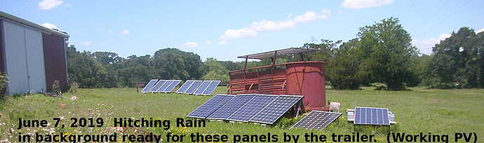

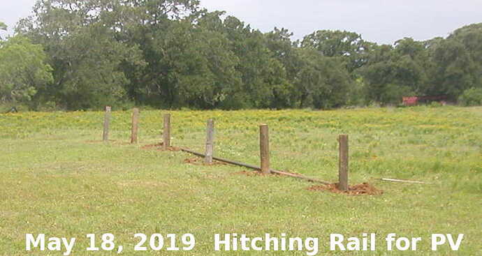

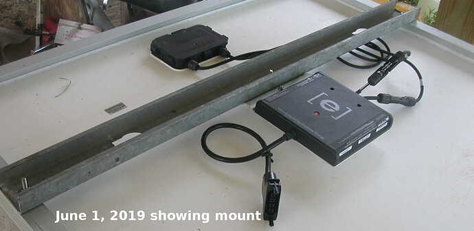

I am in the process of getting a rail of panels working, but instead of pounding oil well pipe into the ground, I cut heavy duty fence posts in half, and drilled post holes with my tractor, and then fastened the panels and Microinverters to the rails. I used some heavy duty steel studs to hold the inverter to the rear of the panel as shown here:
Besides these panels, I have 25 others on top of pergolas, on single axis tracking, and on two heavy duty welded up ground mounts, but the Hitching Rail is absolutely the cheapest. The panels could be almost flat for the month of June, but the angle keeps animals from walking on the panels, although I do plan to decrease the tilt. (I’m at 29° N. Latitude.)
