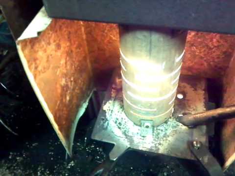

I found this video of my furnace conversion. It has an 8 inch cast iron fry pan that the oil drips into. The suction of the chimney draft pulls the combustion products thru the slotted 4 inch pipe where secondary combustion air burns the vapor with a white hot flame. It works good but is still a dirty way to heat my shop.

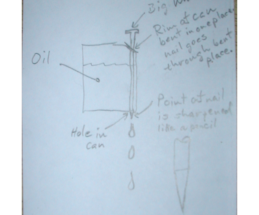

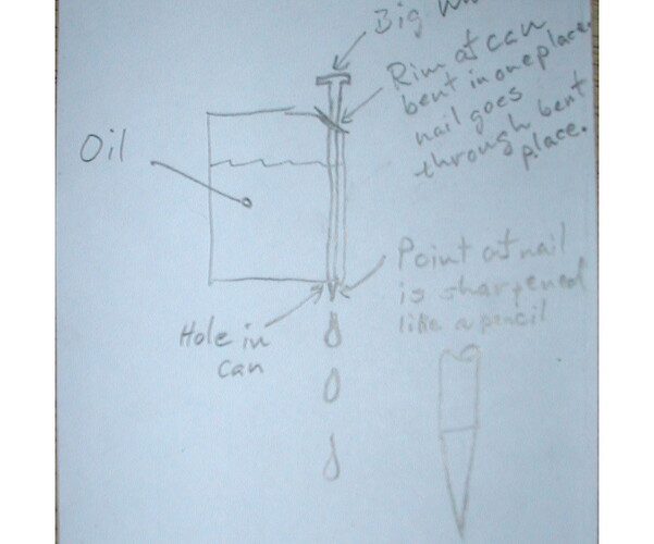

Not too sure if this will work in your setup, but it might be an idea you can build on. I made this oil drip thingy to burn up some old fryer oil in a rocket stove. The resharpened nail acts as a needle valve. The hole in the bent part of the rim makes friction with the nail. The nail can be raised or lowered to change flow rate.

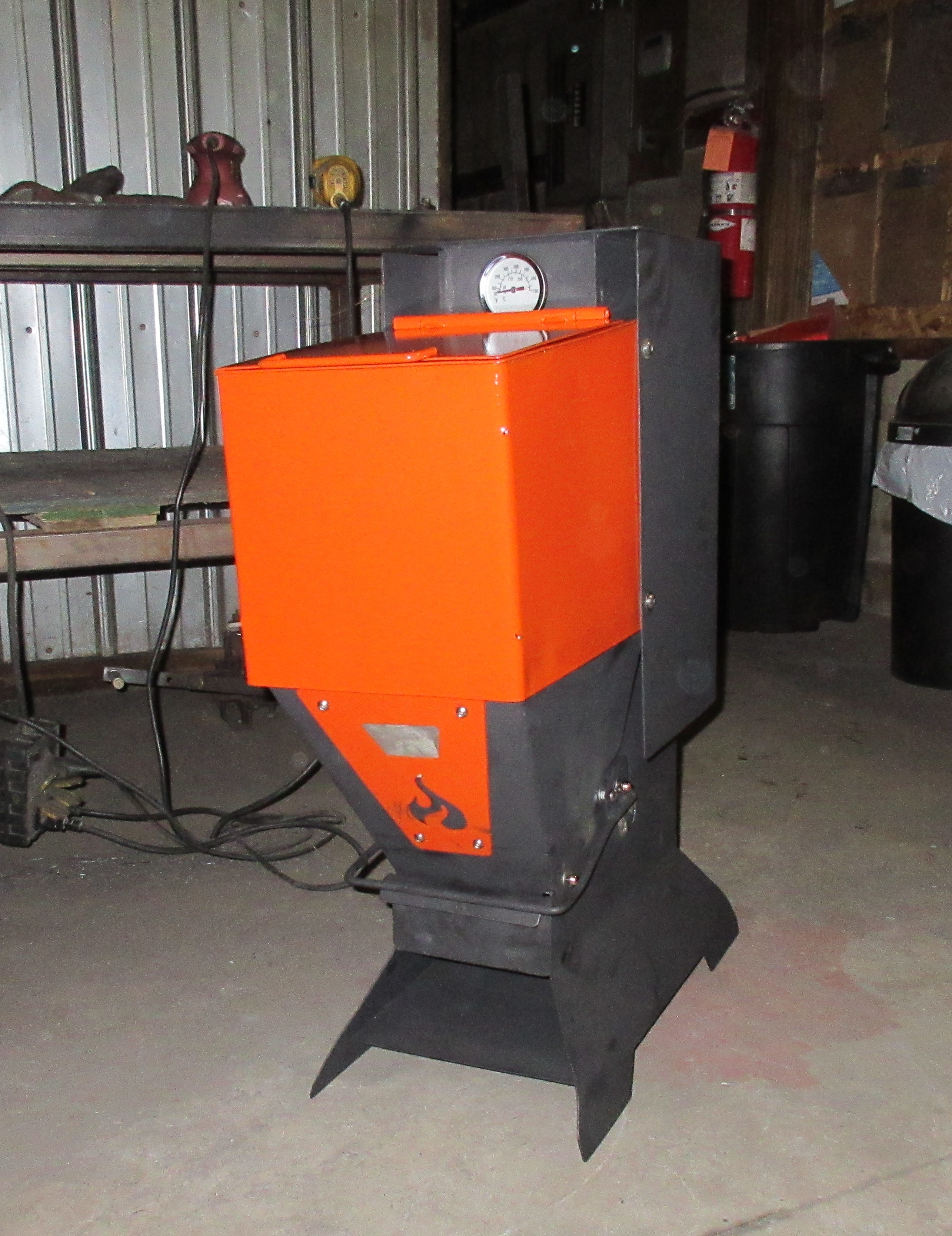

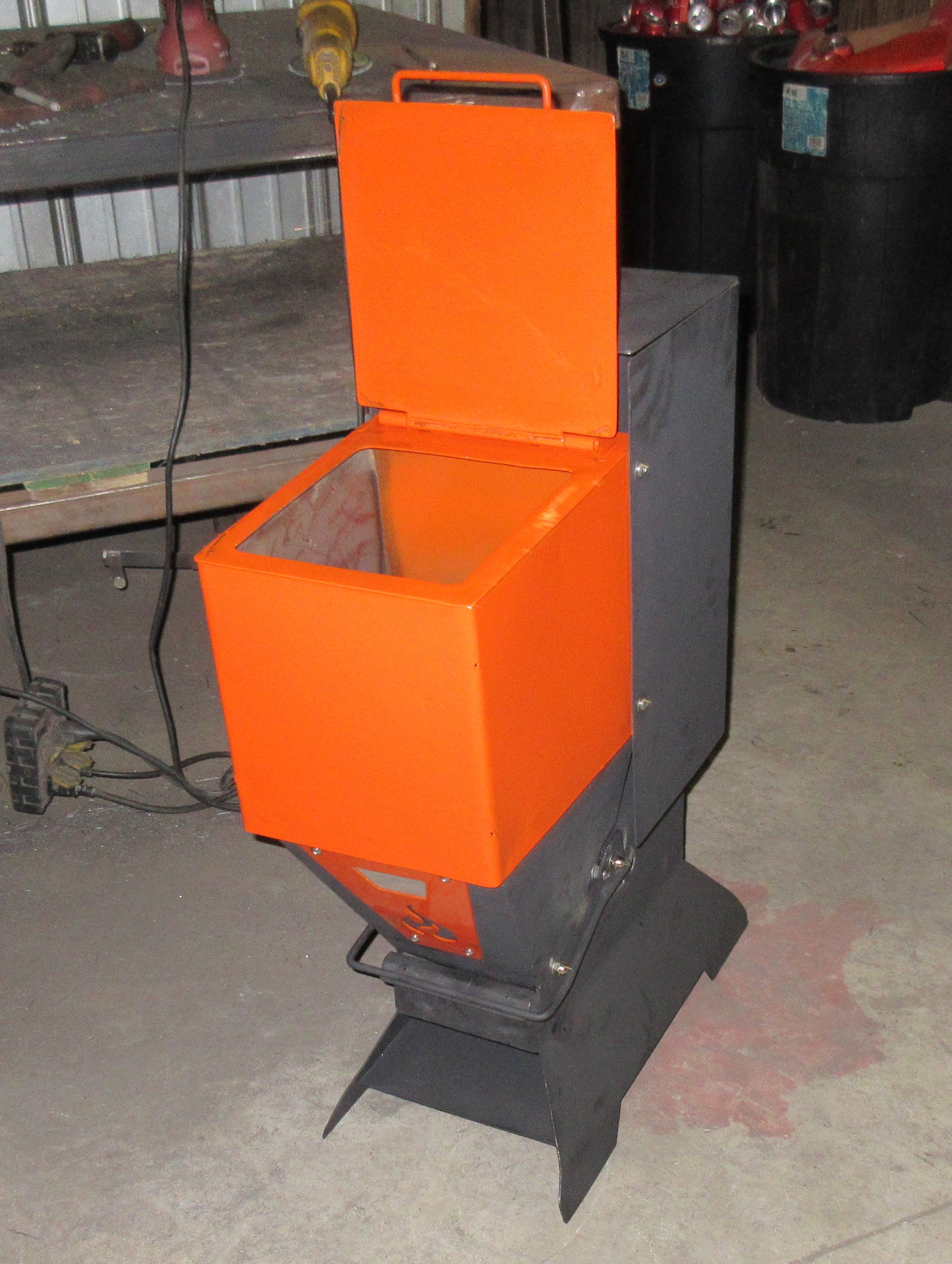

If you are in the market for a pellet stove. Check out my Enduro Stove. This stove is the by product of the gasifier development. In a way its actually what developed the gasifier reactors I use today. They started out on very early pellet stove prototypes.
Today the Enduro Stove is now fully developed and a year field tested. I have refined the 2020 version to hold a near full bag of pellets. This stove does NOT require any electrical input. It uses a natural draft and you can cook on it. So in a power outage when its COLD, you will have a means for heat, cooking and hot water.

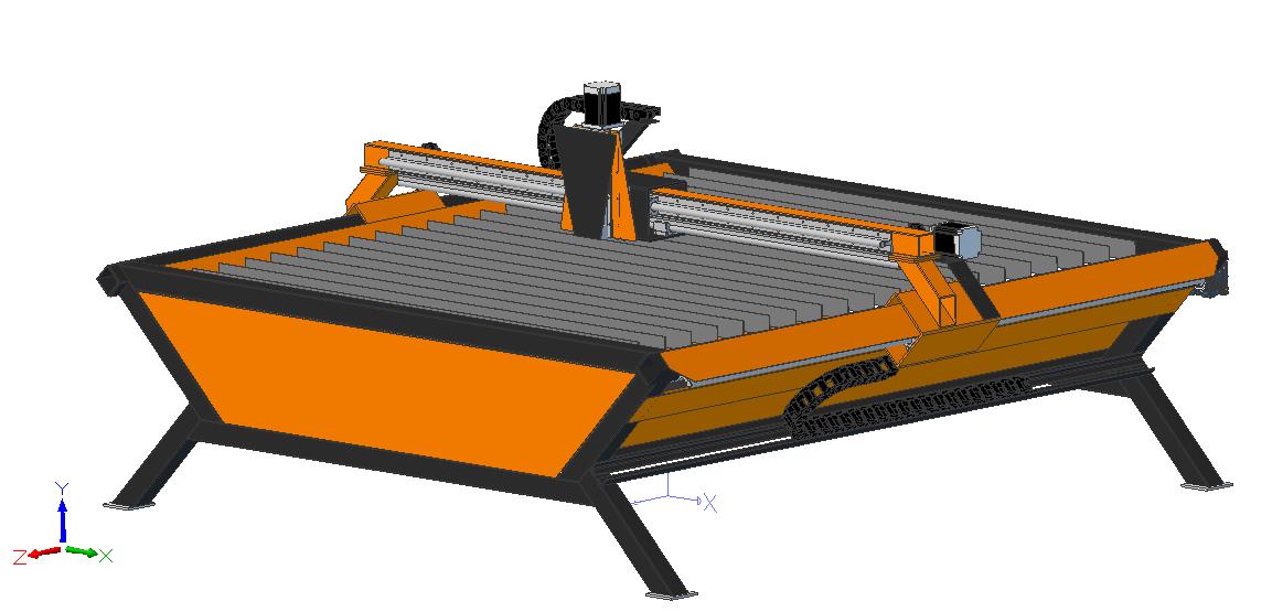

Well Its been a long loooonngg road in this endevour, but I think its time to change direction. I am going to pursue my CNC company and start pushing its marketing. I just completed design work on the new Dual Cut Pro 60 for next year. This machine is available for order right now; Ive already sold two of the them. This is a 60 X 60 inch table with dual precision ways, ball screw drives with anti inertia back drives. It can be set up for laser, plasma and router cutting heads. This machine will be the top offering for 2020 and will come fully equipped (turnkey) with free delivery, set up and on the spot training.
Those that may not know, this is actually my background, Ive built multi million dollar CNC tools. This is the company I worked for before launching Vulcan Gasifier.
I will now be working on a low budget machine that will be the bottom of the barrel offering. This will be a plasma cut only table with a 24 X 24 inch work envelope. However, at the target price point of $2500.00 It will offer more features than any other machine in this price range.

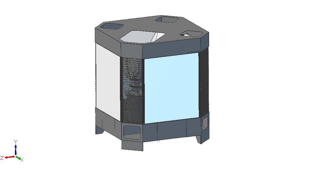

This is the next generation power system. Internally it is the same as last years Flex Power System. However just wrapped in a new wrapper and simplified a bit. I will be retiring the Flex badging and extending the Worx branding onto the power unit. This will be the Worx Power Station coming soon. I will probably offer a range from 5 kW on up to 12.5 kW with networking capability.
It is 42" X 42" foot print and stands just 48" tall. I estimate it will hold around 100 lbs of fuel. The machine I will be building will have the 670cc V-twin stuffed inside mated to a 10 kW peak output generator head. It should sustain a 5 kW load with probably around 8 kW peak.
It seems Matt you have endless amount of ideas coming out of your mind for improvements on your builds. Good job.
Just an updated model, with the all the door panels and access lids installed. I crammed the Honda GX 690 in there along with the NorthStar 10 kW head as well. So I think Ive succeeded in what I set out to do with this design. Hope the real world build process meets thats criteria. Ill be building this very soon.
