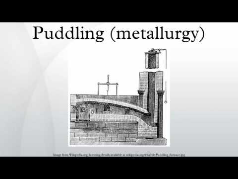

Flat iron as called in some places or puddling iron.
A process no longer used but it makes a very ductile steel like product.
The Eiffel Tower is made of this kind of metal.
Impurities that remained in it after the puddling process enhance its corrosion resistance properties.

Well to come right down and put a sharp point on it puddling iron is steel ( of a lower grade due to higher levels of impurities )
There as a time when different grades of steel were marked by the process that was used to make it

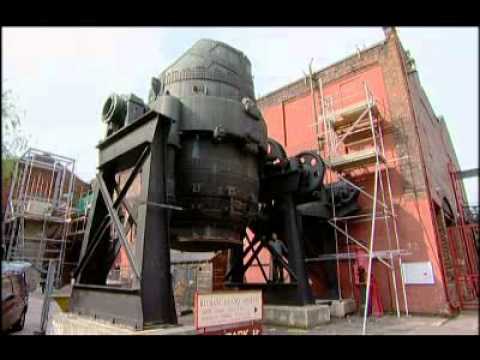

A B 1010 steel today would not be made in a bessy converter
I don’t think any one short of aa chemist in a lab could tell one is different from another
Where I work we still use the bessy converter, but not to make steel
We used at one or another every step frame m the blast furnaces of the time industrial revolution to the pure oxy process today
