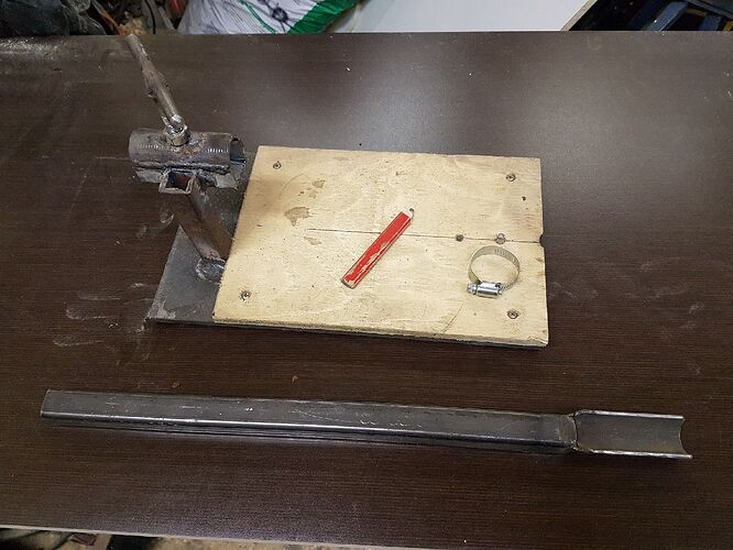

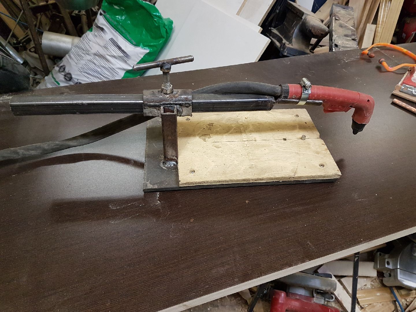

I think the pics are on my previous phone. I will rummage, or drag out the jig. Its much like a router jig.
Note that the holder is inclined, this holds the handle correctly, but also allows for fine adjustment of the torch height. I think the removable plywood base allows use over the full range this torch will cut.

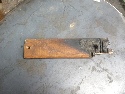

Hi all

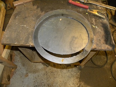

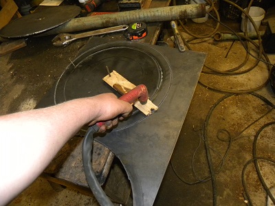

I needed to cut the lid for my heat exchanger so i built a simple jig out of a board and junk bolt. It won’t last long but it gets the job done. JakobDSCN9492DSCN9494DSCN9495

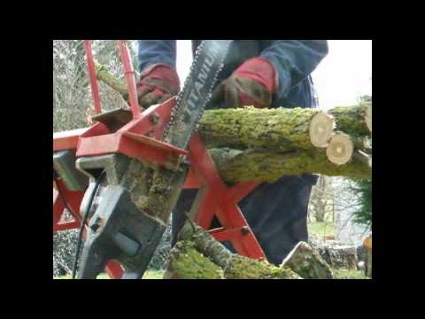

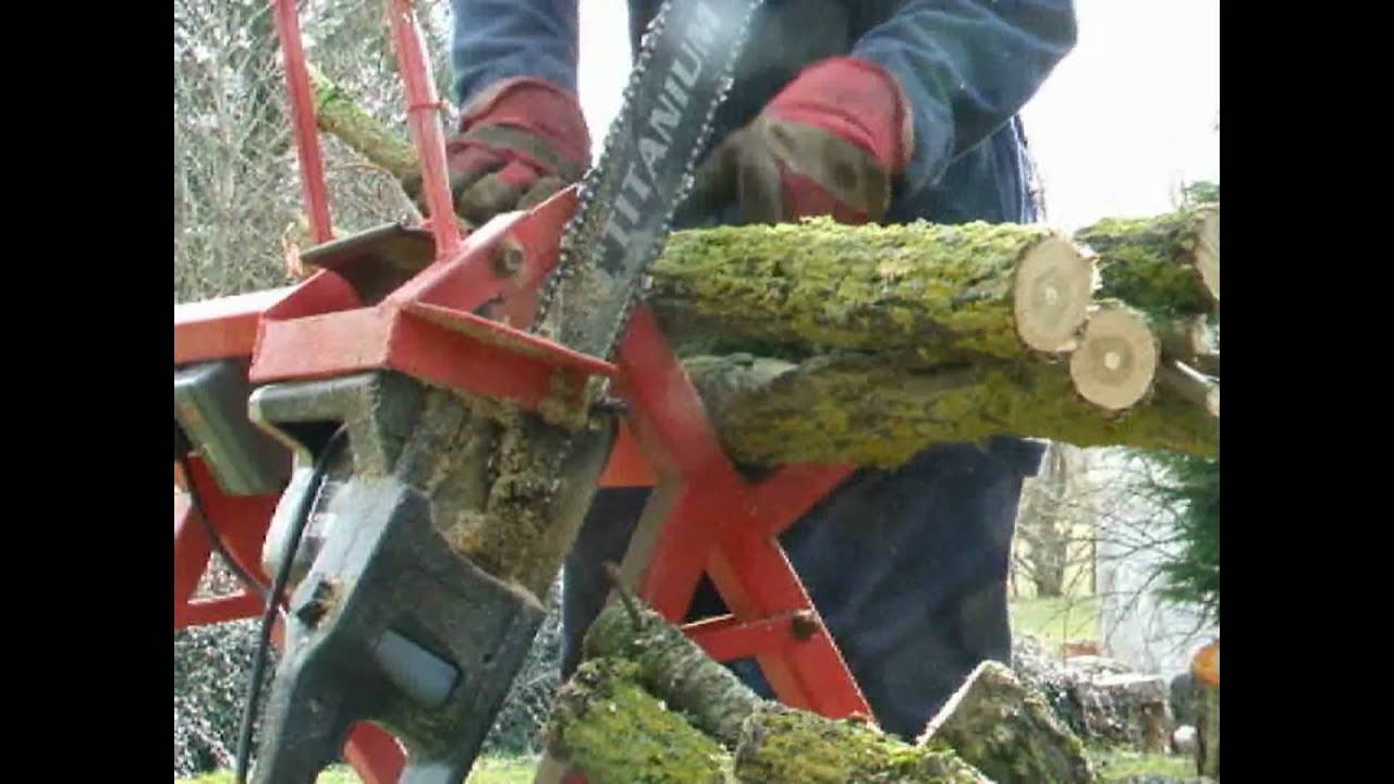

Garry, my father uses that kind of chainsaw setup from time to time but with an electric chainsaw. Convenient if you’re doing only a small batch.
I can’t help noticing 99% of the youtubers seem to have very strong backs. They let all their wood fall down to the ground. They even rake down logs that happen to pile up. To let the wood fall down into a wheelbarrow would save more work than the equipment they invented :smile:
Good point Jo, yes, a wheelbarrow would make very good sense. I did not know the chainsaw setup was an old idea. It seems too many YouTube videos are made by some enthusiastic person the moment they finished the project.
I like this idea though, very easy to set up beside a cord wood pile, keeps the work more in a standing position, and the saw away from mud and rocks, etc.
I will modify the base to have 3 raised feet, the one they show isn’t made to work on rough ground or in the bush.
Only problem is the stress will always be on the bar front bearing.
It would be nice to have it mounted to the truck bed or trailer.

Good point about the stress on the bearing. Maybe a re-think is needed, make it more like a chop saw, with a foot pedal to raise the saw…
That would make it more complicated and heavier, but with proper guarding far safer to work around… I have seen videos using a chainsaw hinged on the nose of the bar used like a chop saw, that would mount nicely to a truck tailgate, but be a bit inconvenient to work around…

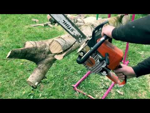

I like this way for awkward branches ,the saw horse is light enough to carry into the bush .
Haha for wood in the video l dont even need a chainsaw, l culd bite it to peaces :smile: looks like punky alder. Try this with a same size log of green beech or oak… only way l see this practical (at least for my circumstances) is to use it for thin branchwood cutinf, but in this case a drum chunker is much more conveniant for me.
On the bearing stress, l guess it shuldnt be much of a problem to just flip the saw around? Chainsaws are designed to run upside down anyways?
You are right of course, hard frozen wood will tend to skip on top unless the chain is very sharp, and sure the saw will run upside down. Some designs (electrics generally) have an oil reservoir which only works in an upright position, so caution there.
I am working out a different design entirely now.

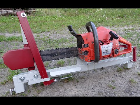

I did come across this fellow’s design yesterday, needs more guarding, but it does a decent job as a chop saw…
