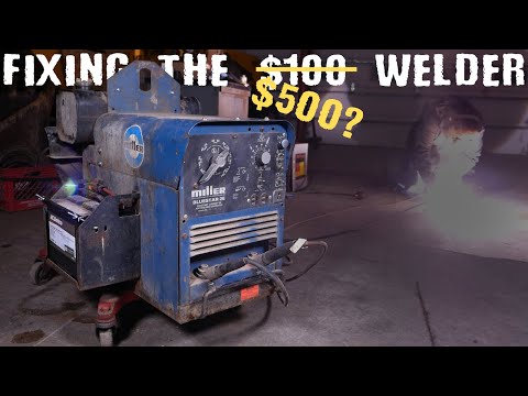

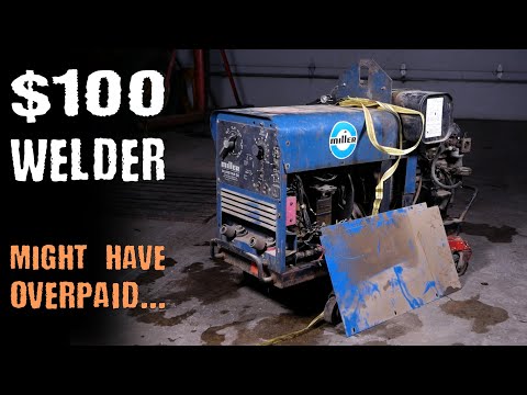

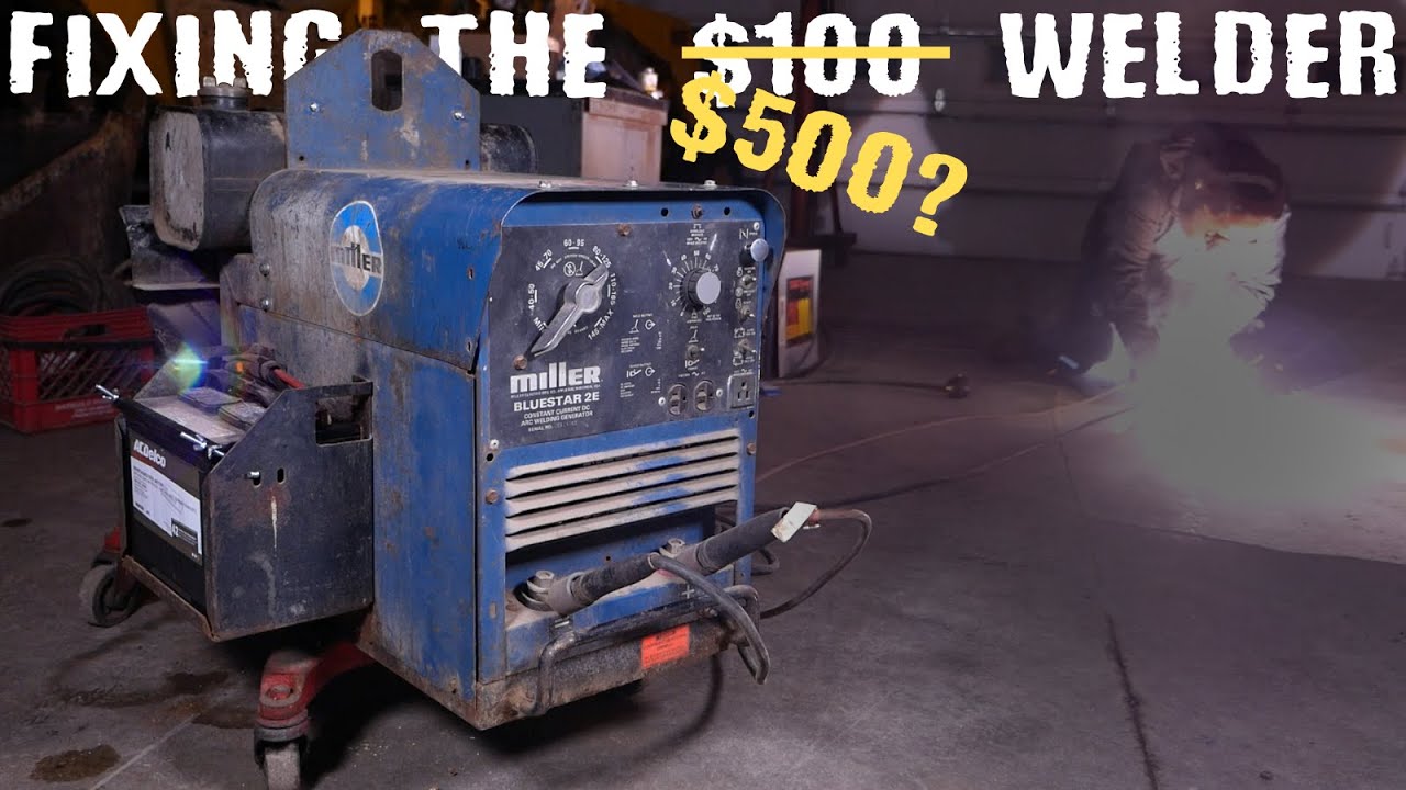

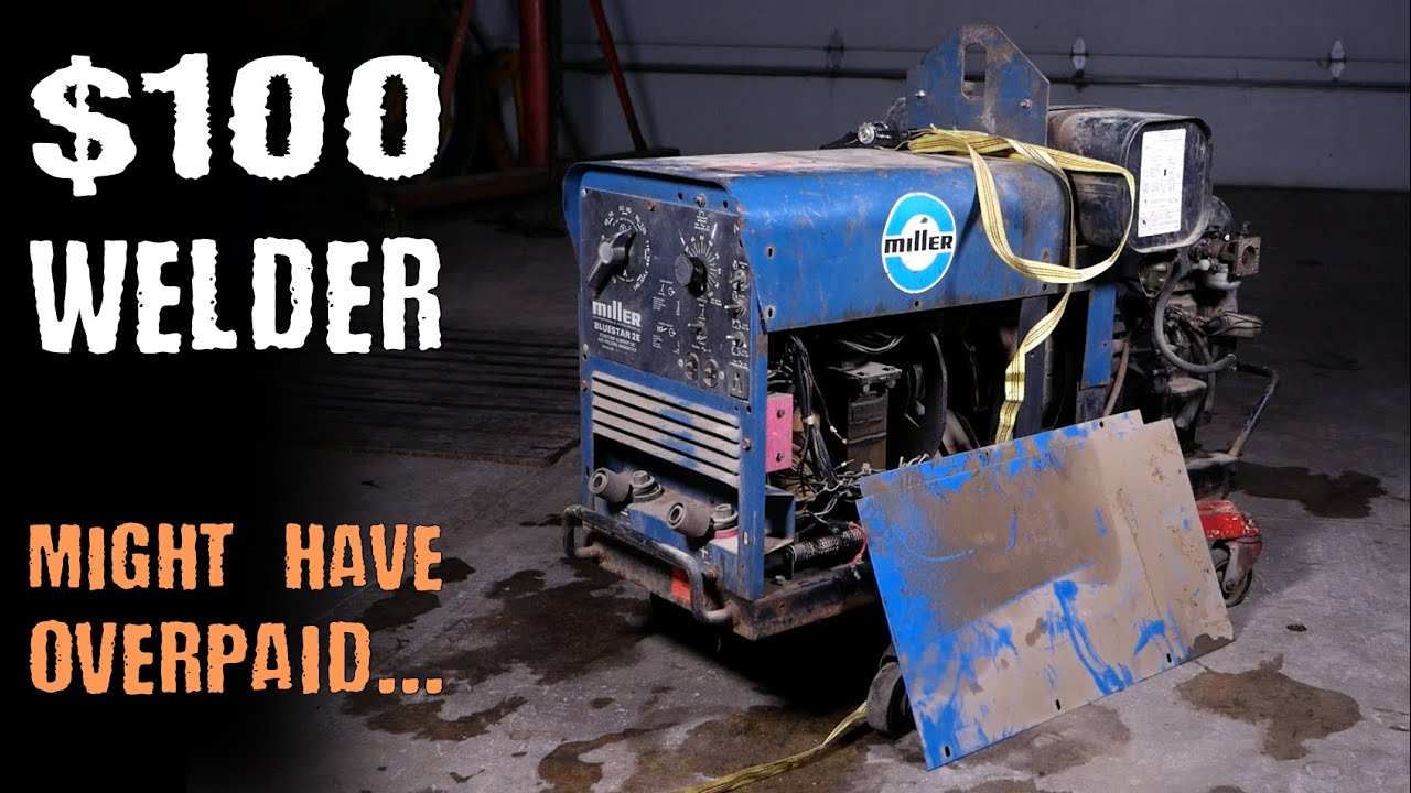

A couple guys here besides me mentioned owning these Miller welders. Two videos of a guy getting one to work.
As soon as I get my W2 from my old job, I might drop the hammer on a slip roll. Would be nice to be able to make my own cylinders and cones.
Tom, that is the exact welder I have
I remembered that you said that AL. One of the reasons I linked it here. The only problem with mine was that it would not kick down to a lower RPM when done welding. I took it to a repair place at one time but I paid for no result and being overwhelmed with work at the time I stuck it back in a shed and ignored it which was good because it didn’t get burned up with all my other stuff when my shop caught fire. He covered that problem in the video so I will drag it out and get it working again before I try and swap engines. Before Youtube I would have had no clue about how to fix a lot of stuff I have since brought back to life.
