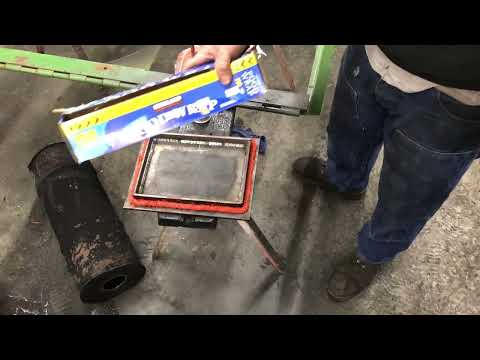

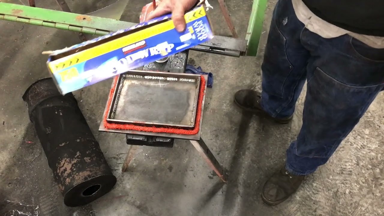

next video in my toyota rebuild series but im gonna stick it here since i have not seen a video on it just a couple guys describing it of how to make a stove rope silicone gasket. might sound simple, but might be a new guy that would like to see this
